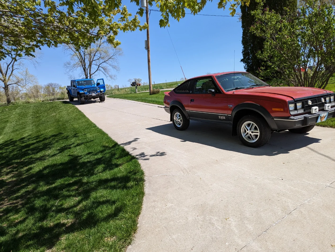

I did it before using a car at the bottom of my driveway, parking brake partially on and my JT at the top of the driveway. It allowed full unspooling, straight line, with a controlled load coming up a hill.
Good reminder!
Had a proper piece in the receiver, properly pinned, proper shackle, etc.
Driveway is about 120' long, almost all up a hill, so it works quite well.
