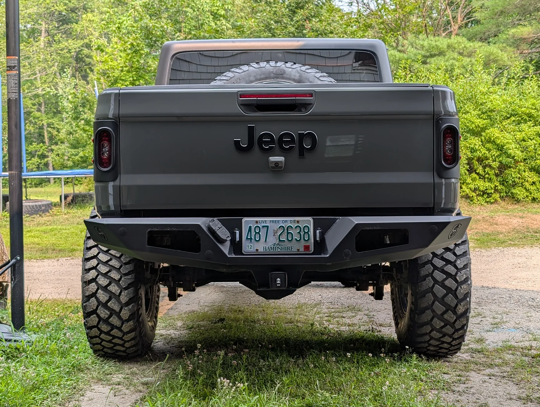

I put mine in the bed, I just didn't want all that weight hanging off the rear. Left a decently usable amount of space in the bed still. Rugged ridge.

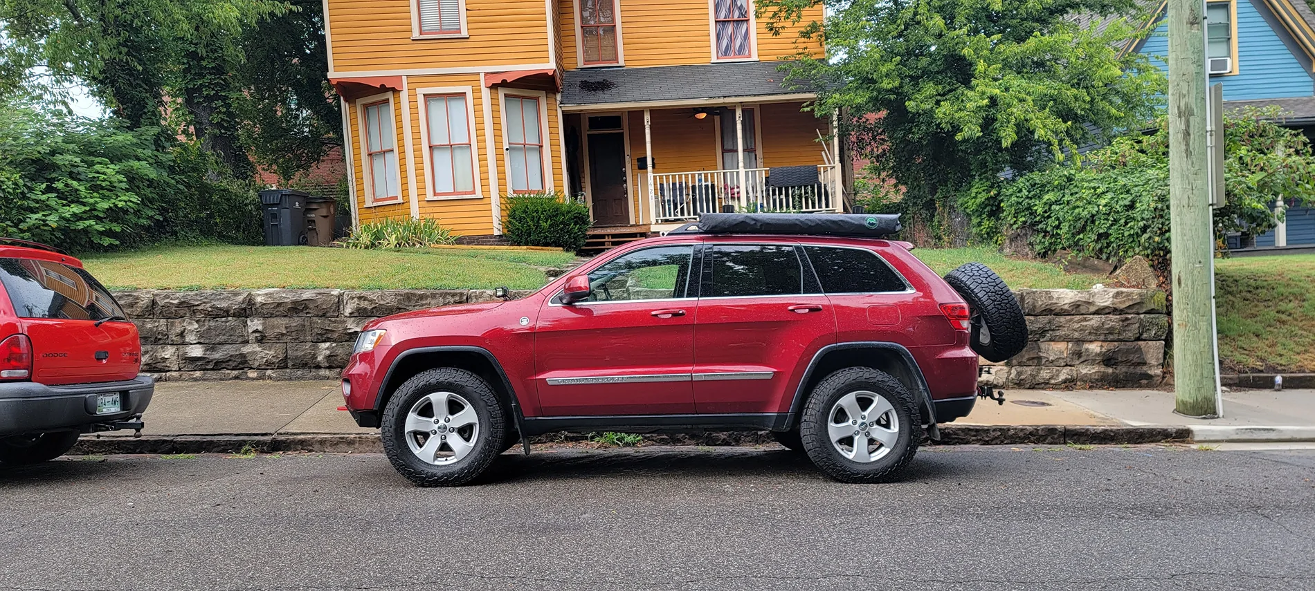

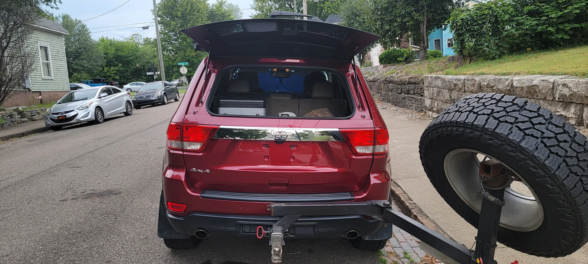

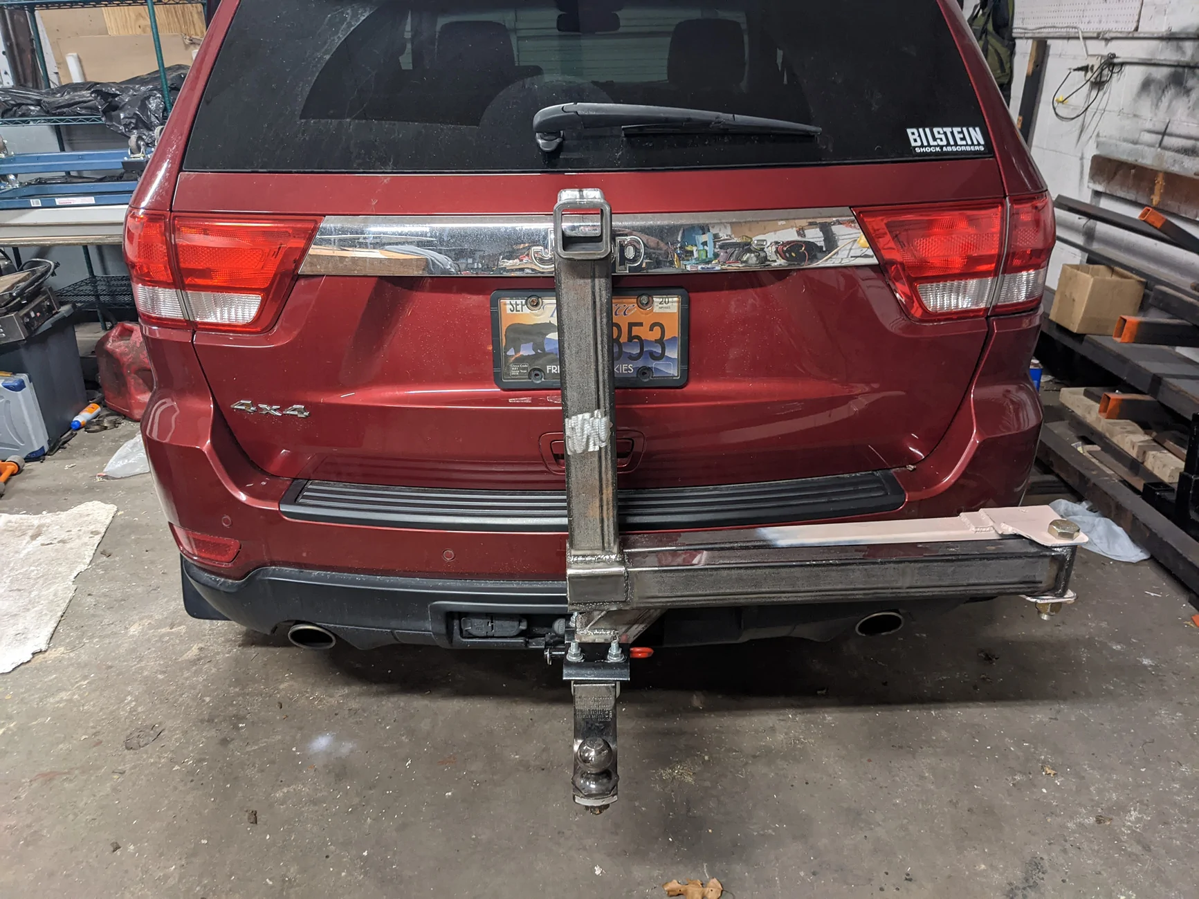

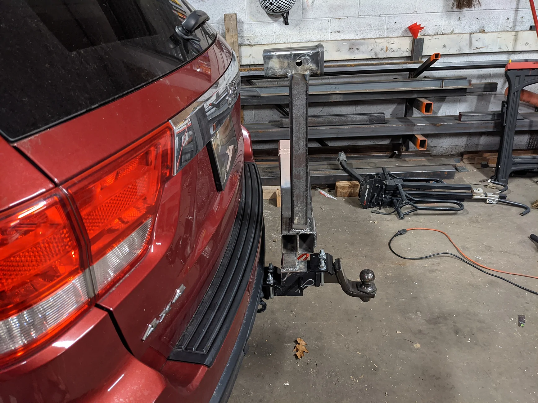

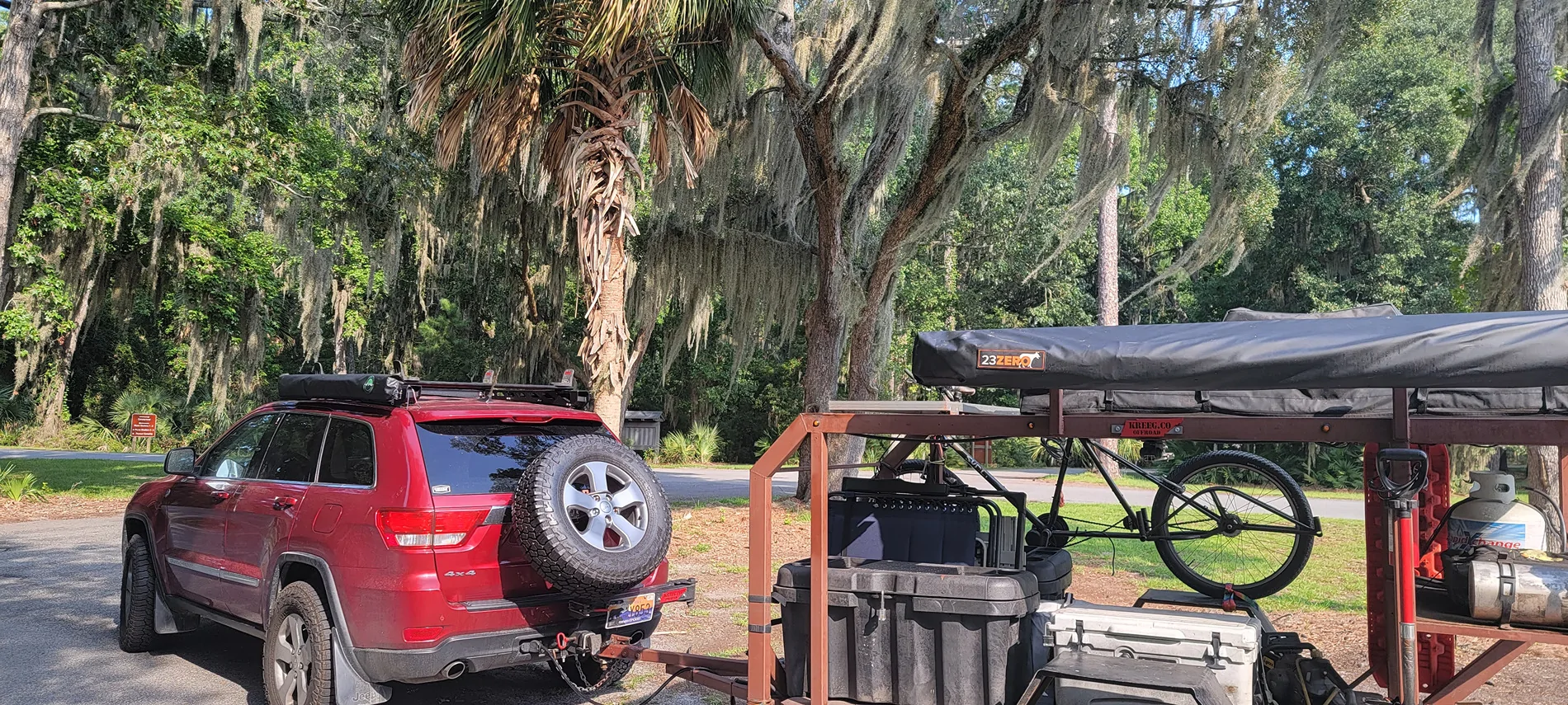

Not on the Gladiator, but I ended up just fabricating one utilizing the hitch on our Grand Cherokee years ago. I wanted to be able to also haul our offroad trailers, and I didn't trust the only aftermarket option I could find at the time, so out came the welder and some mild steel tube. It's still on there today, and has hauled trailers all over the country in about every environment possible while in a Grand Cherokee.
Love it, and that attaches to the factory hitch?
Yeah, it's essentially a hitch extender with extra bits welded to it. The hinge is just a 1" Grade 8 bolt in a bronze bushing from McMaster. No need for grease, no room for sand....mainly because I hated maintaining spindle type hinges on other projects. Double shear, of course. The rest is mostly 1/8" wall, 3"x2" mild steel tube, and an extra 2" receiver I had lying around. The part that holds the wheel itself is angled and adjustable so the tire sits nice and tucked away near the rear hatch.
Point being, other than a few minutes with a grinder and a cutoff wheel/flap disk, it's almost completely stuff you can just buy off the shelf from the local trailer supply and weld together. The word "fabricate" is being used pretty loosely in the initial post I suppose, lmao.
Other than a little looseness it has been just about perfect for its intended usage, which was to clean up the under cargo area space inside the Jeep for other things. The looseness was eventually solved with an anti-rattle device (can't recall the exact version) but I do recall having to look pretty hard for one that was worth a damn.

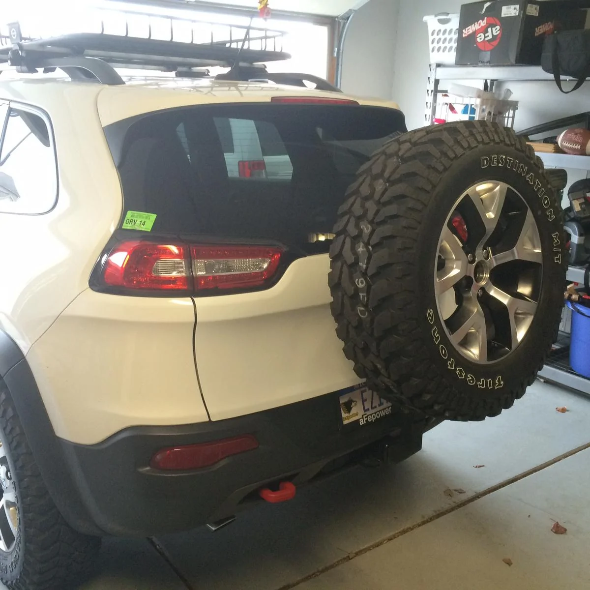

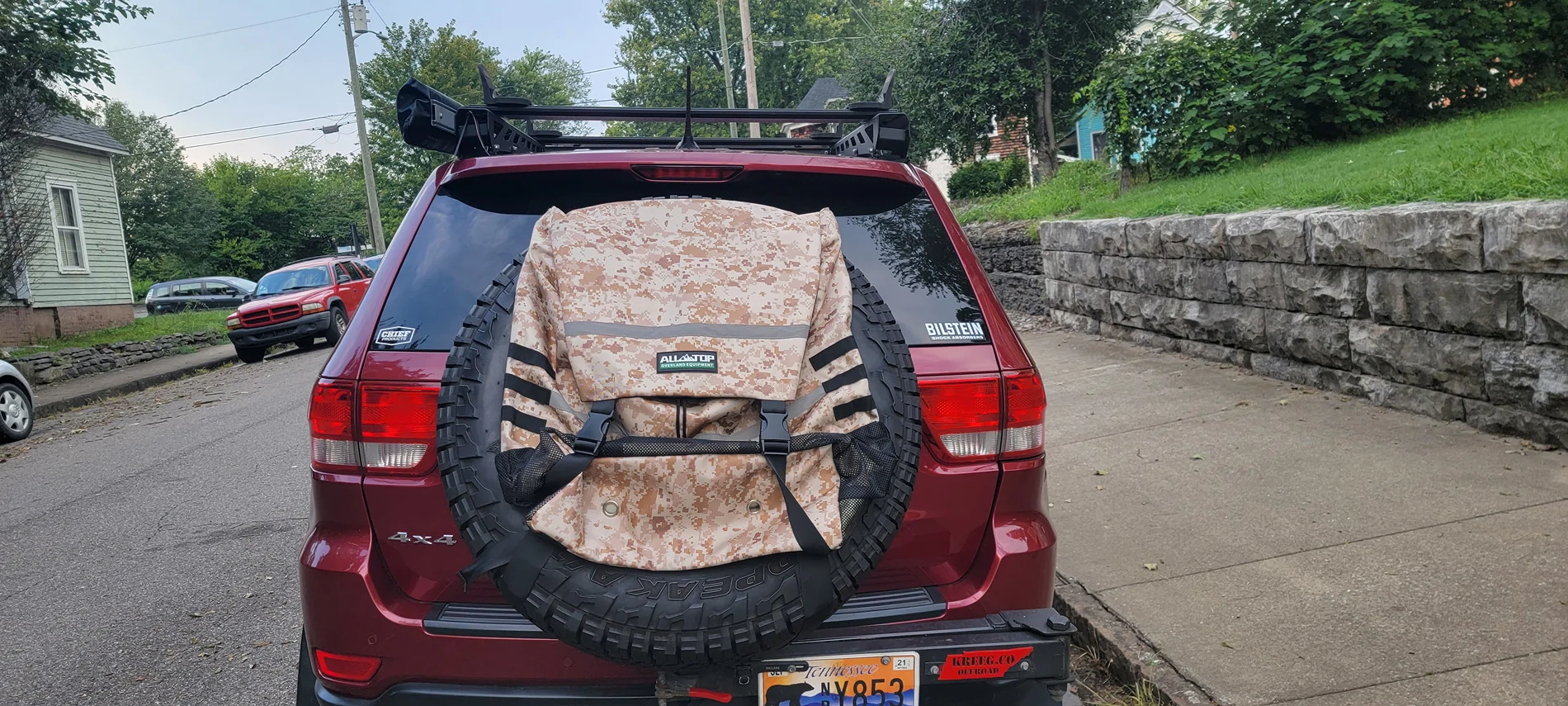

Very nice indeed. I like the angle to match the body lines.
I had done something similar on a 2014 Cherokee trailhawk way back when. Too big to fit in the spare tire well in the trunk. Too heavy of a tire and wheel to lift on and off the roof basket.
It wasn't by far the prettiest thing but it was functional. The 2x I towed a trailer a year, I just put the tire in the trunk

Yeah, I really liked the fold down design when I started the project, especially since our Grand Cherokee still had the flip up rear glass. I just couldn't figure out how to (safely) solve for also needing to haul the off-road trailers at the same time. I have been told that the one I ended up building looks great, but I'm not lying when I say it was designed with zero consideration for aesthetics. That was a straight up accident. I just wanted it to be indestructible.
