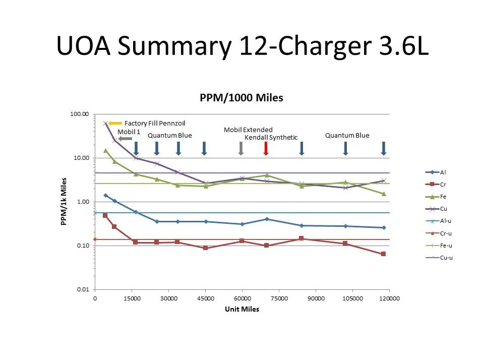

Picked mine up in Las Vegas and drove it to San Diego. Just about 300 miles exactly. Drove it through town off the lot, got some lunch, took a nice cruise partly down the strip. About 20 miles in took it on a dirt frontage road and and ran it through 4H and 4L as well. Drove it home real easy with the occasional acceleration. Never topping 70-stayed and in the right lane, which is actually quite a task on the 15. I bought an M6 and I could feel how tight everything was. Changed the oil at 1k. I know it is early, but I have owned a Pentastar before and did UOA to see how break-in went. The engine sheds metal for longer than you think, which is why I have done early oil changes when the vehicle is new, then let it stretch out. I have documented that oil can go 12-13k before showing signs of breakdown. I think it is OK to just do the changes when the indicator says so without worry. What I have noticed is that my mileage seems to be improving. When new I could get barely over 18 mpg. But after my long road trip between 2k and 4k miles, getting 20k plus is easy.
This chart as on log scale-so things like Iron and Copper went down to 1/10 their level when new and it was stable by 20k-30k miles. In general, this one is wearing at less than the universal average for that engine. This car is still running at 250k+ miles. I was using a custom oil to test out if it really was better. You can see I switched out to a couple commercial oils and wear went up, but came back down when I switched back. I am not interested in oil discussions, but the main point here is that a Pentastar is just breaking in at 20-30k and can give you a long service life, which is why I am happy with it in my JT.

Thanks for the detailed info, i greatly appreciate it.
