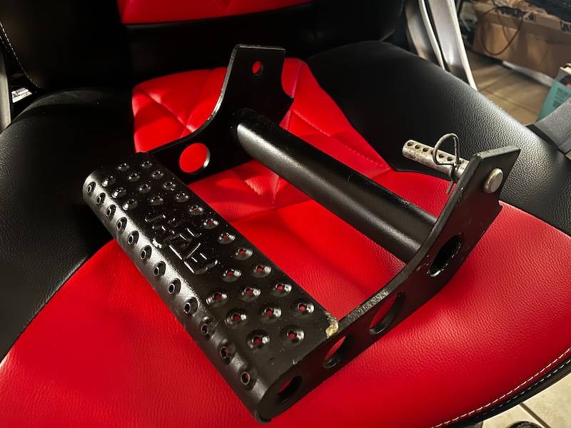

Have not done it... but it is on its way...
To make it easier for my wife and my father-in-law to get in... I was looking for steps alternatives.
Started looking for anything that would work with the stock rock rails and still be able to remove them easy... the only ones that I liked were expensive as heck... These... but that was 500.00 a pair and I needed 2 sets ! No way I was going to spend US$1,000.00 just in four steps...
I was then going to adapt N-Fab RKR steps to the stock rails but decided just to get the rails for those... N-Fab RKR rails... And plan to secure the steps with pins instead of bolts, for easy removal when not needed...

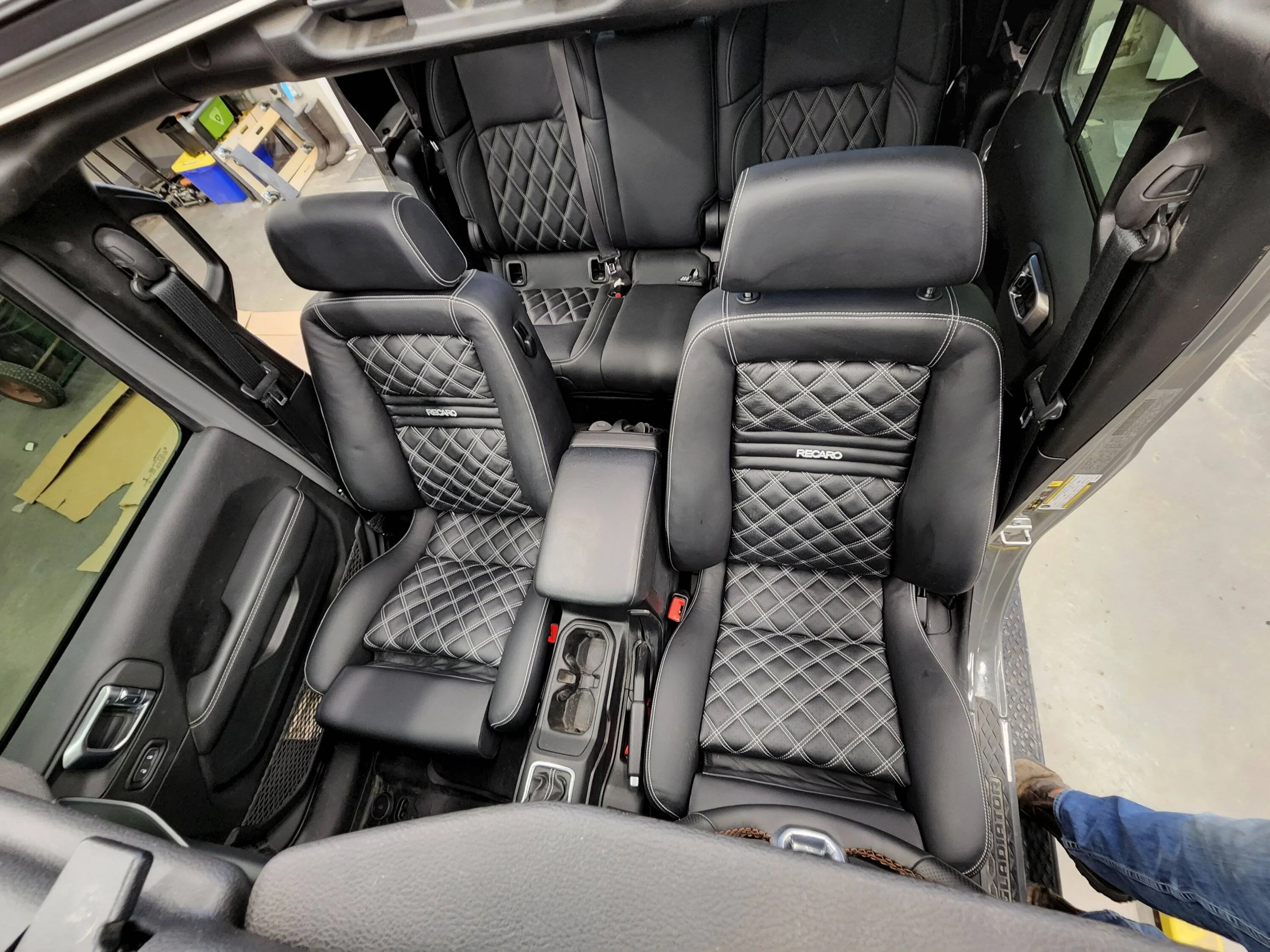

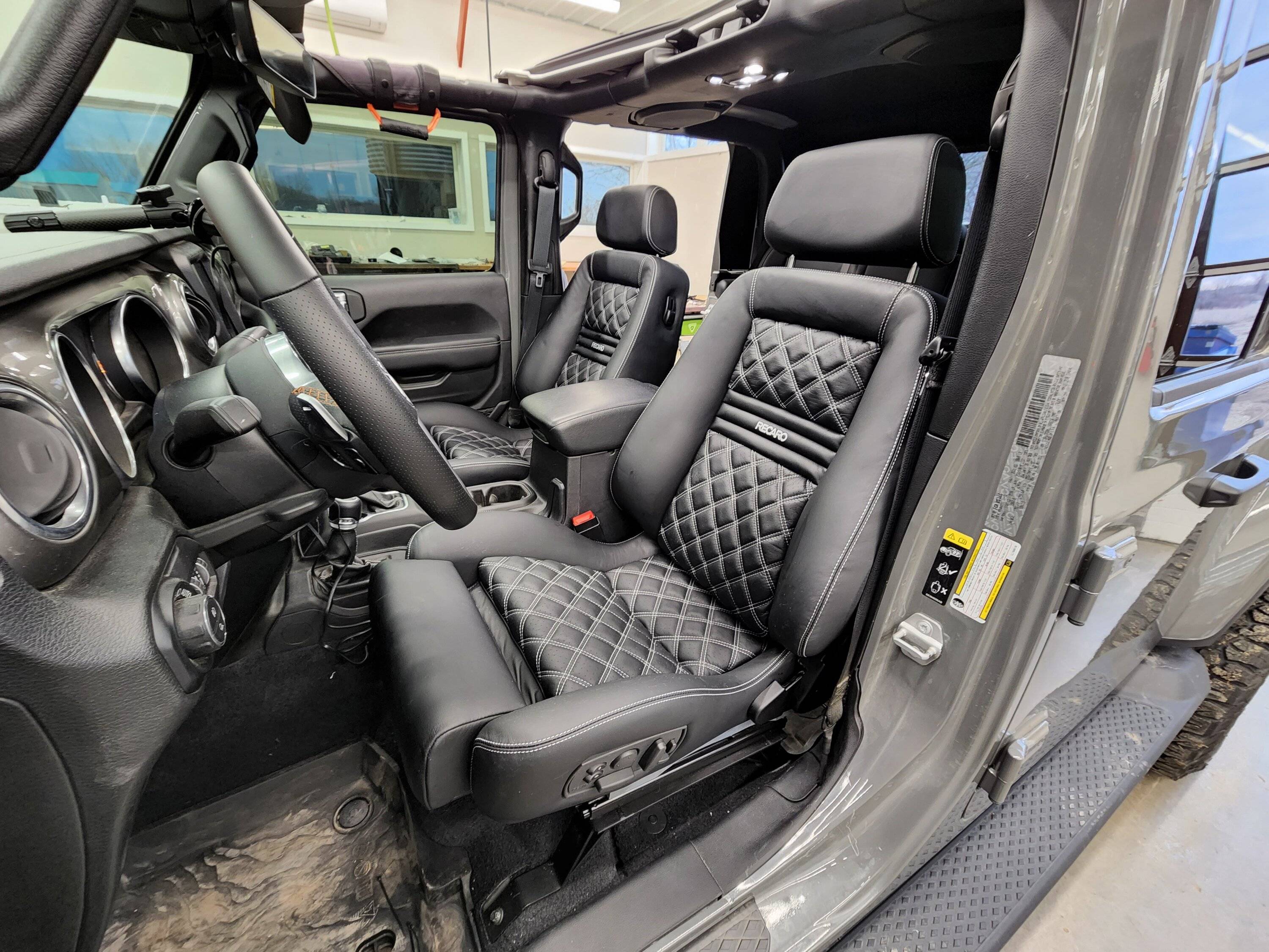

I installed the Recaro Ergomed ES SAB seats, for the car people they were factory fit in the Audi D2 S8.
Airbag wiring was easy. I installed factory connectors and plugged them in. They require a power source for the tilt, recline, and power bolsters. I refit factory seat heating pads because the Recaro units weren't the right resistance.
They were expensive but man do they change the Jeep. Recaro does not distribute the seats to the US, you need to source them from Europe. If you are lucky you might find refurbished units. I bought them refurbished and had them upholstered to my spec.
These photos are from my first Gladiator, I have since swapped them to my second.

Here is a link with a pretty good price: 4,300 EUR ea.
You can get the same seat in the US without the side airbag for about ~$700 less, each. I didn't want to fool around with safety. I figure $700 is cheap insurance to reduce risk.
The seats do not work with the factory rails. I used Wedge brackets and had them customize the brackets by lowering the front by 1" and the rear by 1.5"
