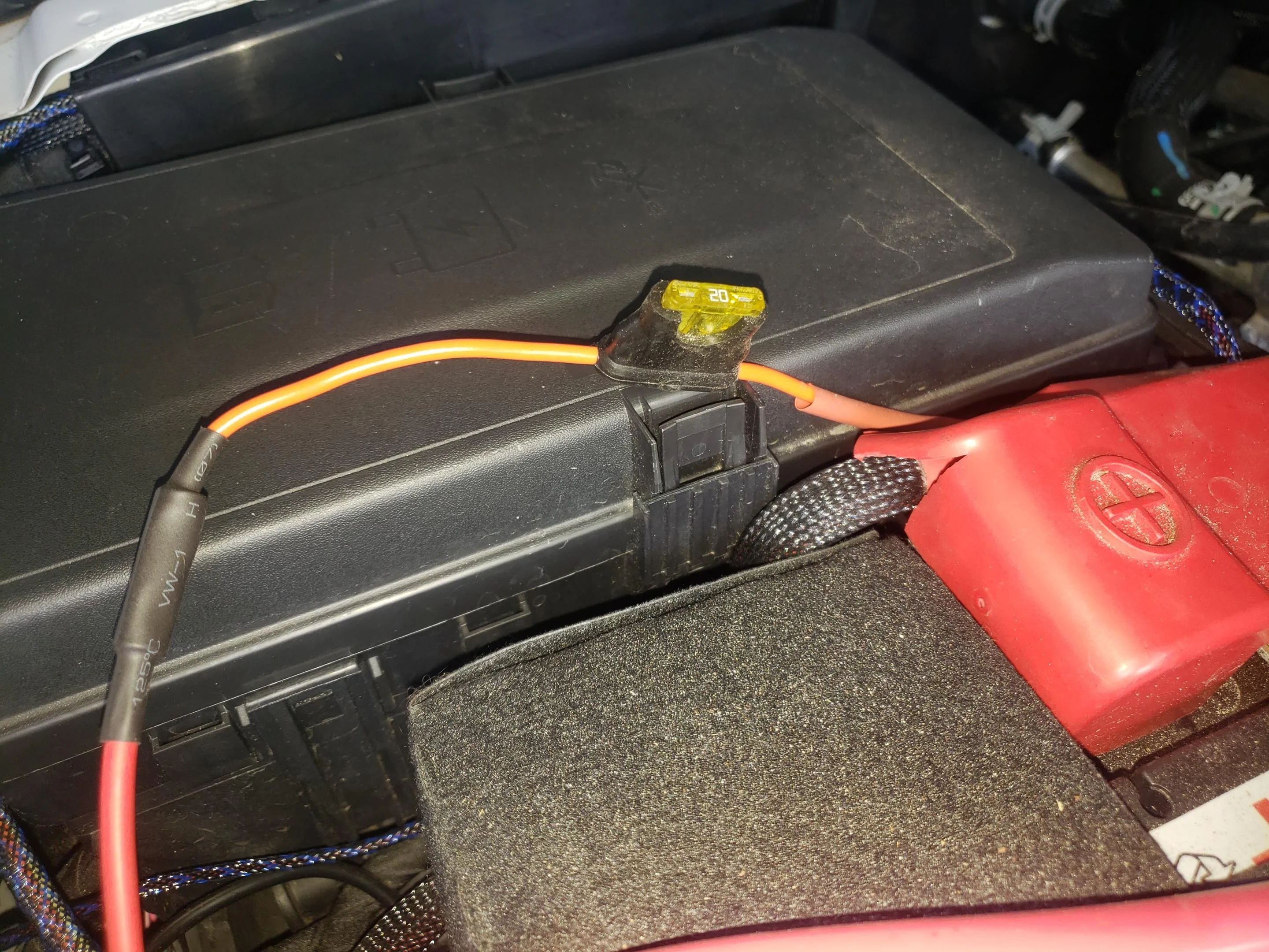

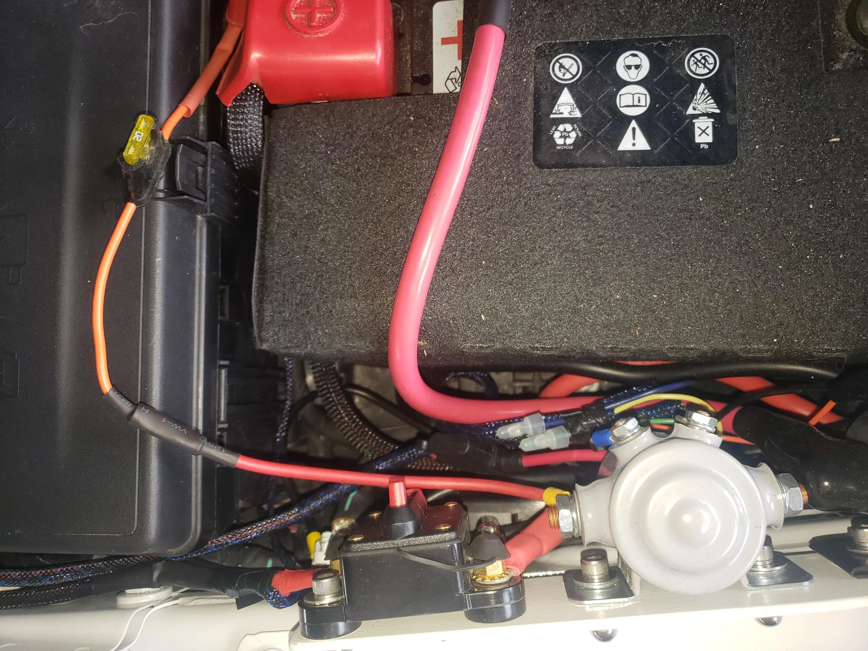

Don't mean to butt in, I installed 12v power in the bed just like the way you are looking at. The exception is that I have it connected to the aftermarket aux switches. So even with the truck on, I have control of the 12v power in the bed. The in-line fuse holder I chose was 30amp. I just put a 20amp fuse in it. The wire is not marked on the fuse holder. The kit that I ran to the bed came with an 8ga wire.
I'm planning on eventually going to a Voswitch setup but not yet, so for now it will likely go directly to the battery using an inline fuse. Do you know where you got yours? I'm struggling to find an inline fuse with a decent gauge wire. I do have the ARB wiring kit in my Amazon list, but I think I'll be going with a flush mount plug as I'm just concerned about knocking the ARB plug around while moving stuff in and out of the bed.

Advanced auto sells the 30a in-line fuse holder that I used. It shows it to be 12g. I found an in-line fuse holder on Amazon with a 10g wire.

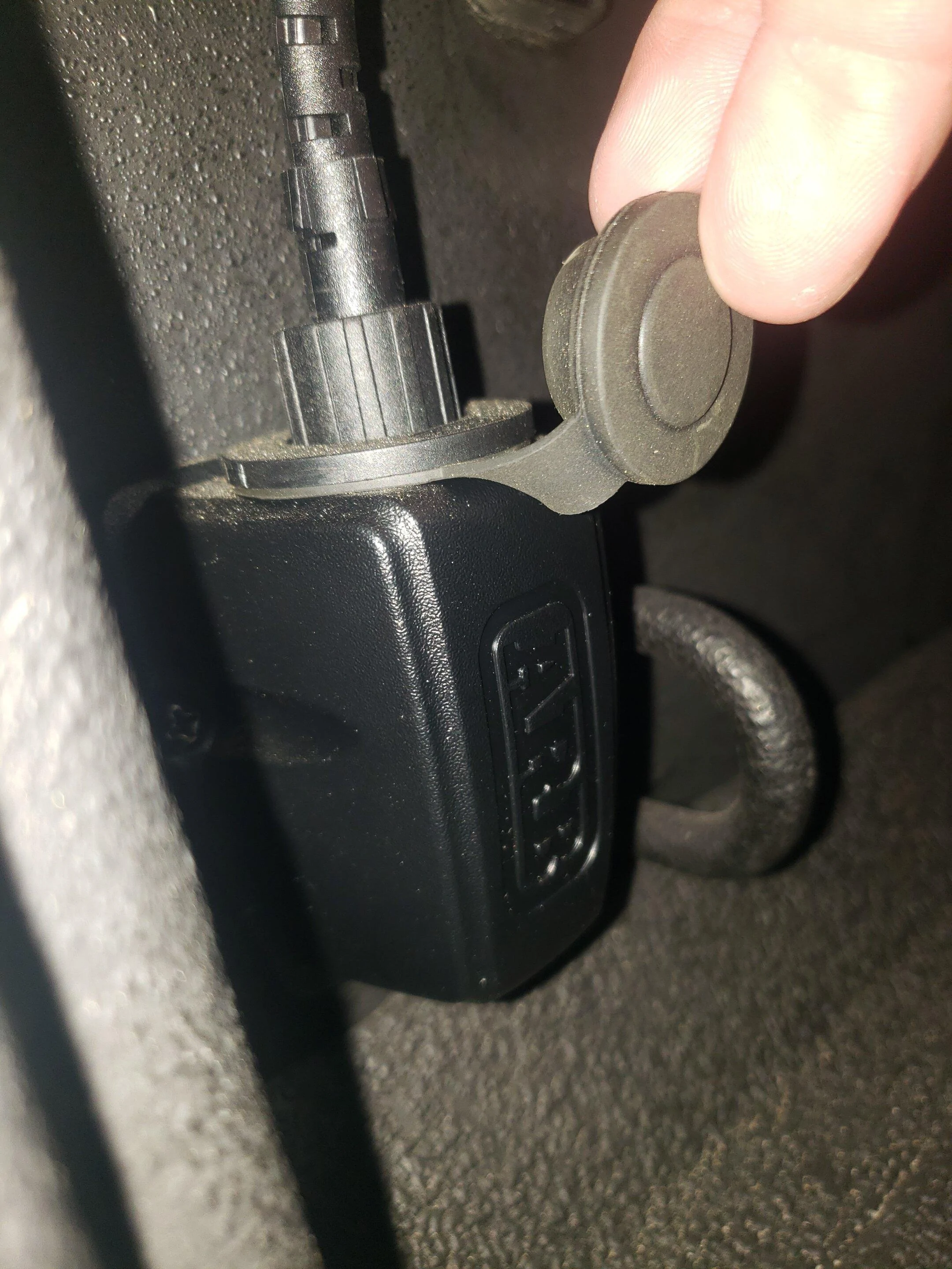

I just took a look at my bed and I see where you mounted that. It seems pretty protected. I may just end up getting the ARB one as the outlet and wiring are all in one set and the eyelets and inline fuse are already connected. Is the electrical connection for the ARB on the side mounted to the bed? I see there is a hole in the bed that would help for getting the wire through.

Yes. The ARB plug screws in, so there is no worry about it coming unplugged when traveling. It comes with the traditional plug for 12v sockets too.

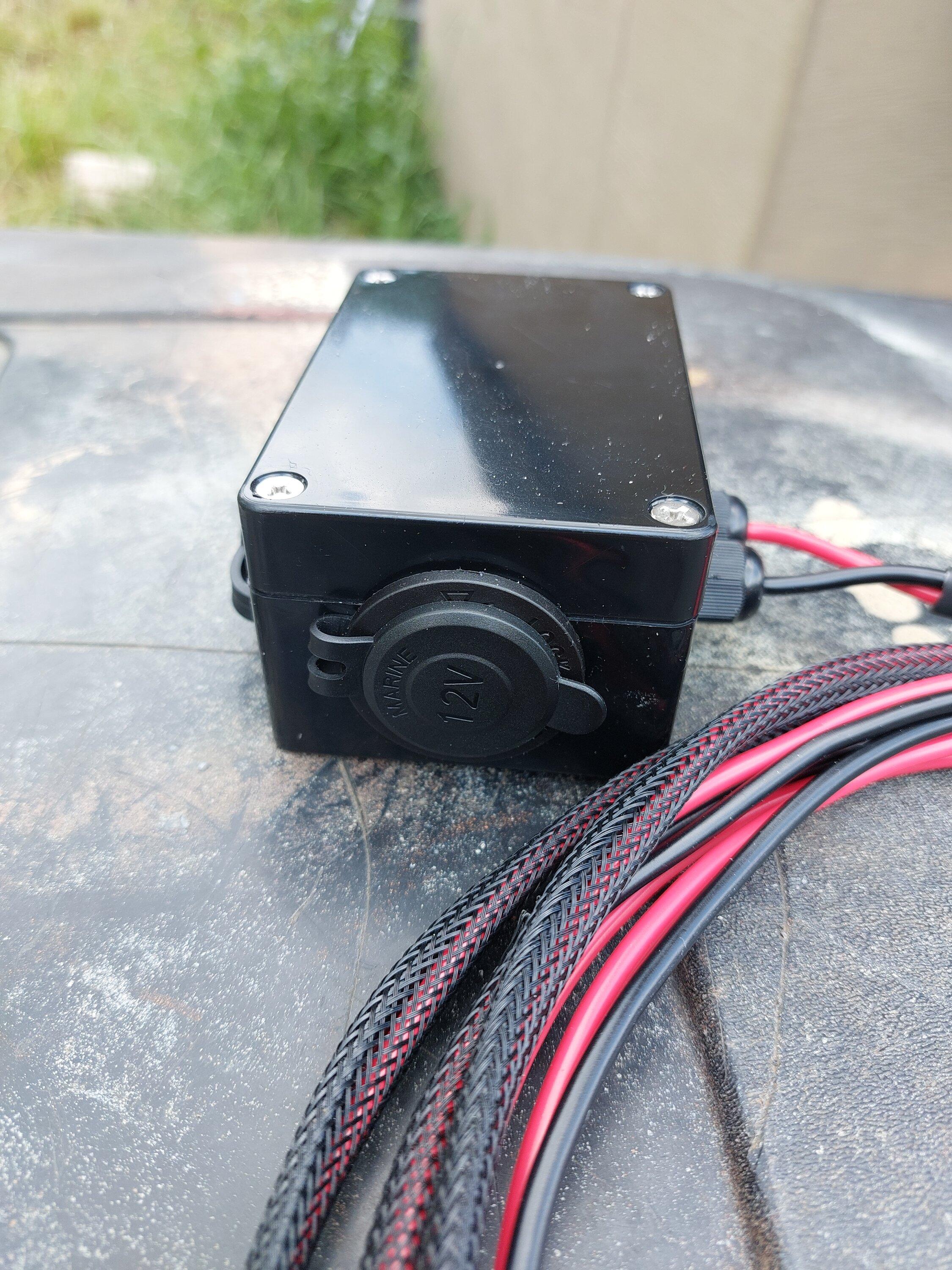

Does the wiring come with a normal 12V socket? Somewhere I read that it wasn't, that it was just a special plug for the ARB fridge? Dunno, and it didn't seem to make sense but I thought that's what I read. I need a standard 12V socket back in the bed for all sorts of stuff, but not an ARB fridge,. I just liked their wiring package.

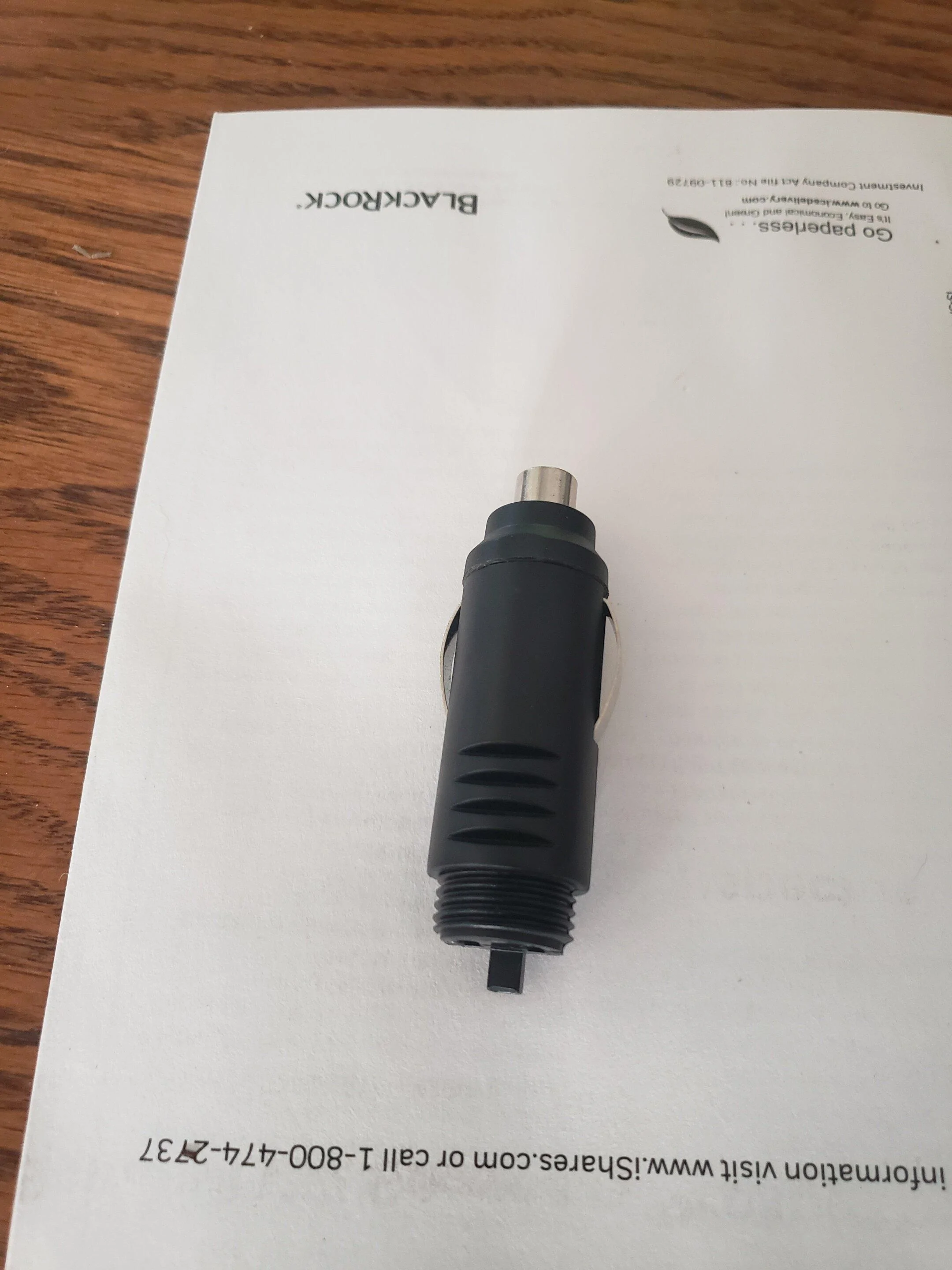

I may have to refresh my memory. I will check when I get home. This is plug that I bought with my socket. It was a separate purchase. It has the standard end for a 12v powerport that screws off for the ARB socket. The ARB freezer came with one but was too short to work when the slide is pulled out.

I looked again. The ARB socket is only threaded and has 2 prongs. The picture here is the ARB freezer extension plug. The normal 12v plug screws off and the extension threads into the socket. I know now that this is not what you wanted to here. I'm sure there are plenty options out there.
Thanks, you confirmed what I thought was the case. And yes, I've seen similar sockets like the ARB that are 12v standard opening, so I'll head down that road. I may still do something in that small square panel on the passenger side, not sure yet. I may end up using the ARB wiring since for me it's complete except for the actual socket, but like I said, I can find those. Thanks for your help!
