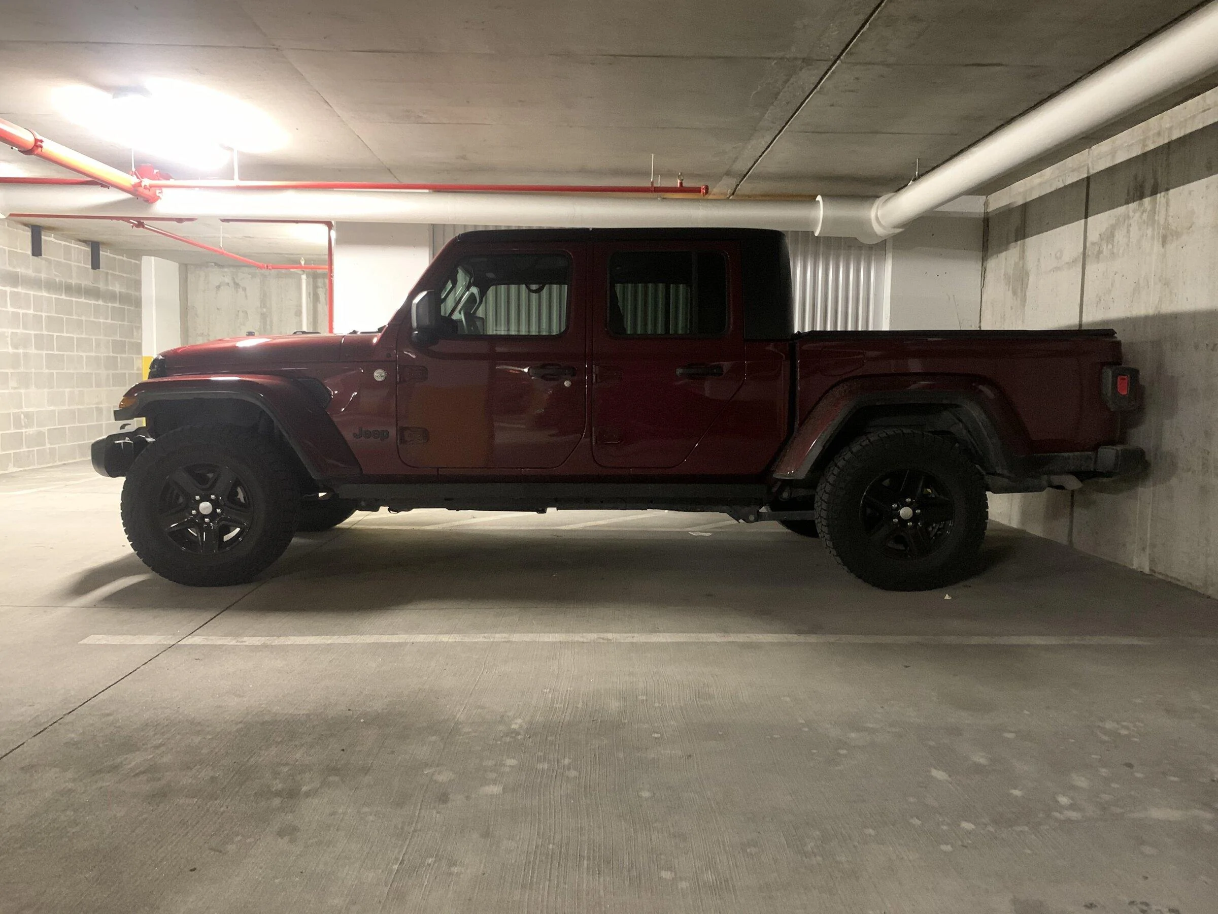

2021 Jeep Gladiator Sport S
If you just want to go 33’s you don’t need the leveling kit. Heres my sport s with 33’s. I do plan on getting the 1.5” leveling kit too just to level out the front end.

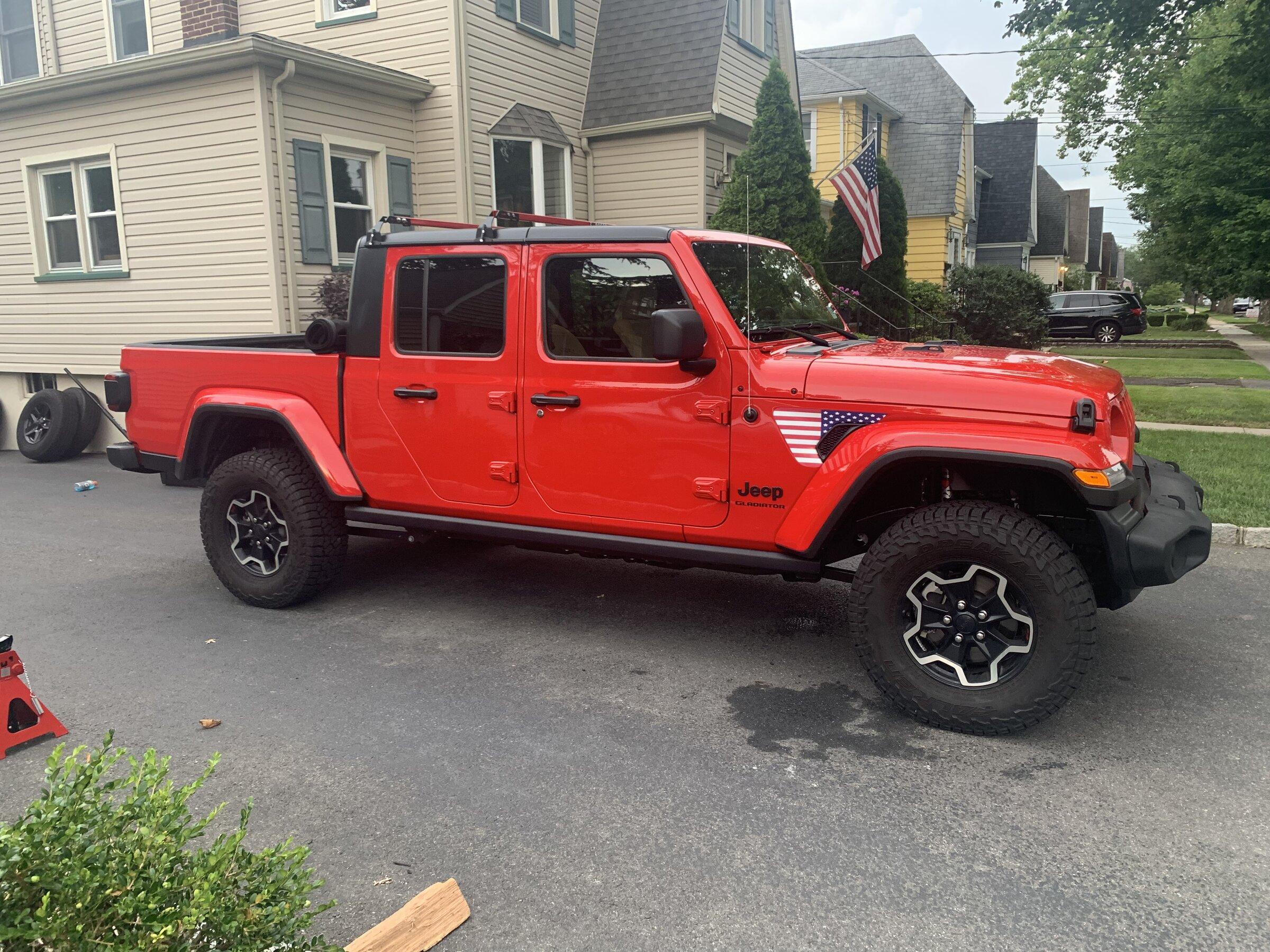

2021 Gladiator Sport S 6-speed
Sport S, 33 inch rubicon tires, rubicon springs, 1.5 inch teraflex spacers up front & .75 daystar spacers in the back.

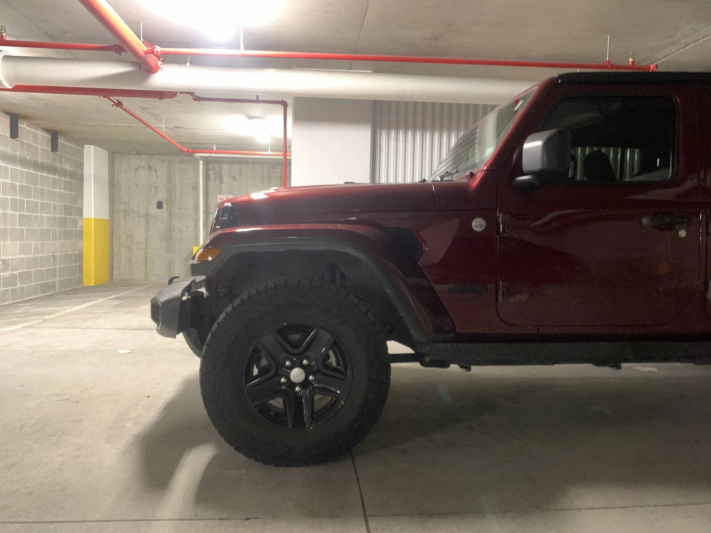

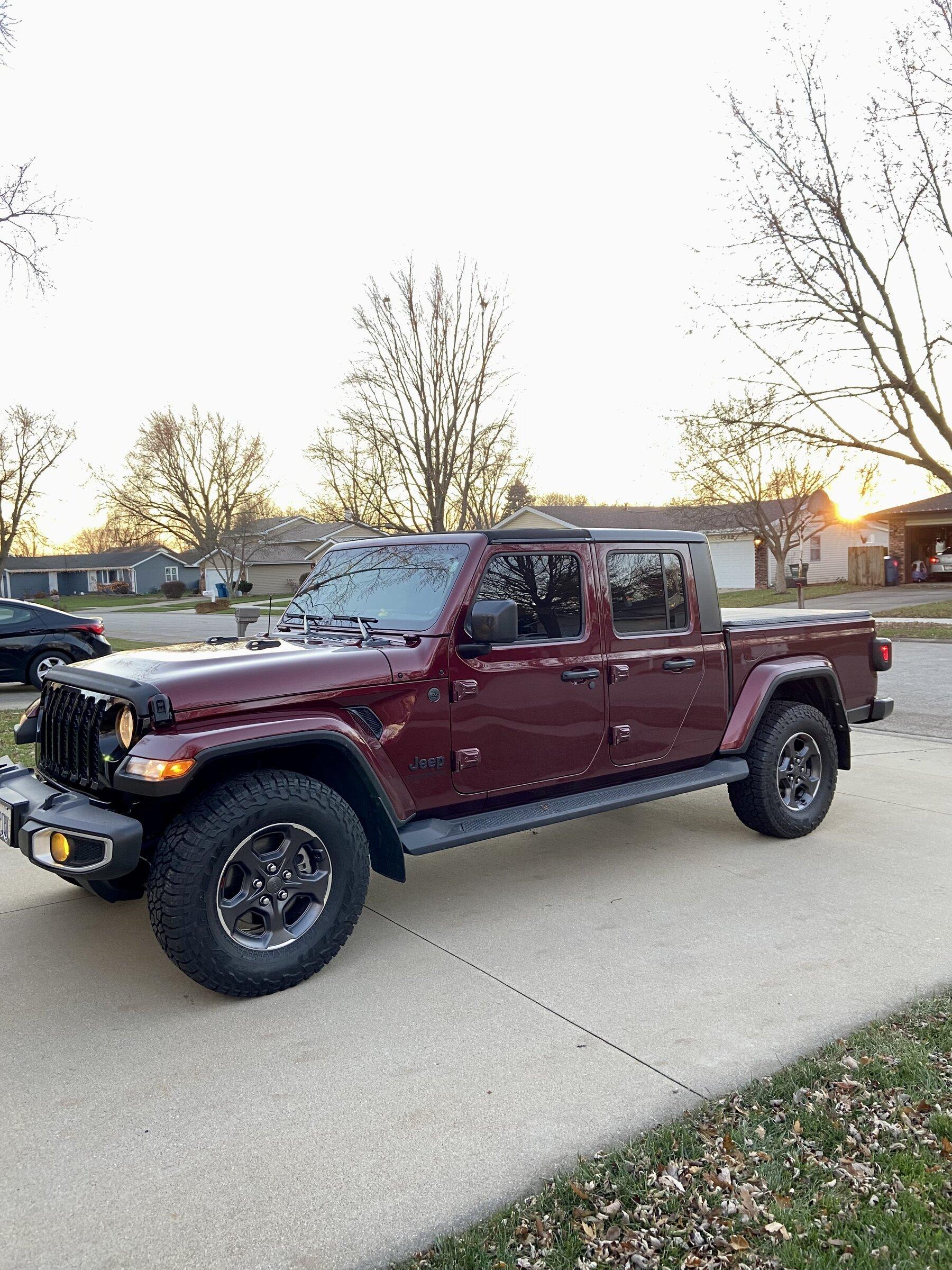

Ghost Rider
Here’s my Sport S w/ Max Tow on 33s and Teraflex 1.5” level kit. I’d say if you’re already interested in 35s then go for that now rather than later.
