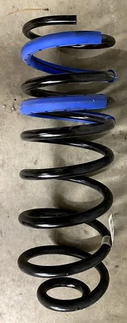

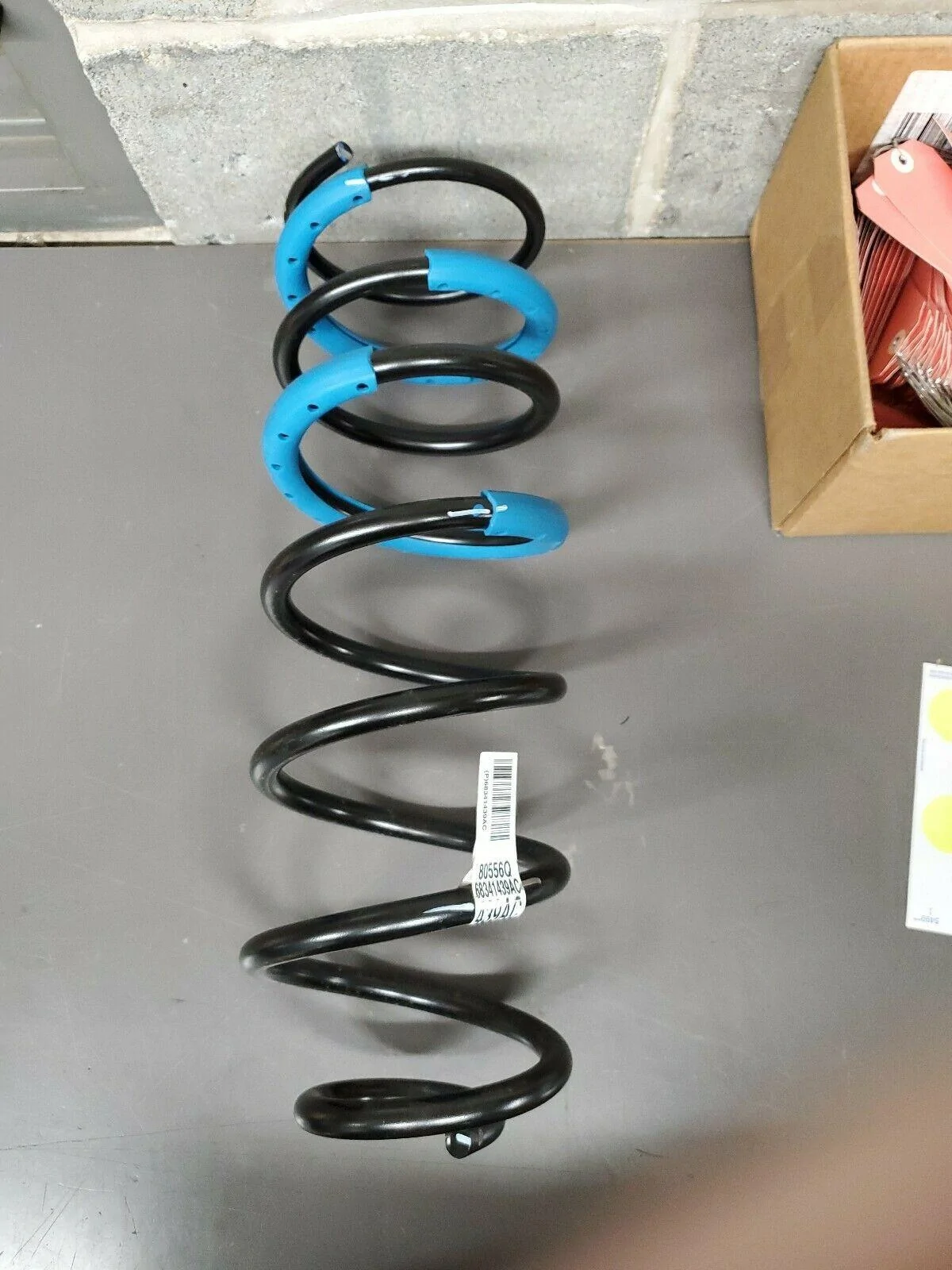

Its common knowledge that the Max Tow Rear springs are progressive. Here are some pictures for you. Count the number of coils & look at the spacing.
OEM non Max Tow Take off's (image stolen from an ebay auction)
And this is one of my OEM Max tow springs sitting in my garrage.
The difference in springs does not come with the Max Tow, they are listed on my sticker as part of the S package. According to my sticker my max tow has Normal Duty Plus Suspension which is listed as being part of the S package. I would assume that the base sport has just has normal duty suspension not the plus but it does not mention the suspension for the base model.

Just like the progressive springs to handle that extra load.
progressive springs don’t handle the extra load. The standard spring spacing Handles the same load. The tighter spacing that’s in the progressive springs gives it a bit of a soft ride. that’s why the max tow or the sport s, which ever one has progressive springs, is a nicer ride.
the more horizontal the coil, the softer it is, the more vertical and spaced out the coil, the harder it is. This doesn’t account for coil thickness though. That will also effect how easy the spring compresses.

So I don’t know if you were trying to explain the science behind it, but progressive rate springs are indeed used for the heavier load.

“The difference in springs does not come with the Max Tow, they are listed on my sticker as part of the S package. According to my sticker my max tow has Normal Duty Plus Suspension which is listed as being part of the S package...”
The Sport S pckage springs bdnshocks are different parts, each with there own part number, same with the shocks. I had my dealer parts person look this up, when I ordered the MaxTow springs for my Soet S. The MaxTow springs were physically longer than the Sport S springs on my Sport S sticker listed heavy duty suspension springs. The ride is also a little different, when driving the Spirt S without a load. Also, the MaxTow springs kept the back of my Soirt S from dropping more than an 1-inch with a heavy fire wood load. The same load with the stock Sport S springs, the rear dropped about 2-inches.
He Soirt S has heavy duty springs, the MaxTow sori gs are progressive, giving a softer ride unloaded and then they get stiffer as weight is added, providing more support to the truck suspension.

So what I said is still correct. The spring gets stiffer as it’s coil gets more vertical. A progressive spring is used to handle heavier loads because if they used a linear spring it would be very stiff, when there is no load. It’s progressive so it has some give when there is no load in the back.
If you look at the two coils photographed in this thread, the stock one only has one less coil. The extra coil in the progressive spring will give that section of progression a lower spring rate, making it softer.
I can’t tell from the photos, but if the progressive coil is thicker, then it will be a stiffer spring. But being a progressive spring doesn’t mean it’s stiffer or can handle more load, it just means it isn’t linear.

Yes, the MT progressive coil is a little thicker.
