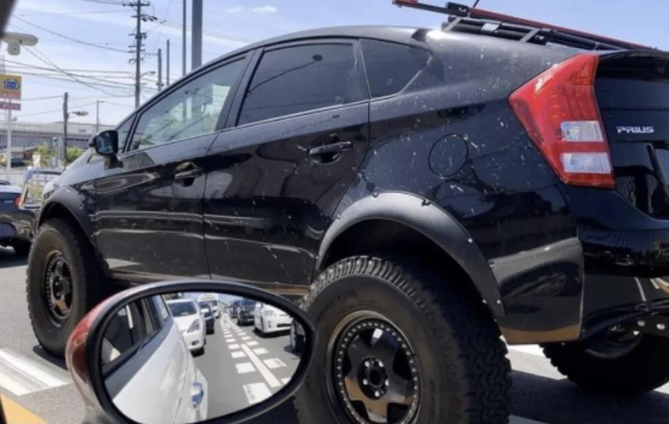

I'd LOVE to see a Prius do some of the trails these can take - or even pull a 27' camper....... or haul 6 sheets of 3/4" plywood or a load of firewood. If anyone has pics of that, I'm interested.
oh yea?
