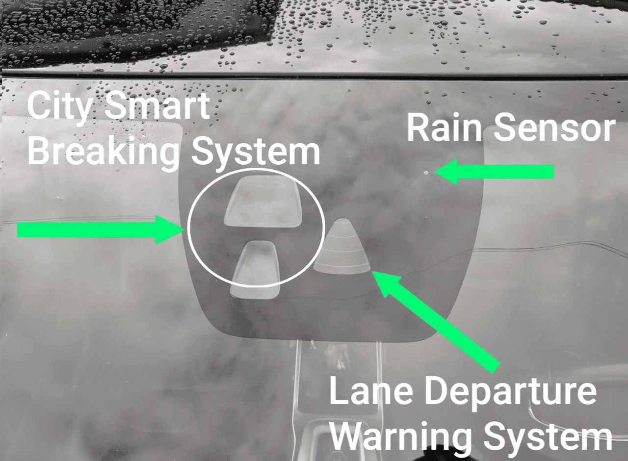

Windshields do indeed have sensors attached to them unlike the jeep:
Jeep Gladiator Questions about the stereo and adaptive cruise. 1682020902122
Those sensors above are integral to the windshield and do not stay with the vehicle when you replace the screen unlike on the wrangler. This is why regular cars with active safety features need to be recalibrated.
The gladiator and wrangler do not need to be recalibrated because the system is not attached to the windshield. If you had to recalibrate it every time you changed the glass you'd also need to recalibrate it every time you lowered and raised the windshield.
