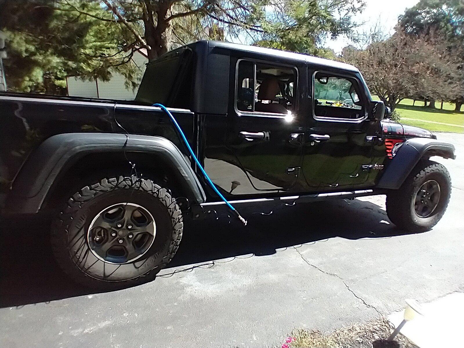

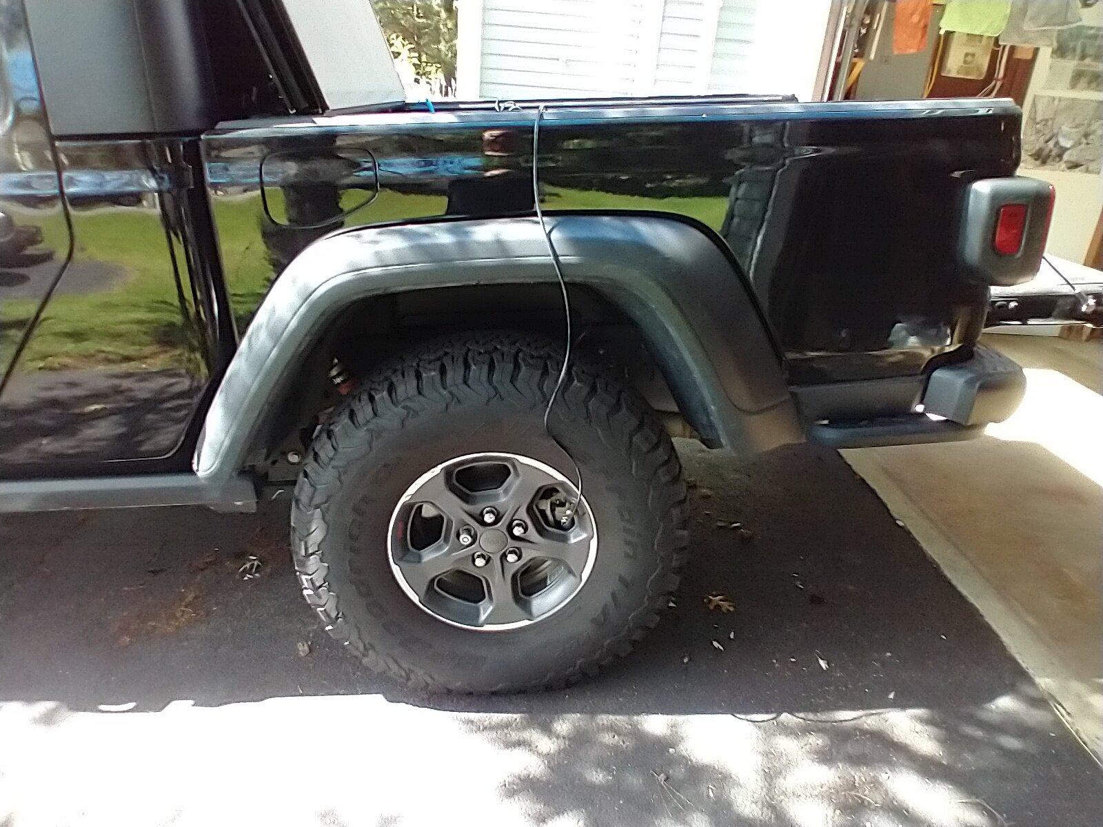

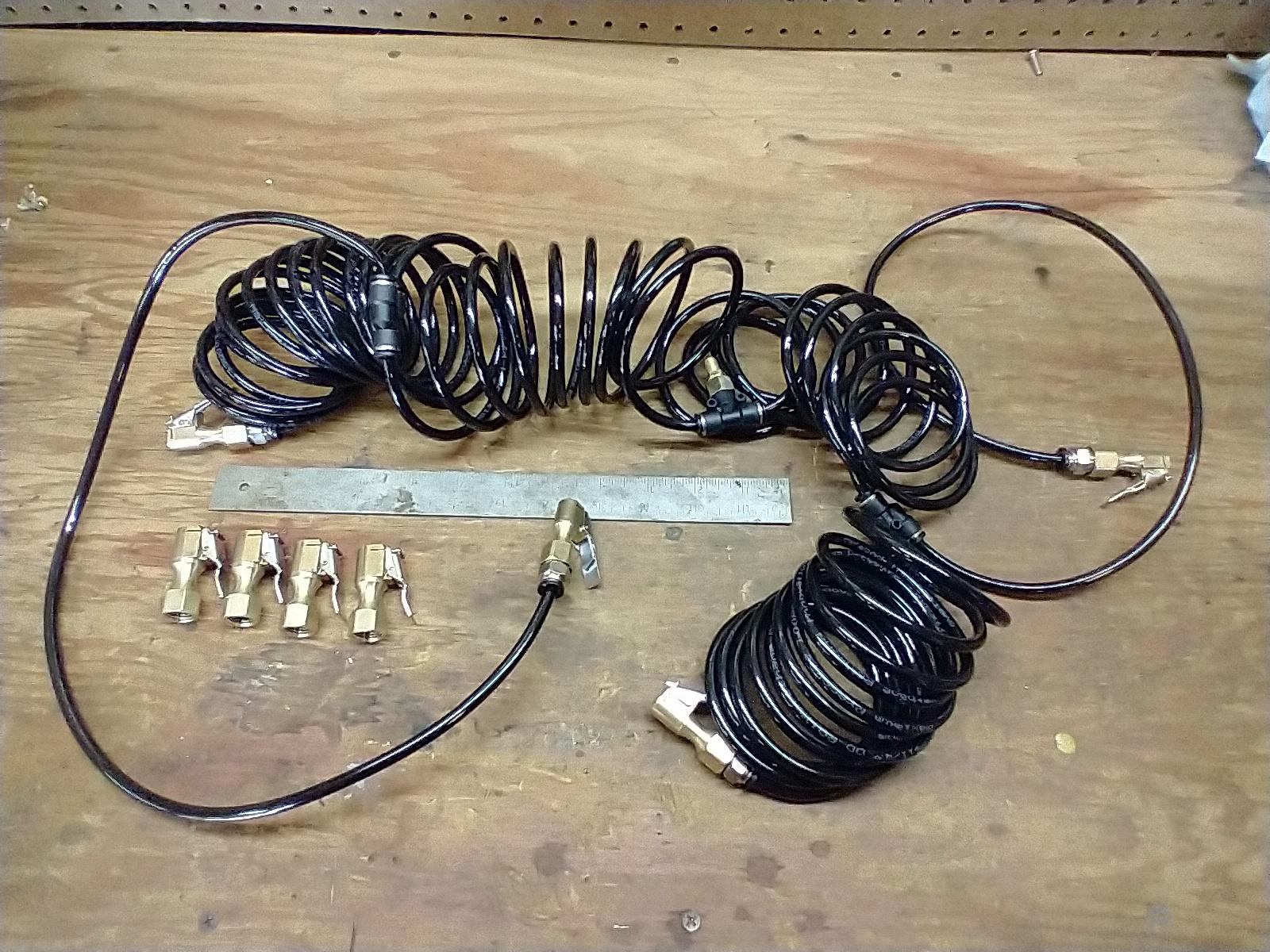

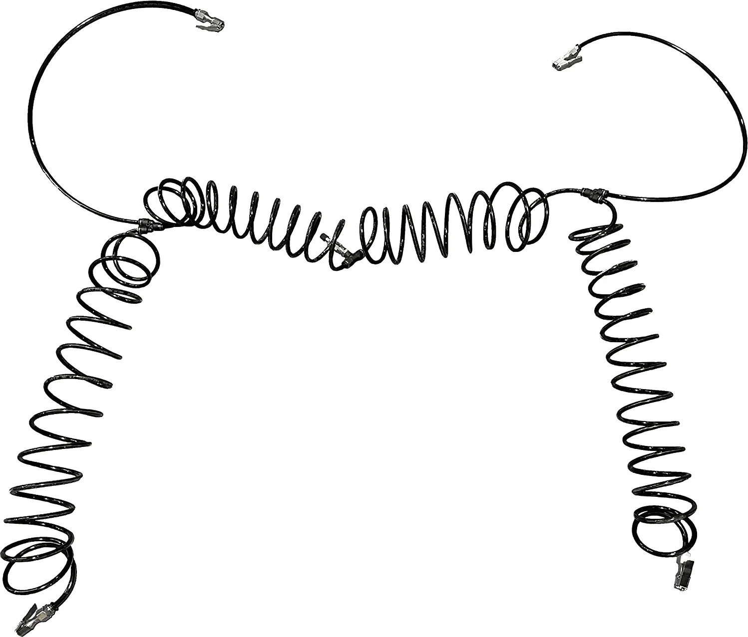

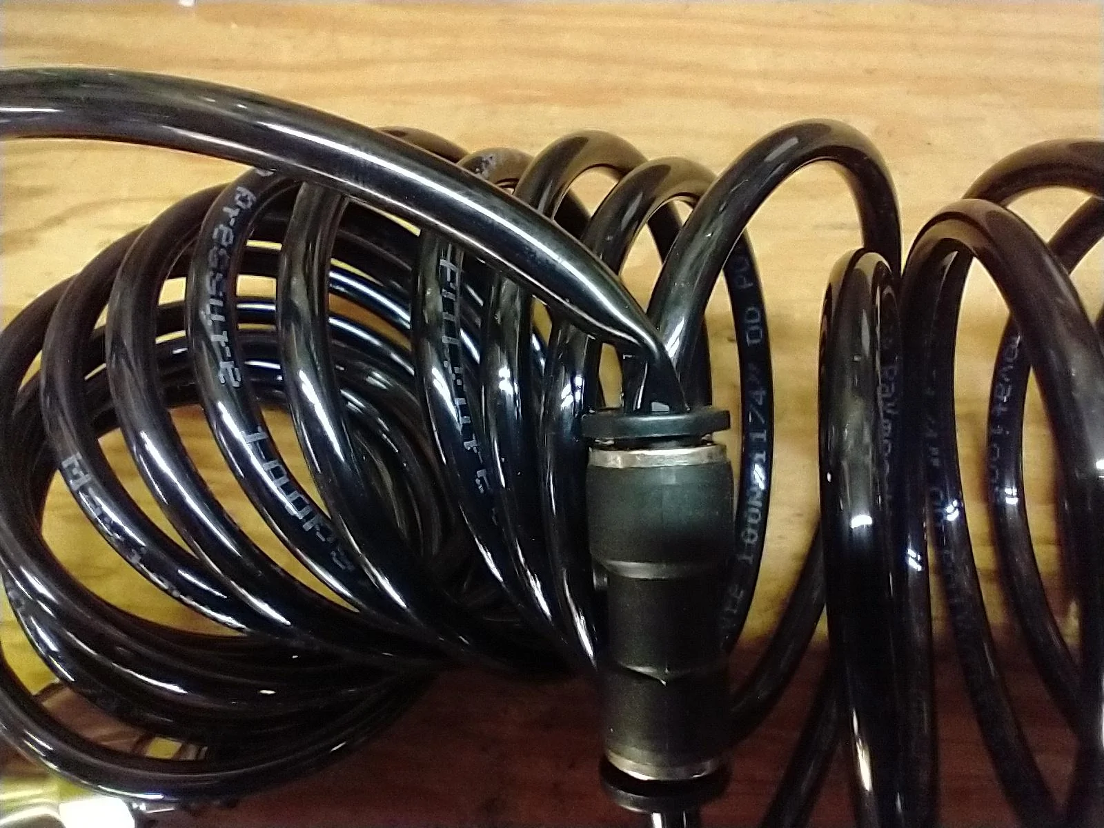

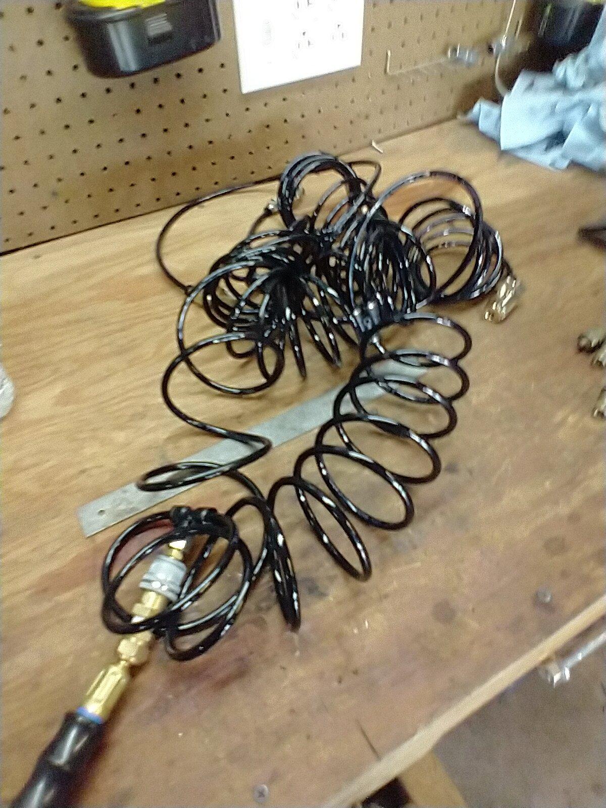

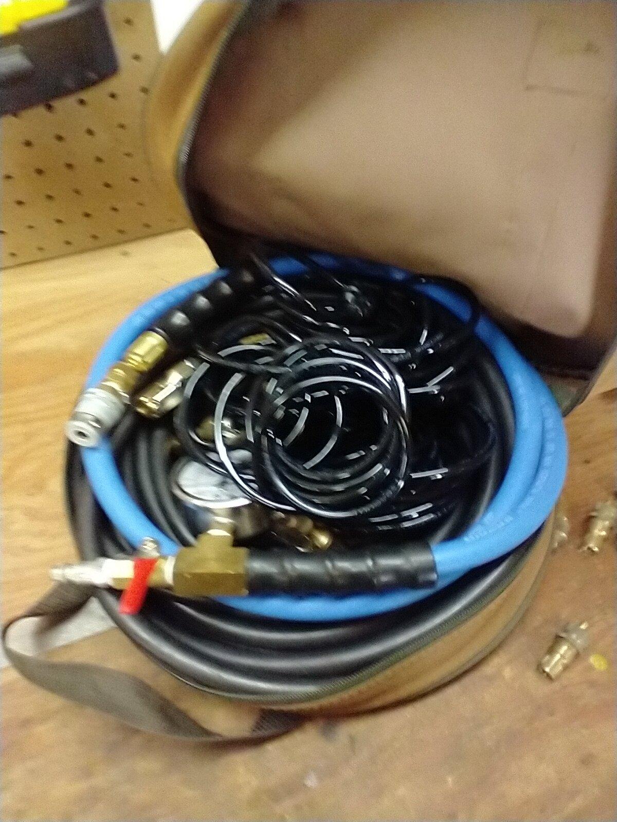

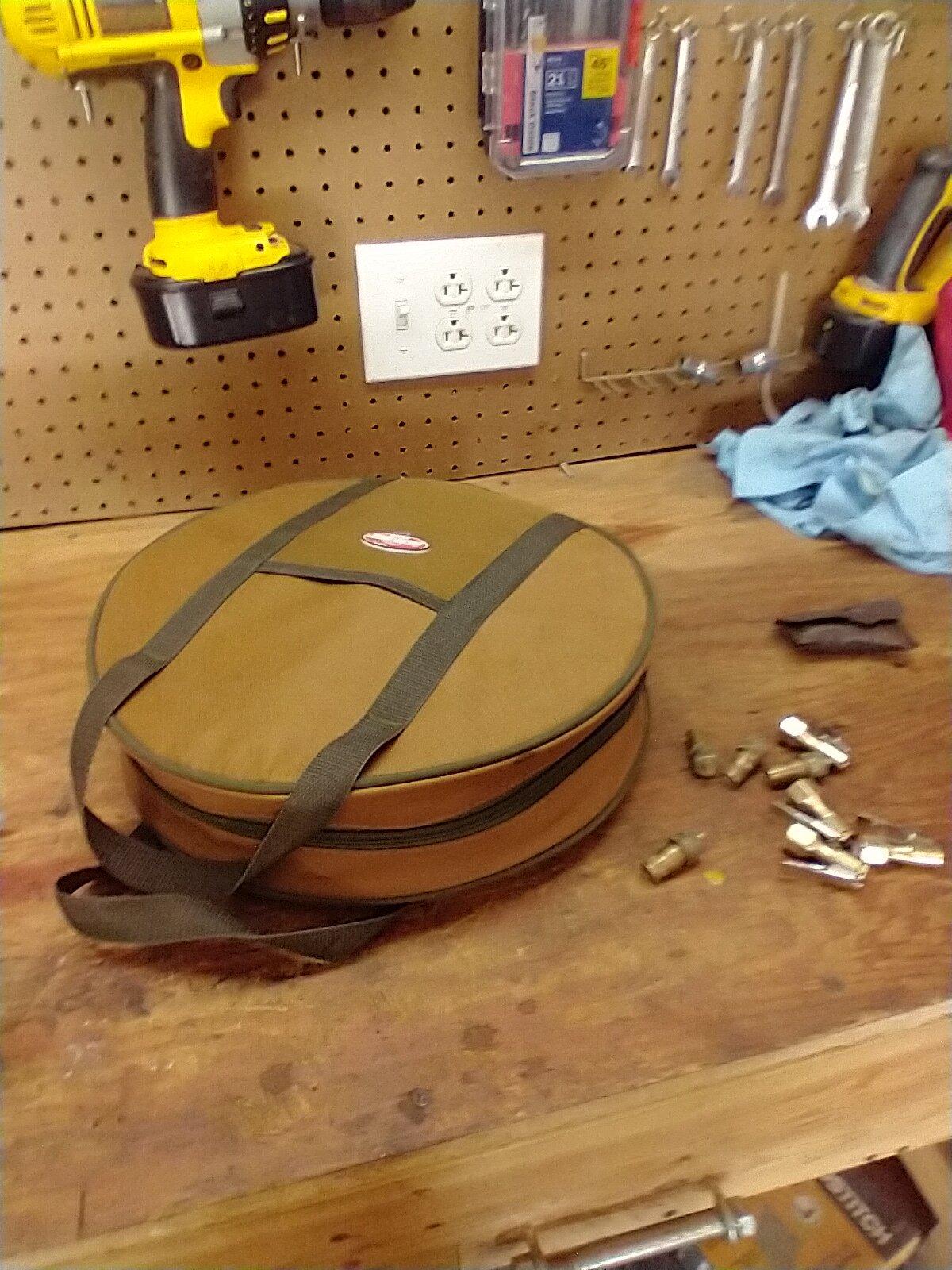

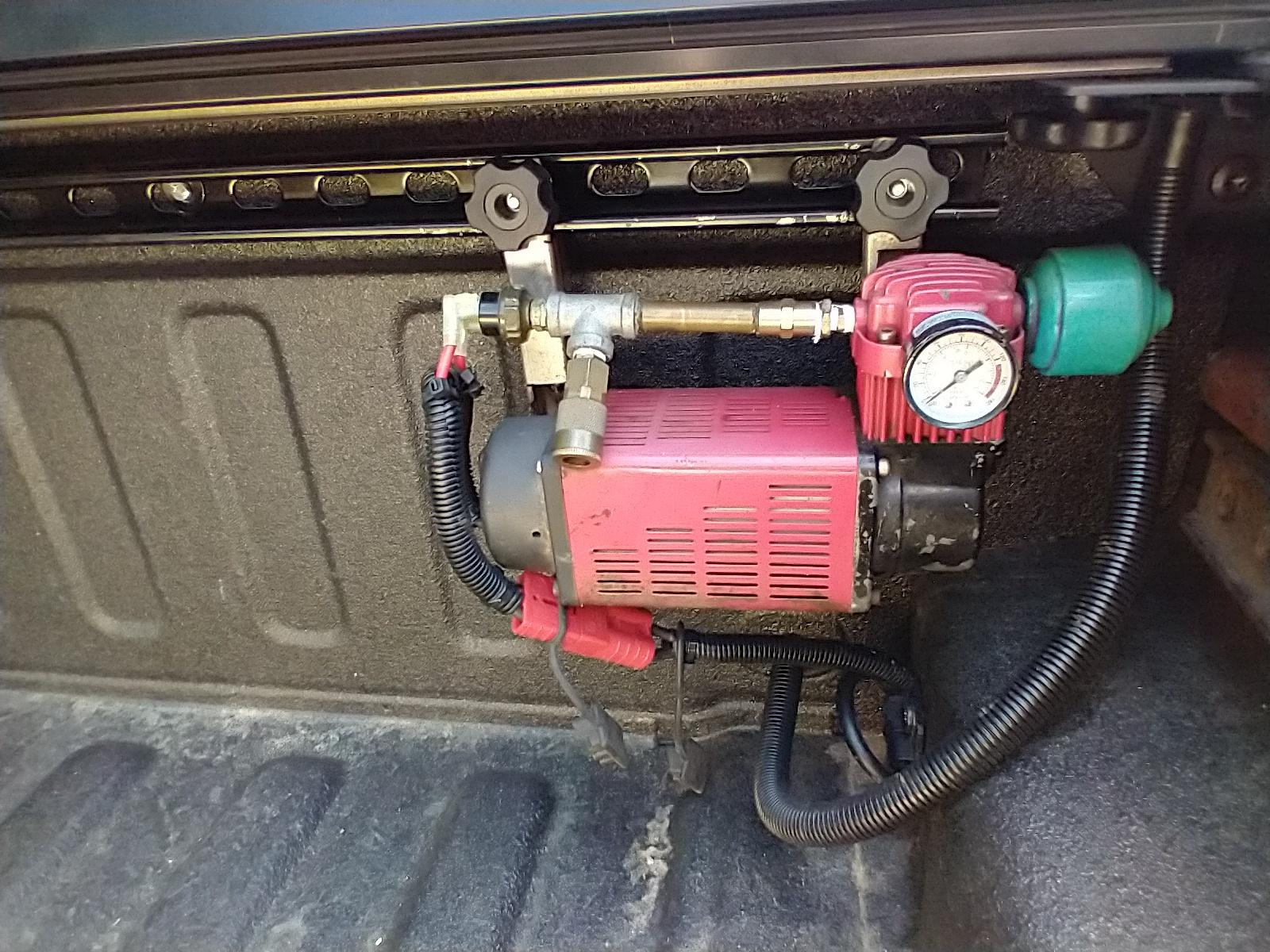

Took the plunge to pair with my Smittybilt air compressor. It all fits in the bag that the compressor came in.

I ran across these when looking for compressors. Looks like the same product is sold under a new brand with closed chucks now.
How is the system holding up?
I wasn't planning on a 4 tire inflation system, but my shopping research is never without a hundred tangents and considerations. Now I have to see if I may want one, or if there a cons I need to consider. Such as, should all 4 tires always be exactly the same? And does this achieve that well enough, or would front/rear weight differences make the pressure different?

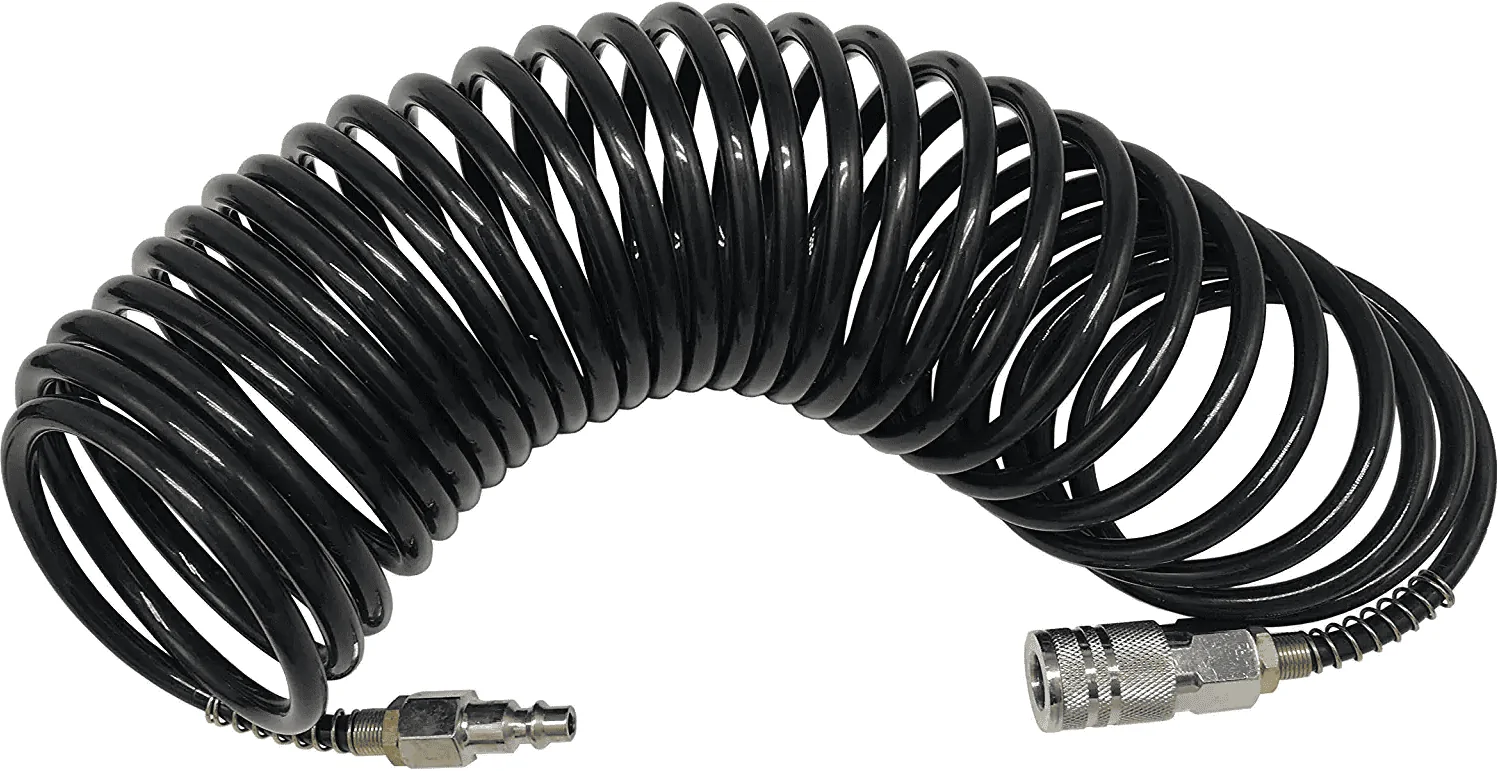

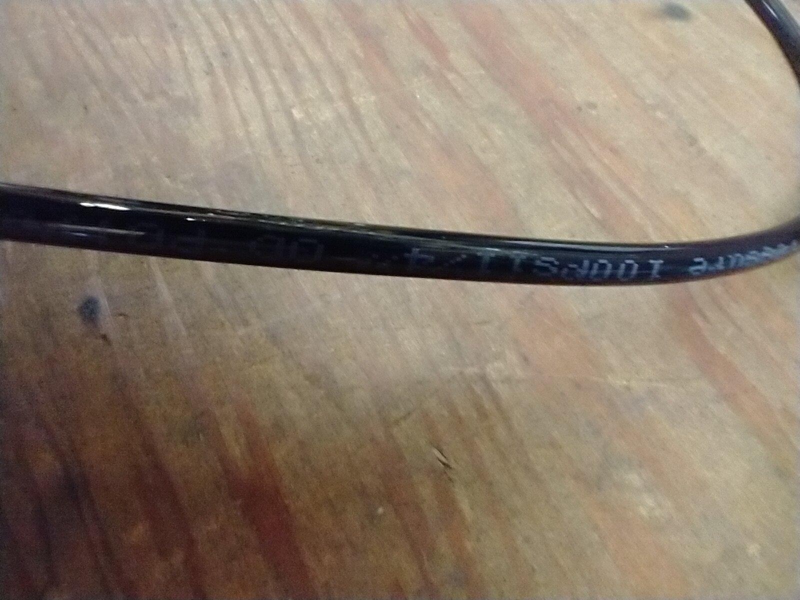

It is holding up well. To be honest, better than I expected. My only complaint is/was the air line gets tangled easily since the coils are so tight. I would get frustrated untangling before I could airing up. I remedied this by replacing the tight coiled airline with better air hose. I made a few other changes for the airline routing to make set-up easier by using a couple extra fittings. All the original fittings are holding up fine. I am guessing I have used the setup 20 times for reference.

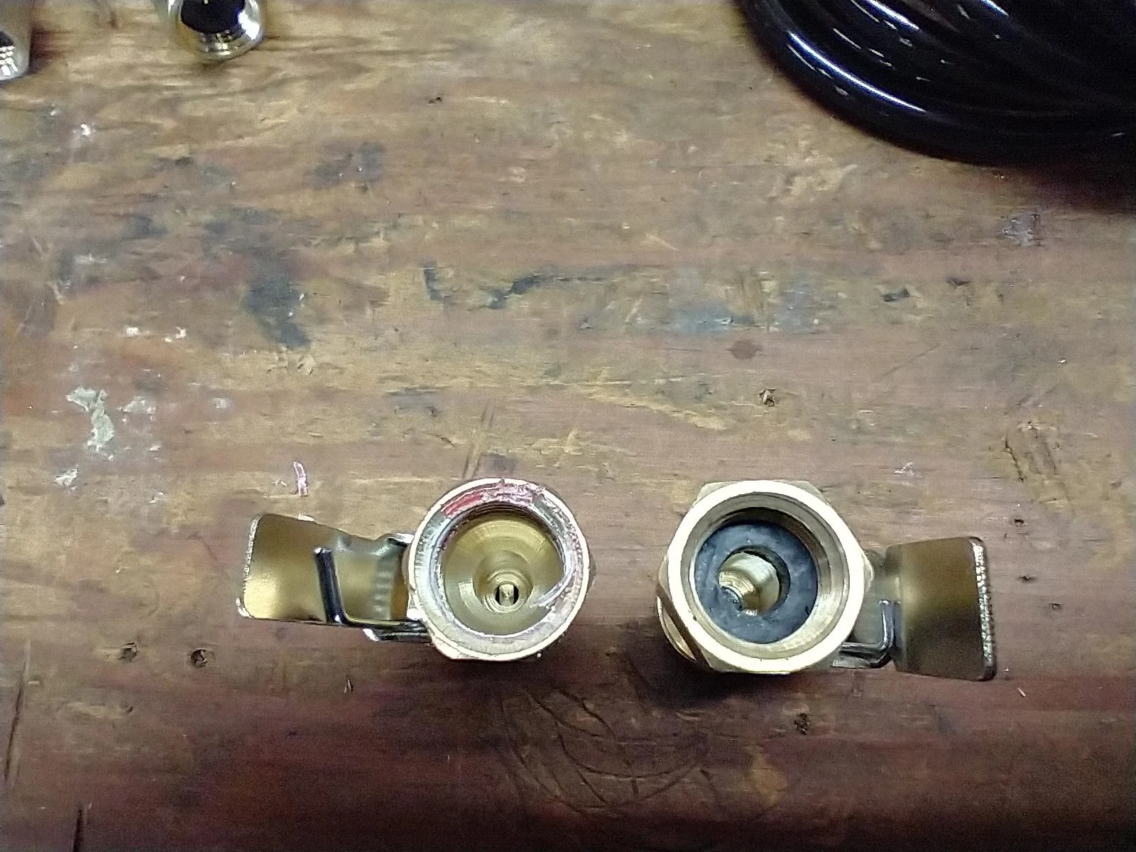

Seems to be a bit of a "Ship of Theseus" situation here. You replaced the chucks when you first bought it, now replaced the hoses, and altered the routing. What's left of the original, just the fittings (minus the chucks)?
I like the idea of coiled lines to bounce back to short, but with multiple lines I guess there could be a tangle issue. Probably not a problem on a single line.
I'm still not sure about a 4 tire inflator, as having all 4 at the same PSI is foreign to me. Yet, it seems that's how just about every one is running.

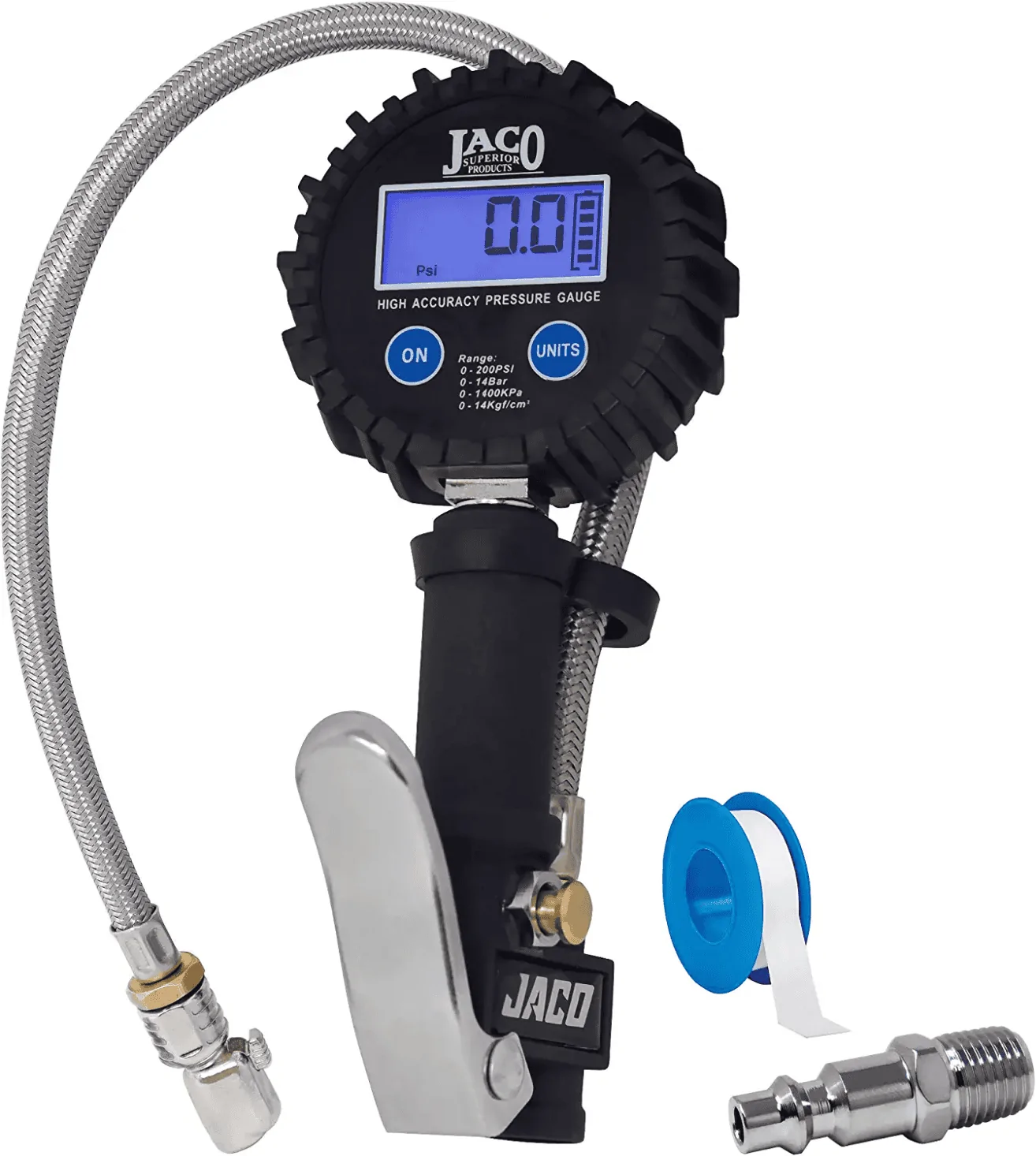

You have a good analogy of the situation. Knowing what I know now I could have put the system together myself for less than what I have in it now with left over fittings:
Pneumatic Air line: https://www.amazon.com/Pneumatic-Me...688640220&sprefix=1/4+air+hose,aps,92&sr=8-10
Fittings: https://www.amazon.com/ProSSS-Pneum...prosss+48+pcs+1/4+quick+release,aps,69&sr=8-2
Air Chucks: https://www.amazon.com/CZC-AUTO-Str...8640827&sprefix=tire+chuck,aps,83&sr=8-5&th=1
and then use a 1/4" NPT quick connect to attach to a regular quick disconnect instead of the fitting to use an air chuck, which I also changed out.
