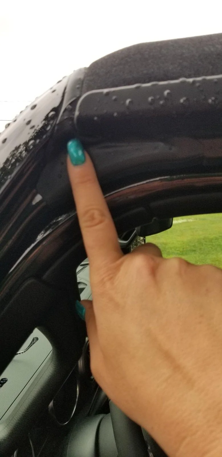

Everyone is saying this is "normal", however I owned a 2007 and 2012 soft top 4 door wranglers, and currently have 2015 4 door wranglers, hard top, and never had this issue. Got a gladiator last Saturday, and with today's heavy rains, I also had a river of water dump all over my driver's seat and the floorboard. This isn't "normal"... Not in MY experience, this is a seal flaw. I suspect I may have to fabricate an extension of the water channel to the right of my finger so it extends to the seal area on the left of my finger. Maybe I lucked out in my Wrangler history, but this has never happened to my vehicles before.
yup same place here too :-(
