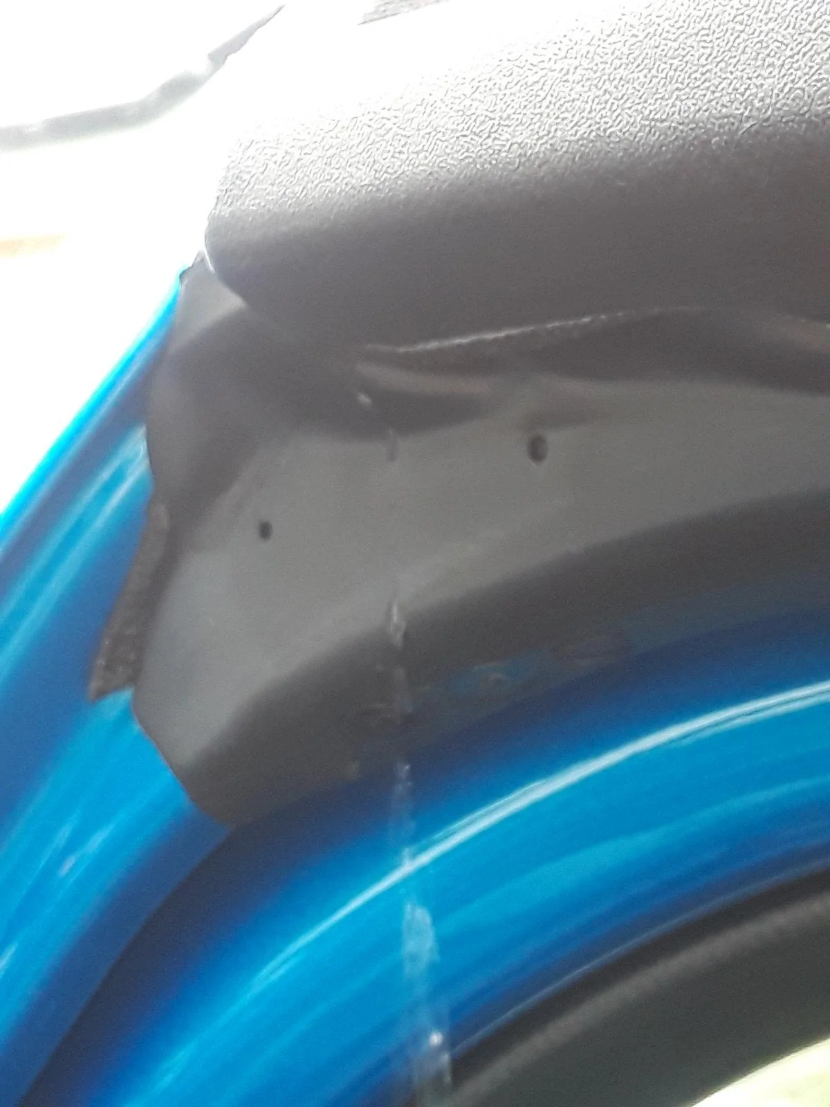

New 2020 Overland owner here and the first two days I owned my Gladiator it rained. A lot.
Every time I opened the door, the rain water would pour into the cab, on the seats and floor. I traded in a 2008 4dr Unlimited so I didn't care much about water but my new Jeep has leather and I guess I'm being more cautious. Anyone notice this issue?

I put a blob of black silicone at the channel edge to create a dam/blockage. The water now drain to the rear of the door and harmlessly away. Try it yourself...

This water is running down the drip rails on both front doors. Not normal and it's not a leak. Drip rails must be redirected . I will extend mine to see if that works.
