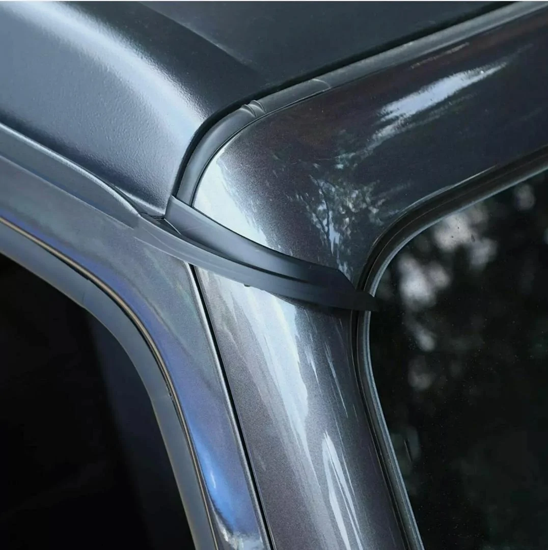

I have these (see photo) and they've slowed the stream down to a drip. The directions say to apply RTV to the spot where this piece meets the gutter. I have both tops so I can't do that. I haven't done it yet, but I was going to apply a small bead of silicone and mold it to where the Freedom Panel and soft top frame piece meet the diverter and see if that further slowed water flow. For $11, they're definitely worth it just to slow it down to a drip.
Jeep Gladiator Poor design, rain gutter over front doors. Screenshot_20210919-112607_eBay

Exactly! You described it perfectly. It is not just after sitting parked, it happens when driving in the rain and stopping to leave the truck.
is it just me.....i dont see a photo.

It's nothing to do with the windshield. IT's the freedom panels, the slope of the gutters. On most cars or trucks that still have conventional "rain gutters" the gutters take the rain back to the quarter panel or to the A pillar and down. These channels stop abruptly over the door opening - so you can remove the panels.
It's the price paid for removable panels, removable roof - and a Jeep shape.

Actually - all the old CJ’s had a gutter extension down the side of the windshield which I am sure was removed for the sake of mpg…. All the aftermarket solutions seem to lean toward adding that gutter back.

MPG - and perhaps noise. It does lead to wind noise. Several people I know of have removed the rain gutters/drip rails from their classics and some said one of the differences aside from the cleaner look was - noise reduction. (I hate the look on the classics, but whatever)
That thing sticking out there not only catches wind but it disturbs the air flowing down the side and has impact on drag of the whole side.
So your MPG point is well taken.
But it would also take some doing to make it continue forward and have a removable panel unless there was some sort of flexible seal there.
