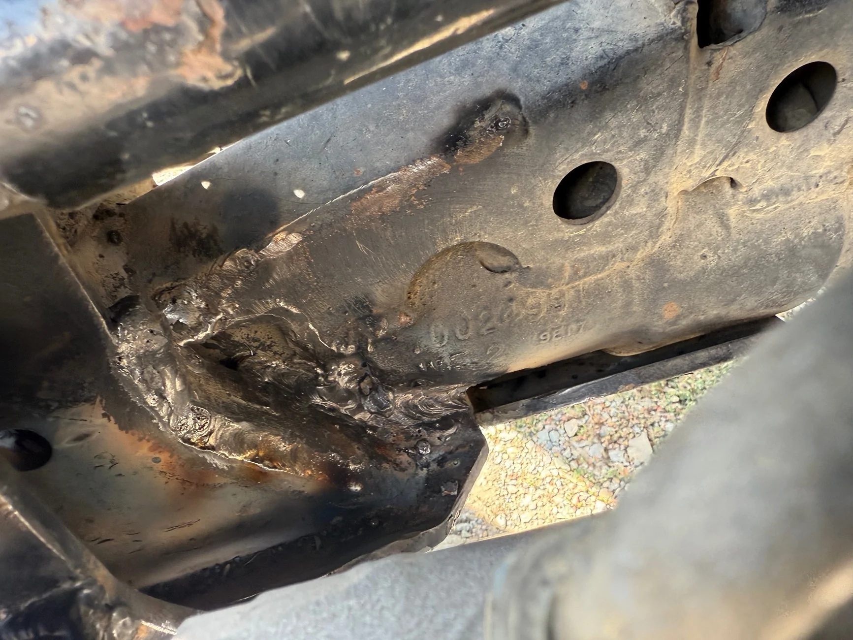

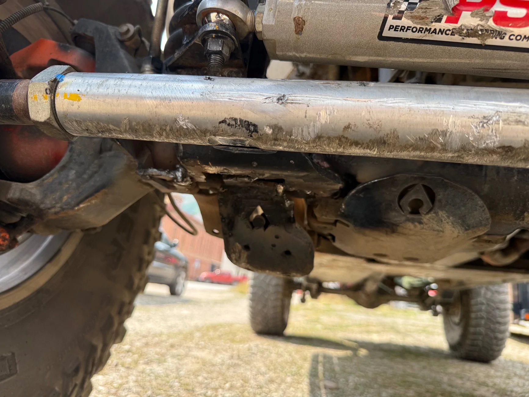

Had some fun with the track bar bracket :( This one is clearly my fault for not welding at a high enough temperature.
Start of the story:
- Before the trip I had saw some metal stress in the bracket. I cleaned and re-welded the bracket. My welds looked clean and I didn't see any signs of contamination.
- During the Rubicon I periodically checked to make sure everything is ok. Welds looked good for the whole trip.
- After the Rubicon, we had about 3 hours of road driving to get to hotels and back to the trailer.
The roads around Tahoe are pretty bad, and part way through I started feeling a little wobbling... which quickly turned into death wobble. The first occurrence was BAD, clearly something had come loose.
I stopped and check, and sure enough, while my welds looked like they were still holding, I hadn't gotten deep enough. So where I touched the other mild steel components, the weld was still solid, but it was bending. Where I was fusing to the axle housing itself though, my welds were coming loose.
Drove slow and careful, and got back to the trailer.

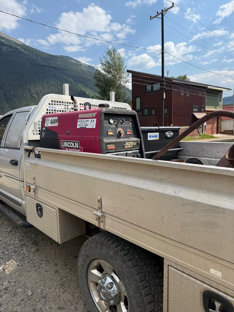

At our next destination (Silverton), I found a local blacksmith who had a welding truck. Literally nicest guy in the world. He let me use his truck and set me up with all the equipment I needed to clean and prep everything.
This time, I nearly doubled the amperage and got a really solid weld. It held the remainder of the trip.
Some tech details:
The original welds were TIG welds done at around 140-150 amps. Which was probably the right temperature for just the metal on the track bar mount. I picked that temp since I could see solid welds being formed between the different mild steel parts.
New welds were with stick between 200-230 amps. They aren't pretty, but they definitely penetrated and are holding solid.
As part of my post trip maintenance I intend to take the axle off, take it apart, and re-weld with a new bracket.
Good learning experience and I bought some really beautiful metal art from the Blacksmith whole helped me out :) It was also fun to use a big fancy welder, I haven't used a machine with that high of a top end amperage before.

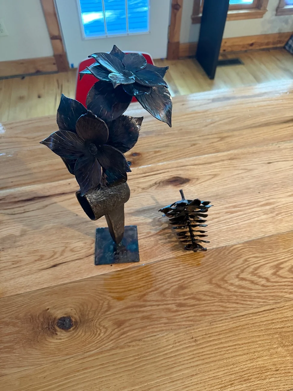

Any pictures of the blacksmith art?
Here are a couple of the pieces. I also have one at my office with really delicate little flowers. The picture doesn’t do it justice, but pine cone is has some super impressive detail.
Love it. Thanks.

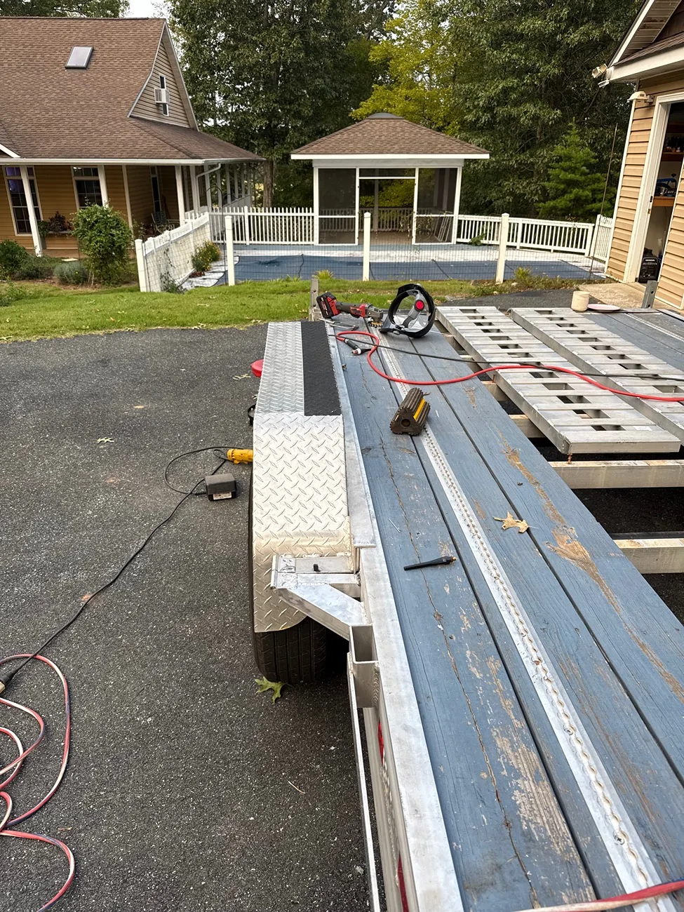

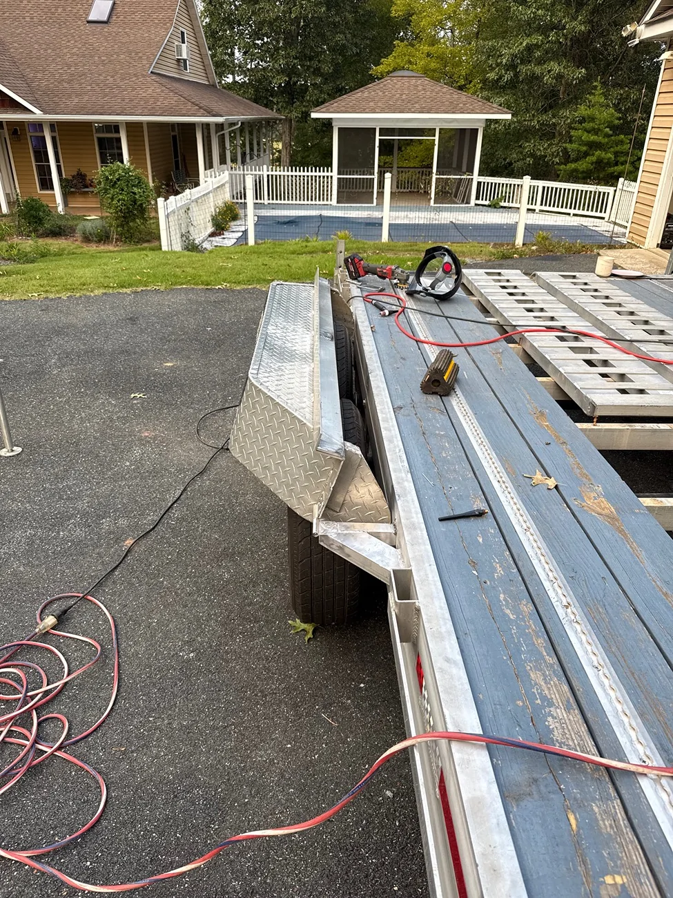

My trailer fenders fell off. The folded aluminum fender "connectors" started to tear, and progressively tore all the way off due to the bouncing I assume. Time for an upgrade. It always annoyed me having to unscrew and remove them, so I'm trying something I saw randomly on YouTube a while back.
Fabricated some new mounts out of spare aluminum and welded an aluminum hinge to it and the fender. I have a locking spring loaded pin on the way to secure the fenders in the closed position.

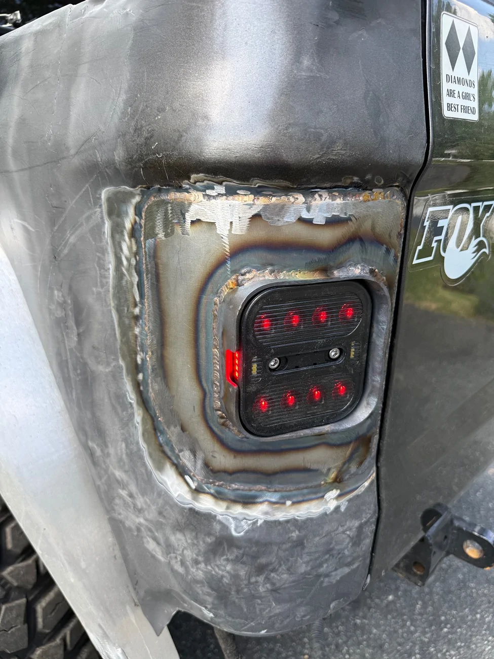

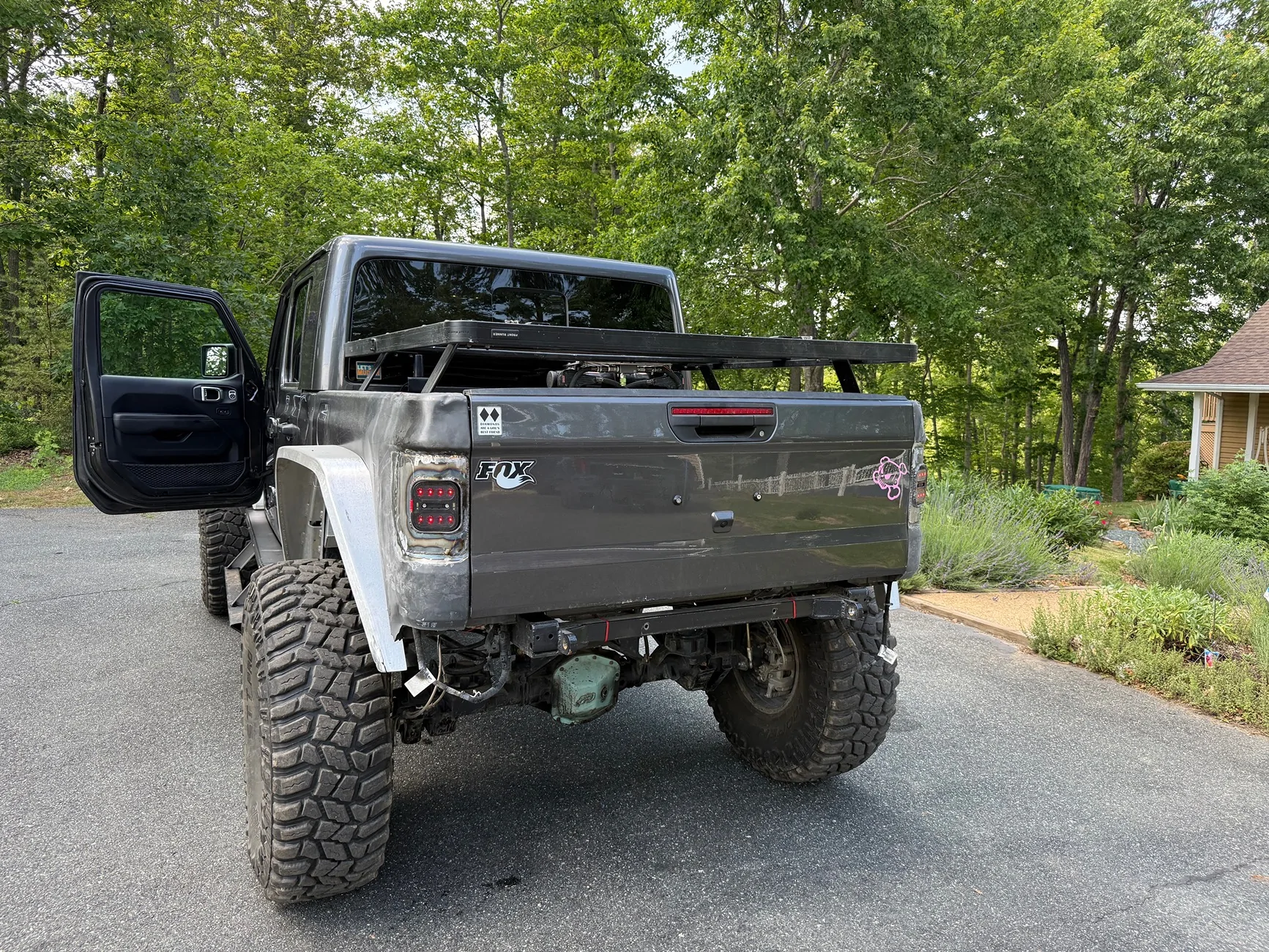

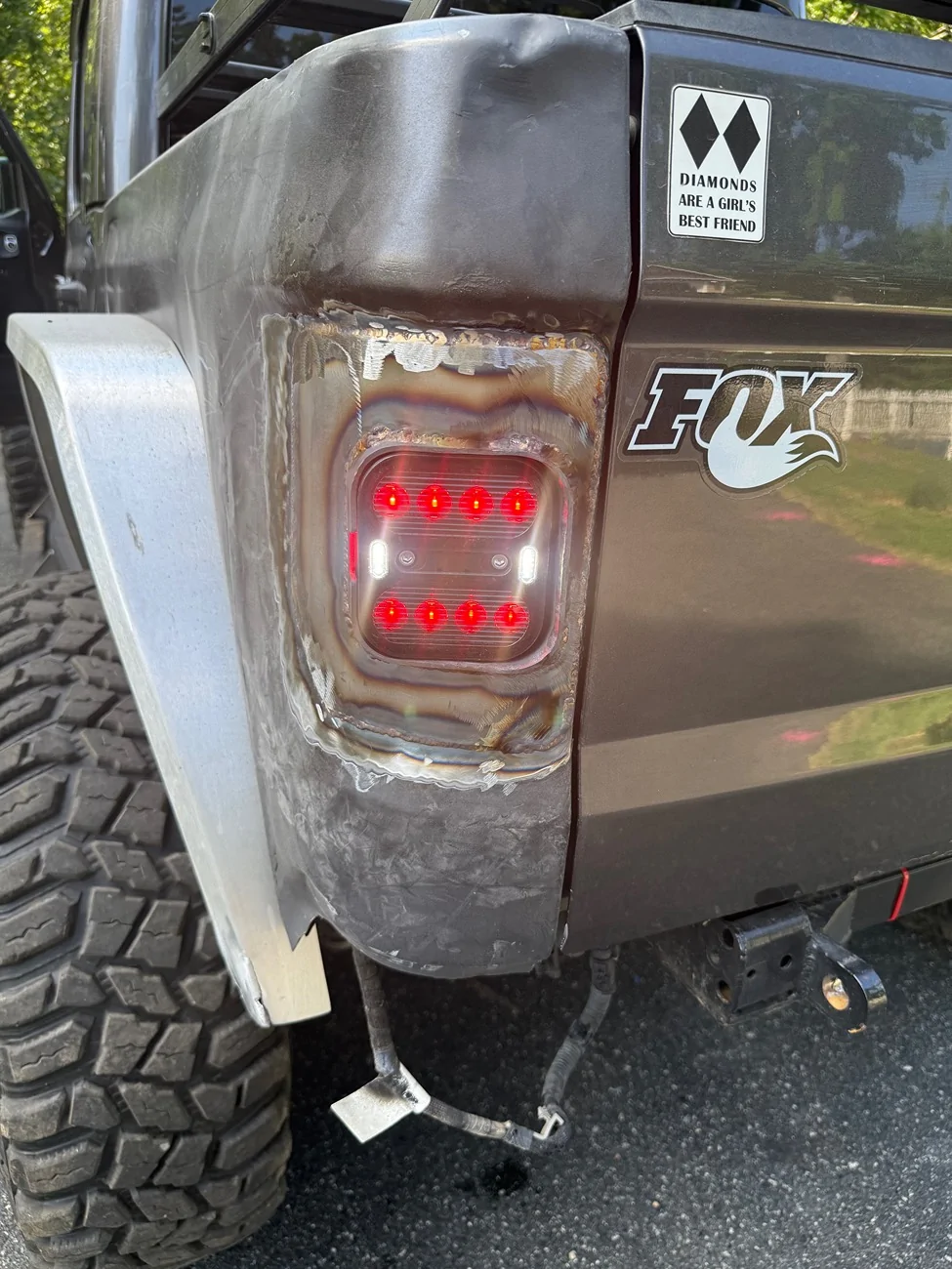

Finally got to my new tail lights!
I used the gen right matrix leds and their steel weld through mounts. I made some sheet metal replacements to fill in where the stock lights go, and tig welded the whole thing together with silicon bronze so I could keep the heat low.
Fingers crossed I can pass VA inspection again now :)
