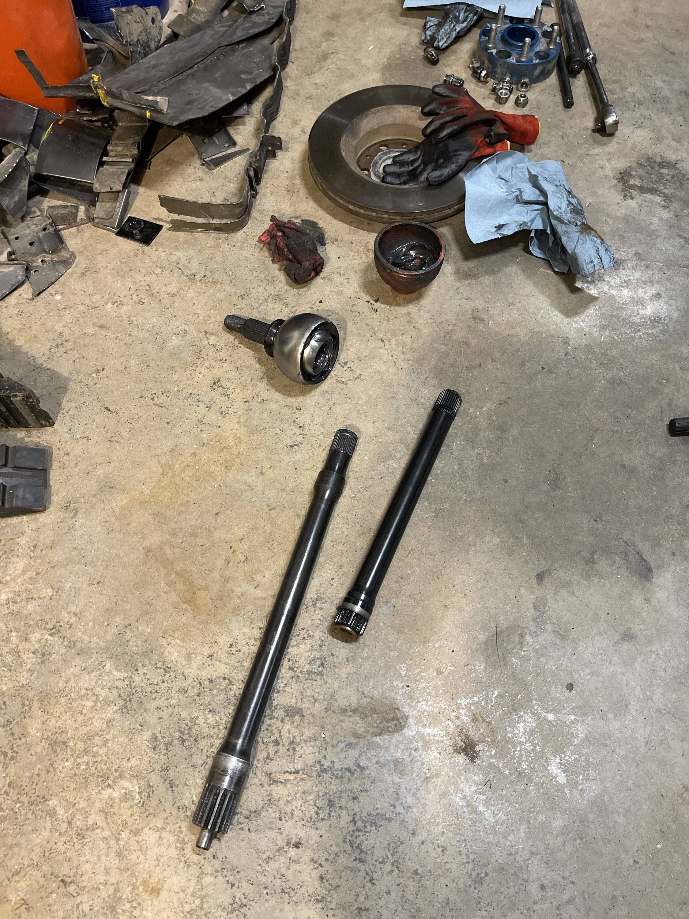

As I had previously mentioned, I switched to 5.38 gears. As part of that project, I was hoping to re-do the lockers so I could activate the front and rear independently (unlike the all or rear option stock). So I removed the harnesses, and rewired them to aux switches (for now).
Unfortunately, doing this throws a 4wd fault. I tried using J-Scan to disable all of those features, but can't find the right combination. There appears to be a "vehicle configuration mismatch" error that is confusing everything. So for now, I used my tazer to disable the lockers. If you leave the taser connected it will kill the faults.
This did lead to another problem.... tazer expects the fad to also be disabled if you disable the lockers. So, I order the solid axle for my RCV (you can get that part specifically if you call them) and swapped it in.
Truck is running well now, but it is annoying that I have to leave my taser plugged in.

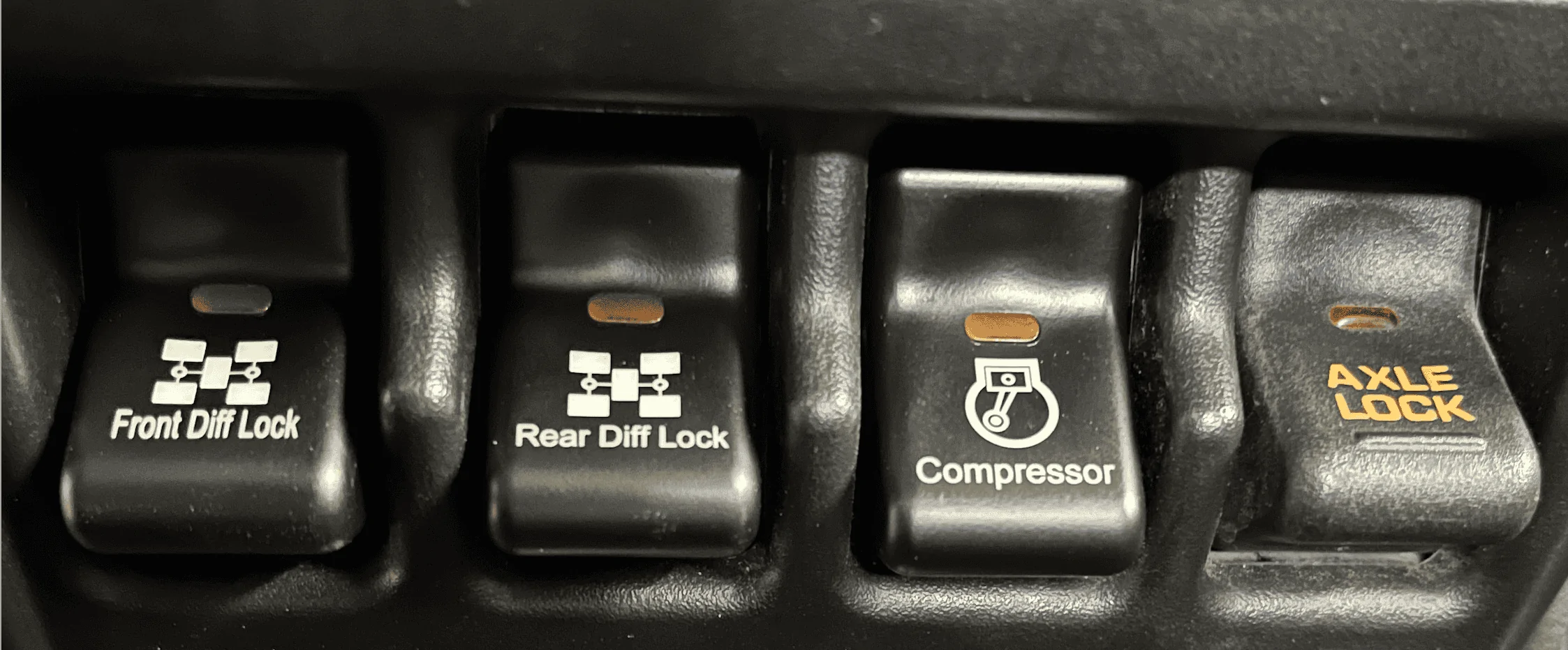

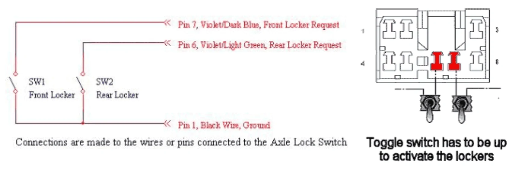

I guess no one figured out how to tap into the existing harness wiring to bypass the stock switch like they did on the older Rubicons. I simply tapped 3 wires and added 2 switches to my TJ Rubicon.
Wiring Diagram as a PDF is attached, but this is specifically what I did.

I snagged some OEM looking switches to put in the OEM location [And added an on/off for the York Compressor] I left the original switch as a backup if I ever needed it.

I did this on my First TJ and can't believe I waited this long to do it again.
I seriously think that the people who force the rear locker to always be on, in order to engage the front locker, NEVER rock crawled
There are so many situations where having the front locked and the rear unlocked is invaluable to climb a Rock, especially if you have to turn while doing it.

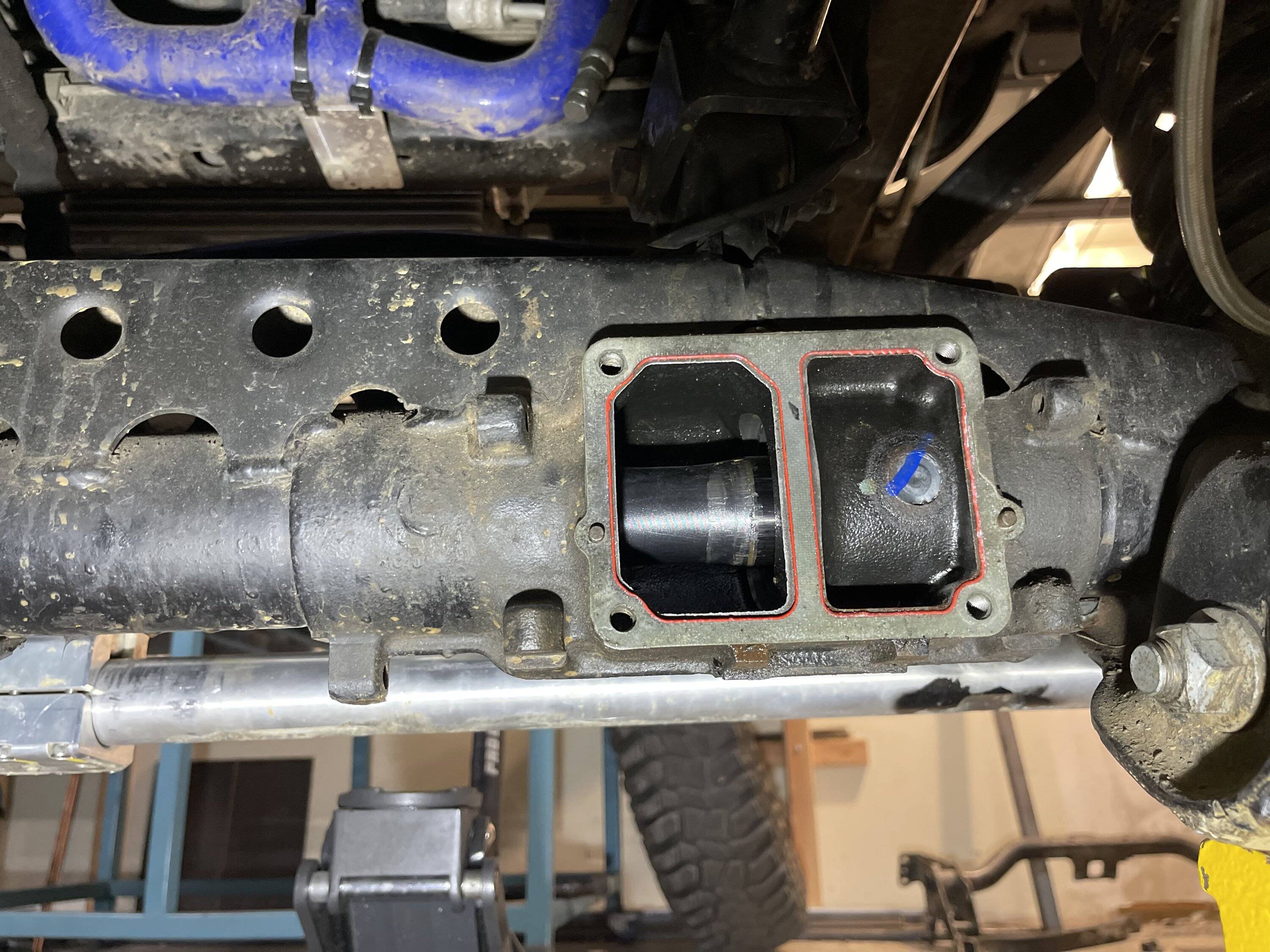

The Jeep gods did indeed smile upon me! The problem was identified as the oil cooler. Independent research shows that was a JK problem too :(
The surprising thing was how the dealer replaced it no questions asks, even when my truck showed up muddy:
Big thumbs up for Umansky of Charlottesville for anyone in the area.
Hopefully they replaced it with the aluminum part and not the plastic one. Same thing happened to my wife's JK
