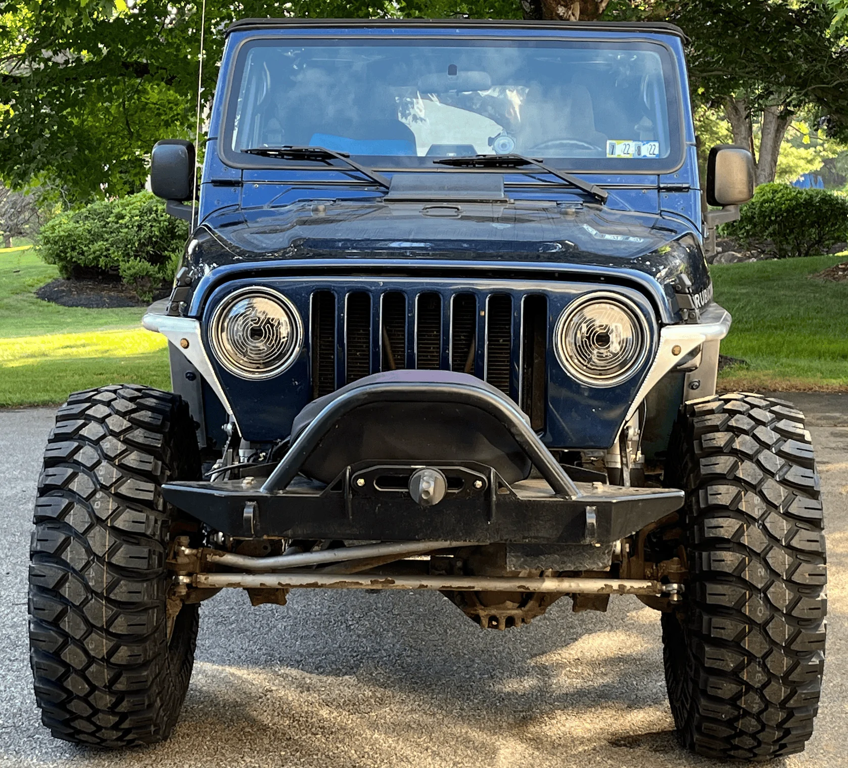

I always follow your builds, and as others, am impressed with your talent and nerve. I always thought your rear bumper was cool and lightweight, but now think it needs your touch, perhaps even sell it and fab your own rear bumper with as much clearance as possible, unless the bumper rules dictate that height of bumper, just saying.....Jack
You are absolutely right. I’m not happy with it either in its current state, but planning to run it a little as is to see his things work.
I do unfortunately need to keep all of that bumper height to stay legal, but it’s not super effective in its current state.
I’m open to creative suggestions

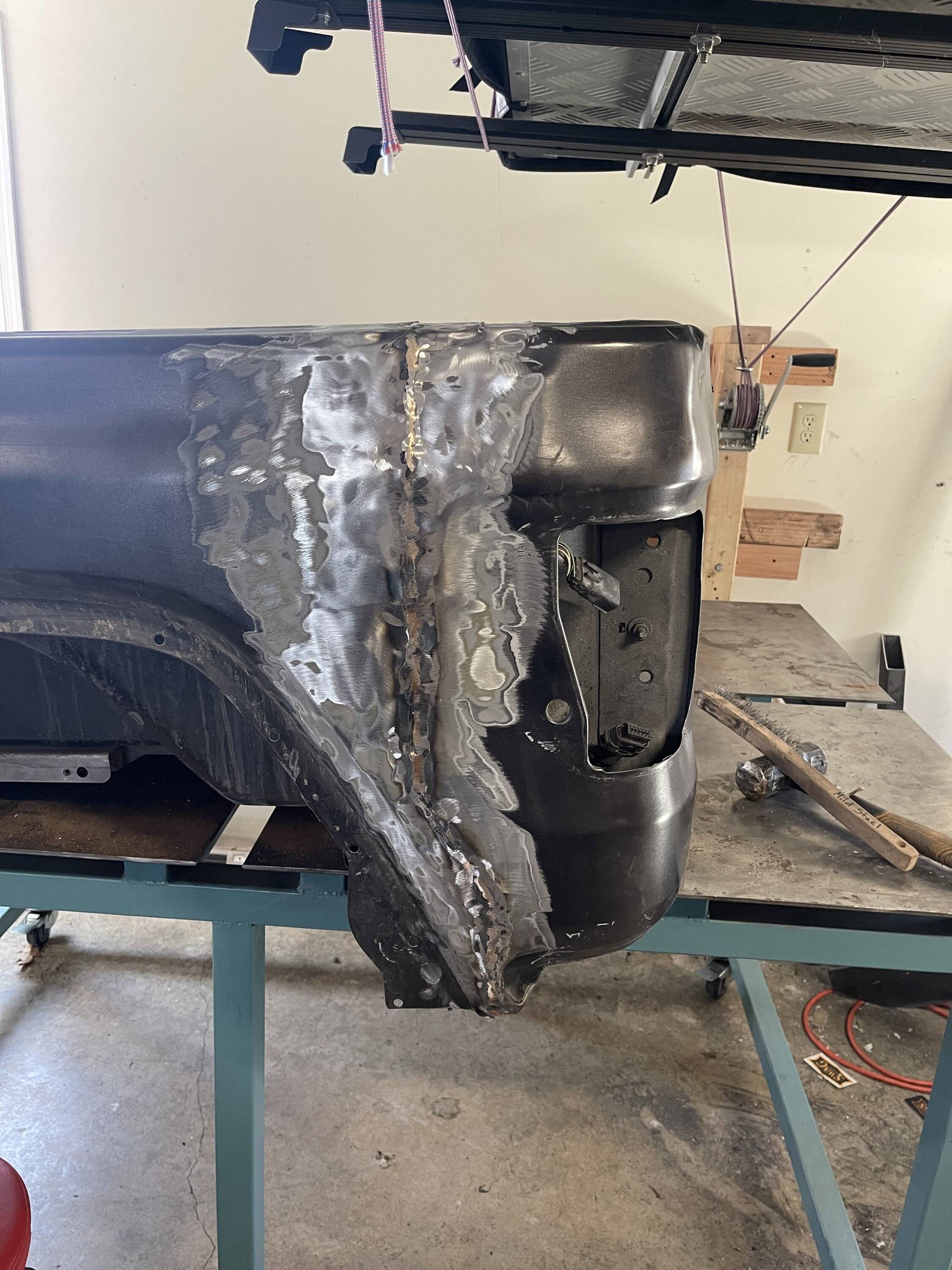

Finished welding the bed back together. Doesn't look particularly amazing in its unfinished state, but it's actually pretty smooth after a little hammer/dolly and pry bar action to counteract any heat deformation.

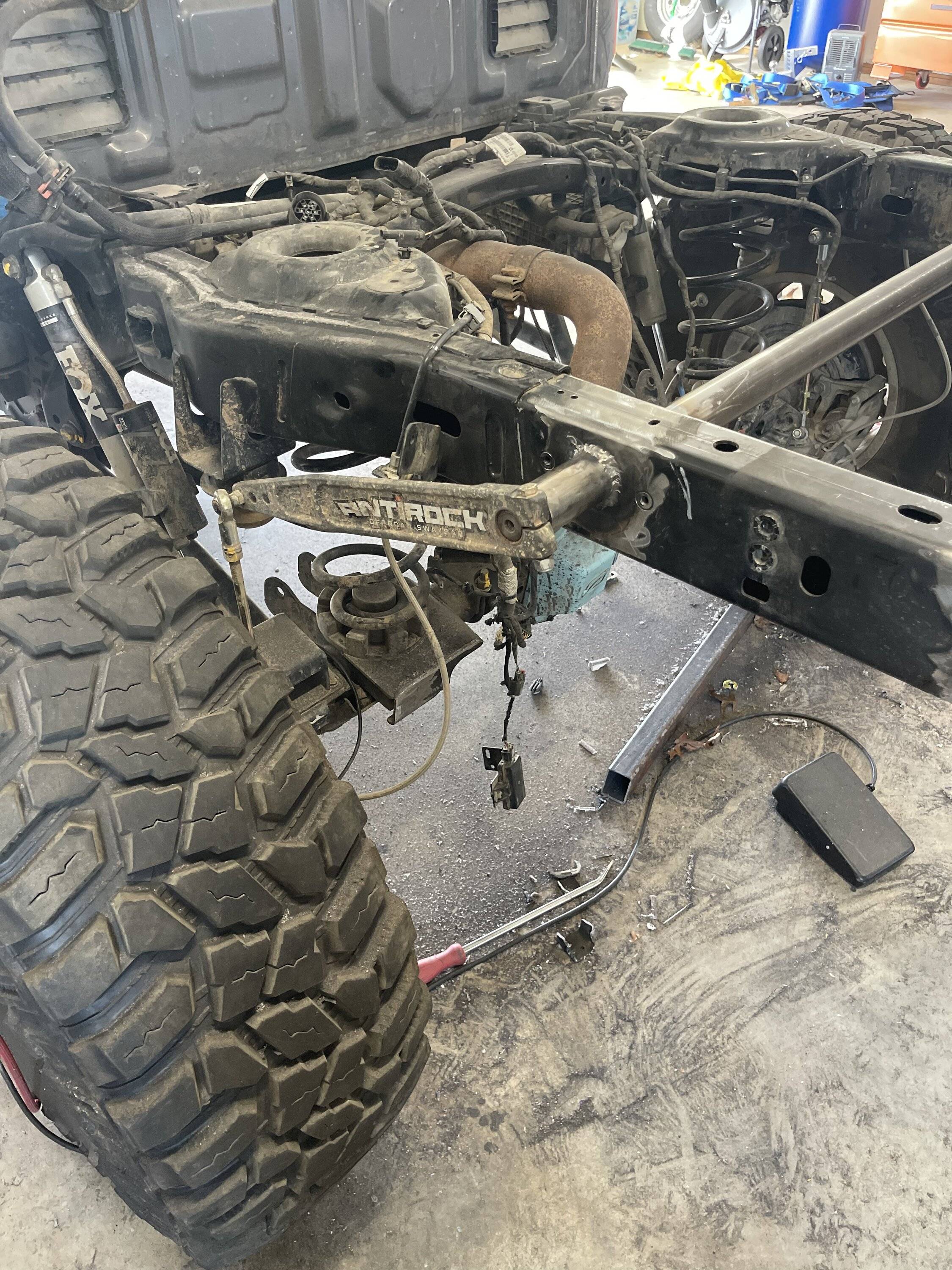

Bed is back off the Jeep so I can get at that cross member (right over the axle). That's on the chopping block next! I've got a 50" piece of pipe incoming and some plate ready to fabricate into frame reinforcement washers to replace it and house the sway bar. I want that thing to be bullet proof after losing my sway bar 3 times last year due to bracket failures.

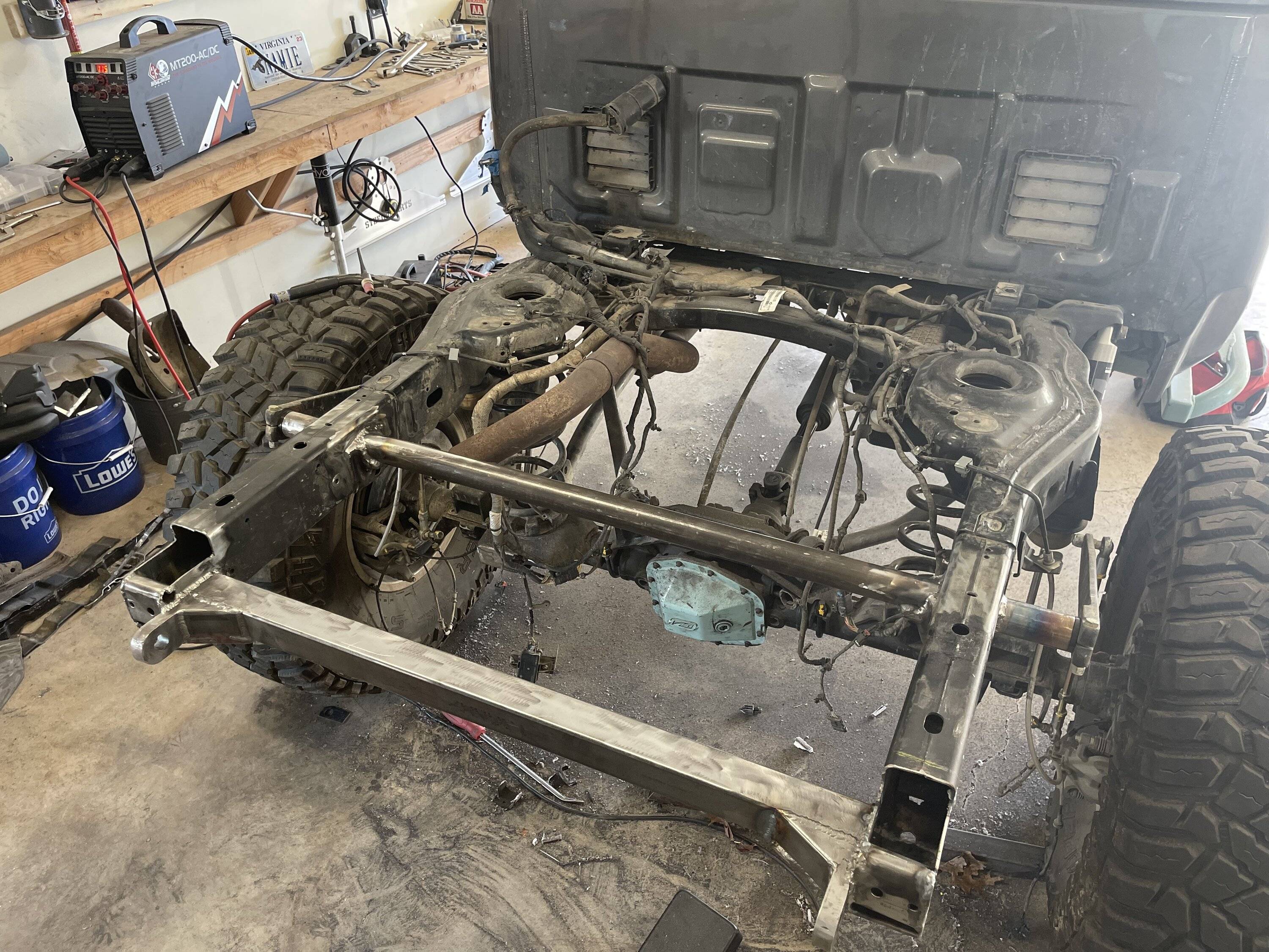

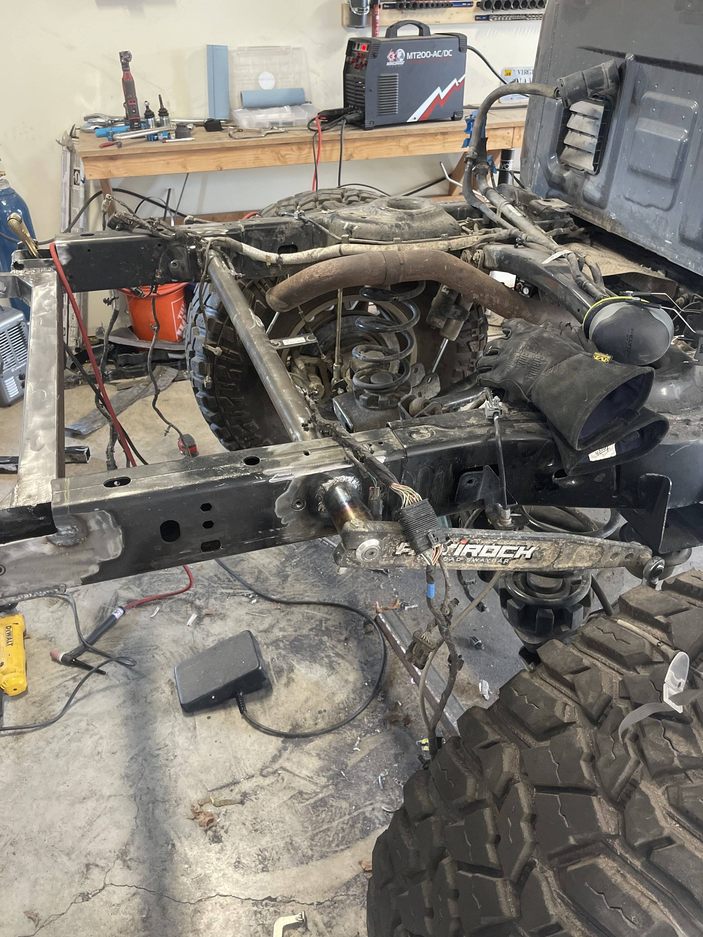

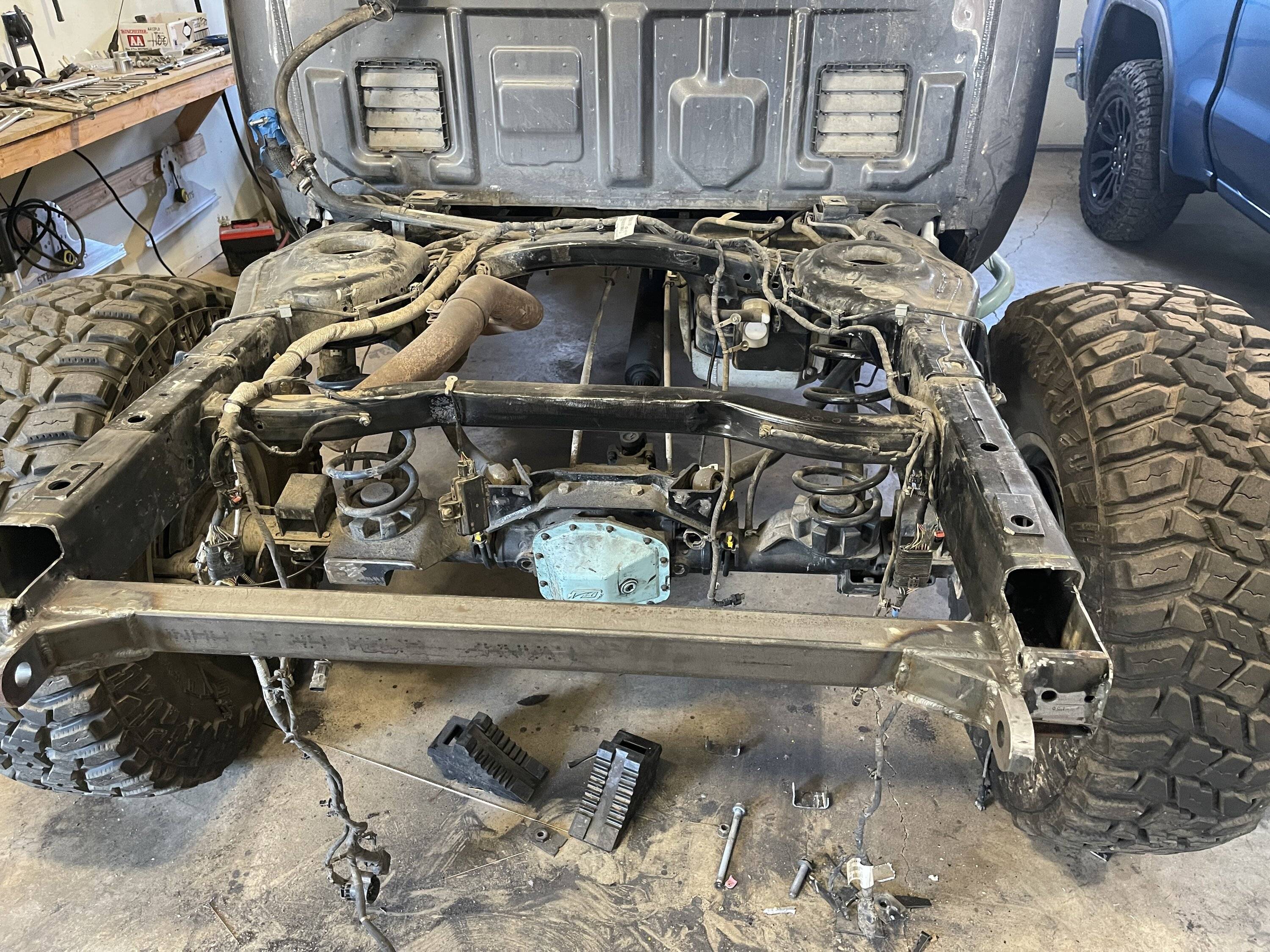

Got the sway bar mounted today. It was actually kinda cool. So after cutting the old cross member off, I was comparing the metal tubing and found that I could ALMOST fit it through the cross member that was welded through the frame. Since the cross member had some nice reinforcement and it would cause more trouble than harm to rip it out…. I just hollowed out the left over cross member inside the frame and the reinforcement braces, then welded the tube into it.
