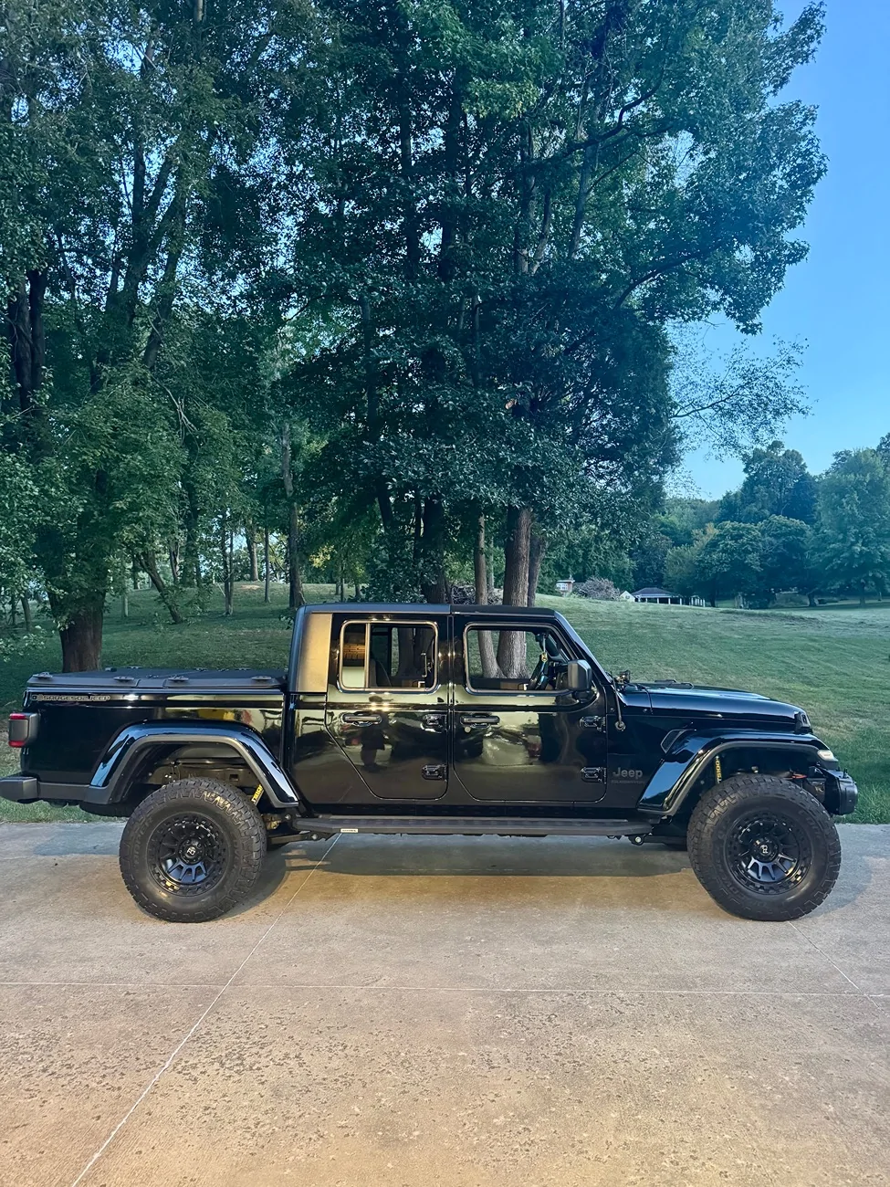

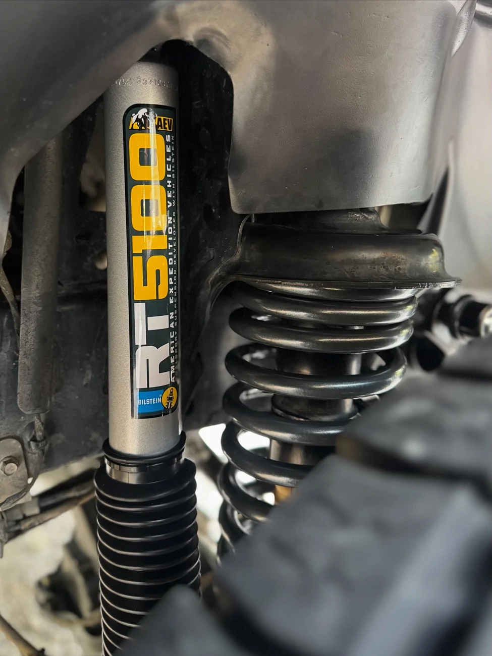

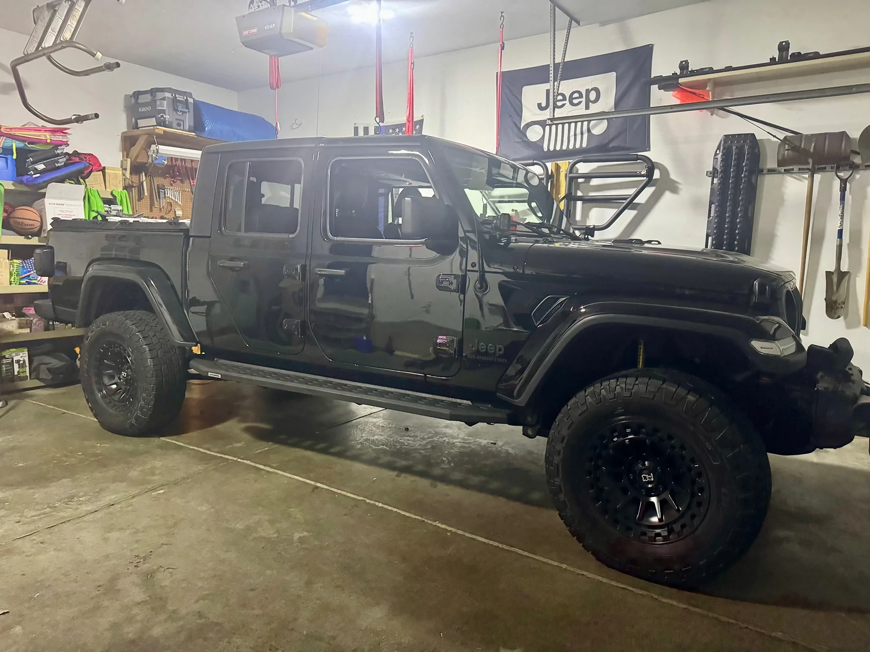

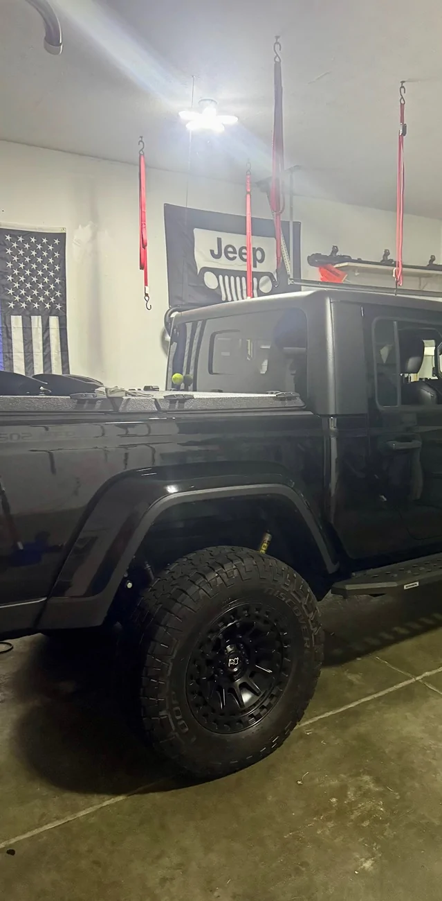

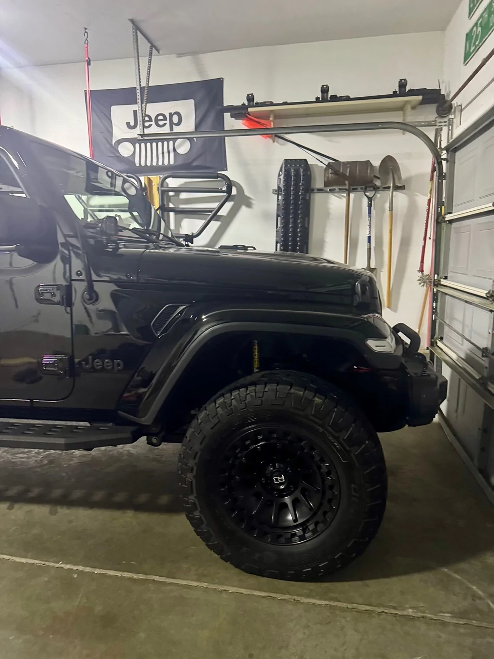

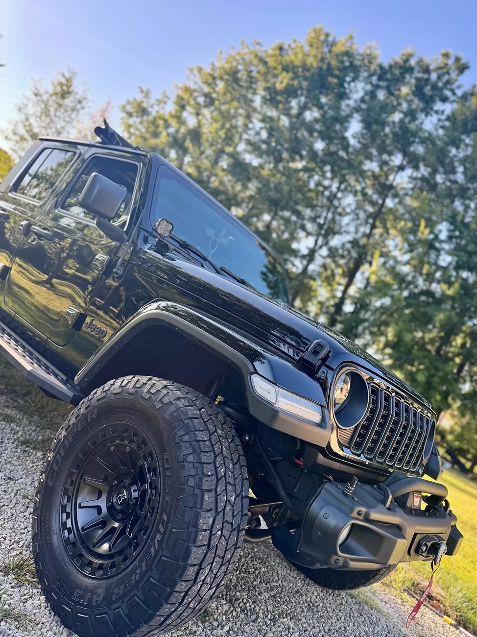

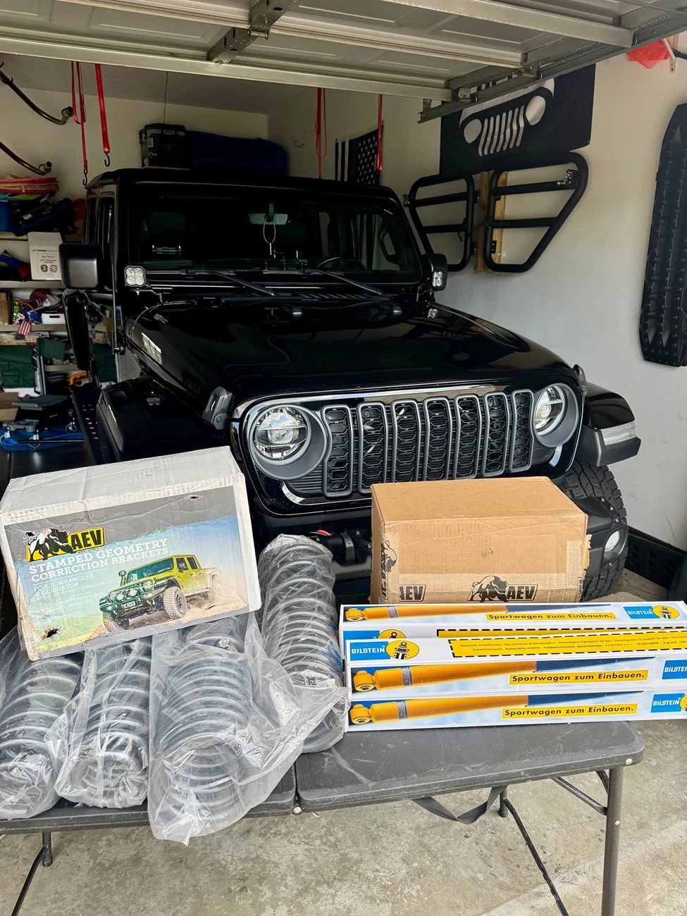

Update:
Finally installed AEV's Dual Sport 2.5 RT suspension. Have been putting this off for the longest so it's well overdue extremely happy with the ride quality so far significant difference. I highly recommend.

I presume you went with the standard duty spring set? I ran Metal Cloak on my last Jeep. Nothing wrong with it - just looking at various options.
No front driveshaft needed? I see their kit doesn't have a front track bar. Did you add one or see need for it?
Trying to convince myself that my truck does not need 35s or a lift kit.
Not working out well.
Yup went with the standard springs. Even the standard, accounts for up to 400 lbs of additional weight (primarily those with steel bumpers, winches, etc). Spoke to AEV numerous times on this since I do have a steel bumper and winch. Per AEV, the only need for the high capacity springs are recommended for those with heavy overland builds with toppers, RTTs and racks. Inquired about the high capacity with them considering I dont have a lot of the extra weight and although I could have went that route, the ride would have been hella firm, which kind of defeats the purpose on this kit considering its one of the most comfortable out there (largely due to the incorporated geo correction brackets).
Did not need an "adjustable" track bar. Some have added it. But definitely no need. And the kit comes with driveshaft spacers to lower it slightly.
Highly recommend this. Did the install myself too
But yeah good luck tring to convince yourself about not needing a lift and 35s. I tried early on and didnt work out well. lol.

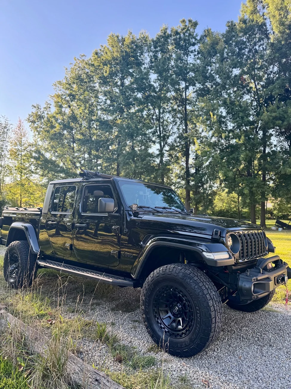

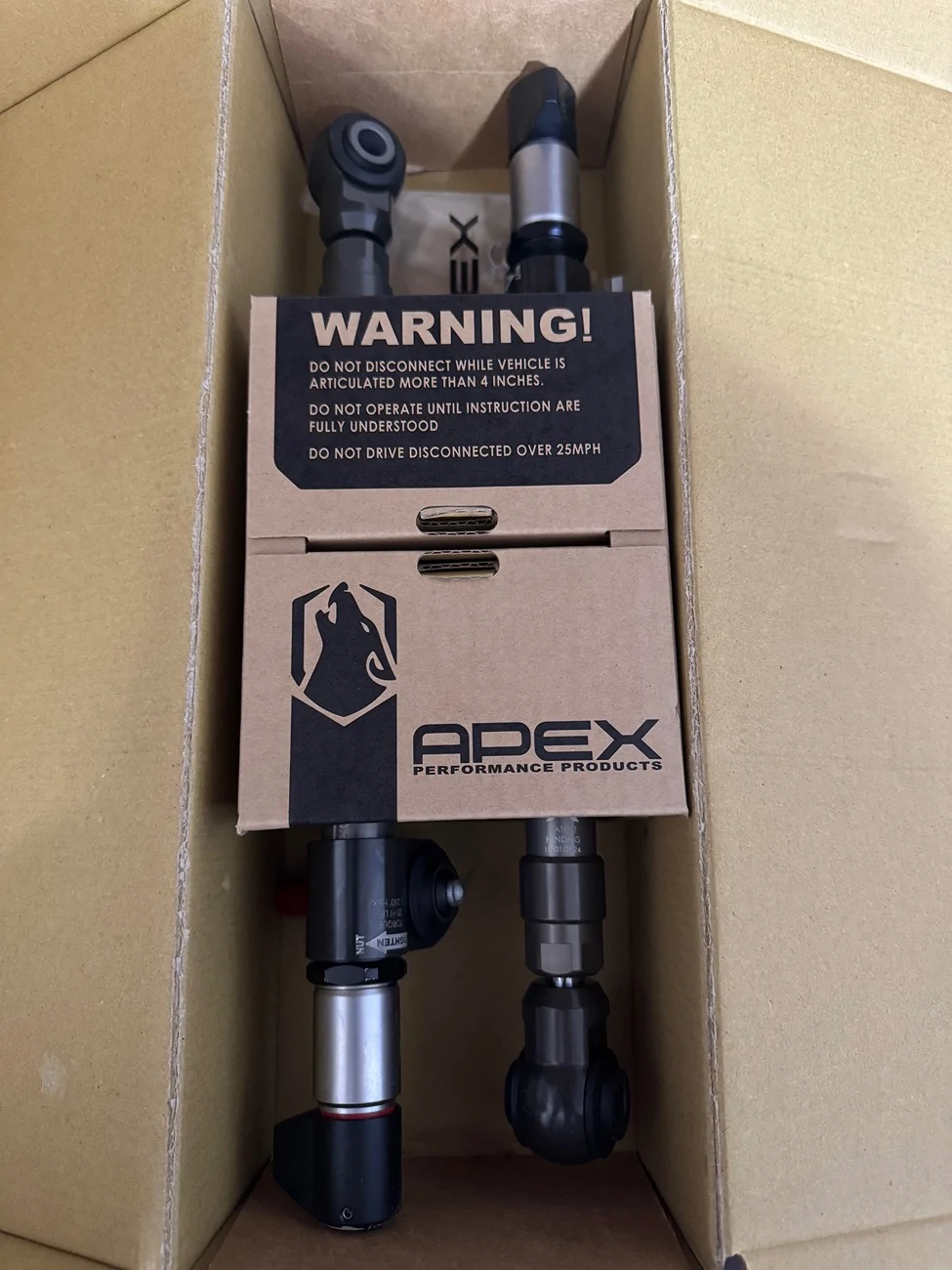

Ok so then it sounds like your 5100s aren't the same in this kit. Which I wasn't aware. Hmm. I get not being a fan of shock extensions. But at the same time although it's a different kit, AEV themselves have stock extensions for the front and rears of their 2" spacer lift which had before the Dualsport and ran for a few years with no issues. Actually I'd kept that kit had I not wanted new springs and shocks which is what that kit lacked and why I eventually upgraded.
But also I wouldn't really try adding shock extensions in after the fact mix and matching components either just to save a few bucks. So I get it. I guess you could just get the dualsport and sell your current 5100s.
Also funny you mention the Apex disconnects. I literally just purchased some the other day, but haven't installed them yet. I considered them early on but knowing I eventually wanted to upgrade my shocks and springs to this kit, I waited just to be certain I based the selected stroke size option correctly. Ended up buying the 10.5. Again haven't installed them. But they should be fine with this kit. But again if your shocks are different than maybe not. Also not sure what size apex you have either. So I definitely get your concern.

Yea I have the 8" model Apex disconnects. I bought those a lot longer ago though, like three years. Well before I was considering anything I am now. Shortly after they came out I believe.
