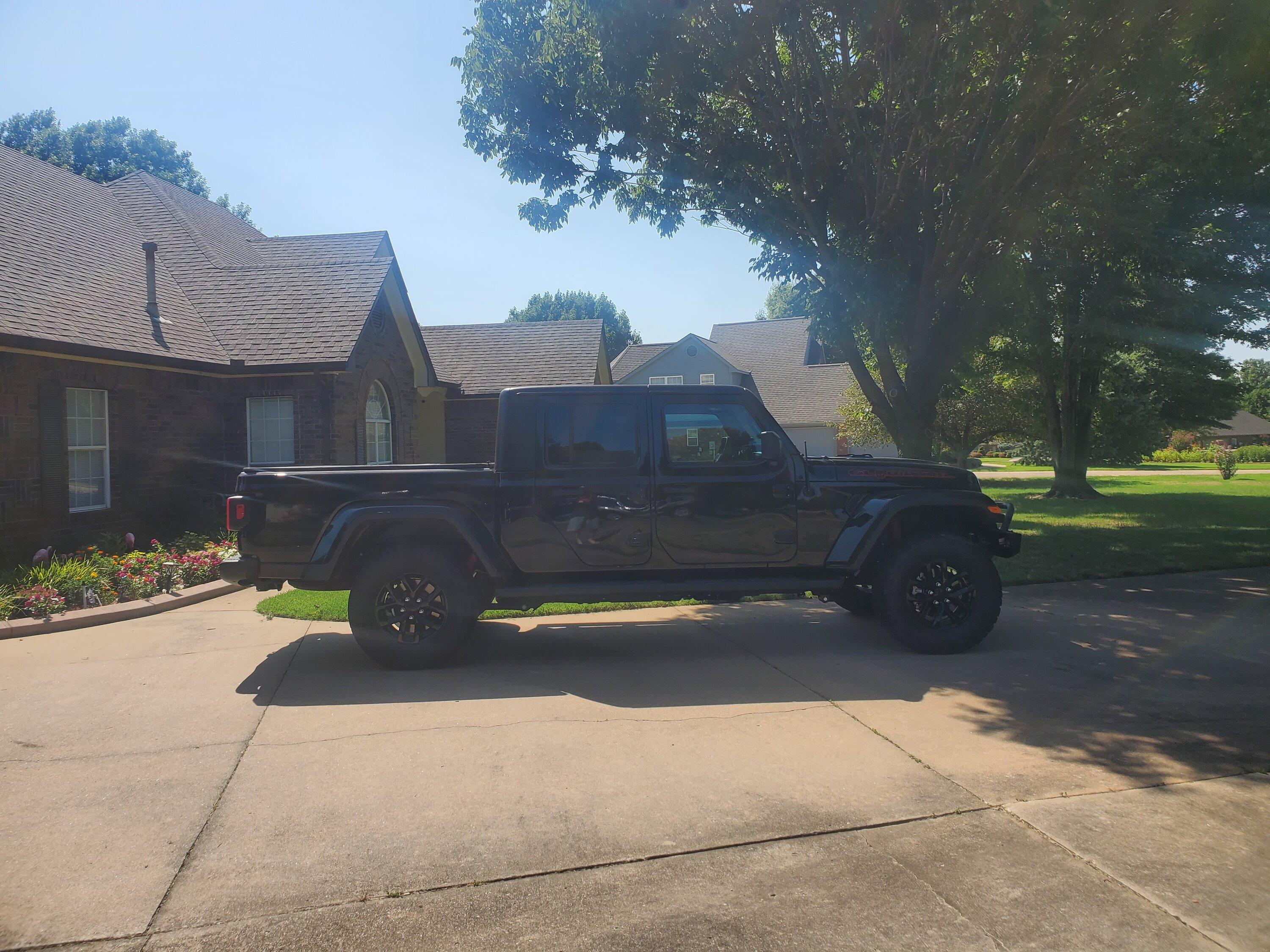

Installed the Rancho kit today I also used a 1/2 inch spacer thinking that would help with the weight of the steel bumper and winch. Also used the geometry corection brackets. Didn't add the spacer for the rear, just the shocks. sits good I think.

No, I have 33's on the factory Altitude wheels. I felt it was going to be to much of a loss of performance and mpg going to 35's with 3.73 gears.

I agree, looks ridiculous with the all season tires.

So for the rear, did you just add shocks? I am going to install the front Level it kit with a 1/2' spacer as well and want to bring my rear up as well. Thought about the Icon 1 3/8" in spacer, but if I can leave my stock Sport S rear springs and just add new shocks, I would rather do that.

I eventually added a daystar 3/4 rear spacer. It sits with an ever so slight rake. Can't see it well on picture. I really like the whole setup.
