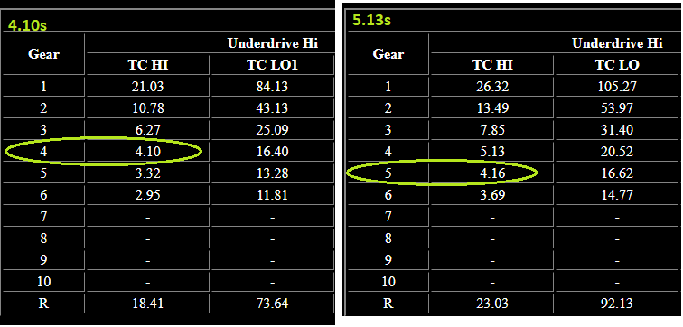

So here's the Sitch:
I currently run a 6MT JTR with 35s and the stock 4.10s. I have 5.13s sitting in the garage waiting to go in. I have analyzed GrimmJeeper's calculator in just about every scenario possible.
Final Drive with stock 4.10s in 4th gear (1:1) is 4.10
Final Drive with 5.13s in 5th gear/OD (0.81) is 4.16
For the sake of comparison's sake, let's say they're exactly the same. Will the truck pull exactly the same in 5th with the new gears as it did in 4th with the old gears, even though it's an OD gear? Will parasitic drag or some other variable make it worse as far as efficiency goes?
Obviously towing is going to be better overall (which is what I'm going for) but I was just wondering about the theory part of it.

I mean, the RPM at speed will be the same between the two. Is that what you're asking? The only way it would "pull" any different is if for a given speed, it were at a different RPM, or if it were a different engine. But with the same engine at the same RPM at the same speed, the output is going to be the same. That's really all gears are; a conversion of RPM to ground speed, so if those things are equal, the expectation should be equal as well. The gear's 'number' is trivial at that point. "OD" only means that you're beyond the 1:1 ratio, so you could gear anything to be or not be "OD".
If you shorten gears, you'll just use more of them as you accelerate, and it's logical that where you used to be in "4th" you'll now be in "5th" for the same results since the gears are now closer together. The advantage isn't 'more power' as much as it is that you have more gears available closer together to keep you in the ideal powerband.

Like I said, the gears have already been purchased and are waiting for install. But I stumbled upon the final drive numbers while looking at Grimm Jeeper for the 500th time and it sparked this theoretical question in my head. I know the gears will be a drastic improvement and make the transmission far more useable to me, but as mentioned above I'm more curious about final drive theory.
4th gear with the old setup (4.10s) and 5th gear with the new setup (5.13s) should be nearly identical as far as engine RPM input into the transmission and wheel speed on the output side of it, but the 5.13 gearing will be ~25% more transmission output shaft speed to achieve this. I'm curious if this affects anything noticeably.

There's no such thing as "being in OD" in this truck. You're either above or below the 1:1 ratio based on the gear you're in and how you're geared. And all that gear number is, it's just a sequential number. You're looking at 5th because it's after 4th, not because 5th has anything special when compared to the other gears. And being on either side doesn't really change anything. So no, it will have no effect.
If you gear it such that today's 5th is equal to yesterday's 4th, then that's pretty straight forward. It will act just like that. The "pull" in the new 5th will equal the "pull" of the old 4th.
"OD" was a thing in the old days because vehicles would often define their top gear of 'final drive' as being 1:1, so when they'd go beyond that, they'd call it "OD" and give you a little switch to enable using that gear for cruising speeds. Not really a thing anymore. Now it's just a convenient way to say which side of the 1:1 ratio that gear is on. Don't sweat it.

Nope. I'm looking at 5th because, mathematically, it ends up close to what 4th used to be. I typically tow in 4th with the current 4.10s and try to stay around 65mph. I can't remember where I heard it, but I seem to remember hearing that the majority of One's towing should be in a 1:1 gear, however, I can't remember where I heard that, what the reasoning even was, nor can I find anything in the OM that corroborates that. Obviously moving to the new gearing isn't going to support that prior (probably incorrect) thinking, unless I want to now run 60mph
That's pretty much what I've settled on. I should be clear, I'm not worried about this being a problem at all. It just got me wondering if spinning the transmission output/driveshaft faster to achieve the essentially the same thing ended up causing any loss of efficiency, or perhaps heat build up in the transmission, or, or, or....
In theory, there probably is a limit to this, but in practice, I assume it doesn't make a noticeable difference in anything.

You can pick nits and say there's a fraction of a fraction of a percent less drag because 1:1 ratio is direct drive in the transmission and it means the input and output shafts are locked together and not going through the cluster and other gears. They'll still be turning, but you won't have the friction of the gear teeth sliding over each other with a load on 2 pairs of gears. No gears would be involved if it was in 4th gear which is your direct drive "gear". Input and output are locked together.
As far as the transmission, the most efficient "gear" for the sake of the friction losses inside the gear box - 1:1 is the least drag from the teeth on the gears sliding under heavy load.
In the case of the 6 speed manual in the Jeep, that's 4th.
You'd need some fine equipment to measure that.
For the engine - already answered - the engine likes to wind up so anything that keeps you from loading it at lower RPM is better. Heat rejection is lower at higher RPM for the same load and road speed (in other words, better for the engine)
