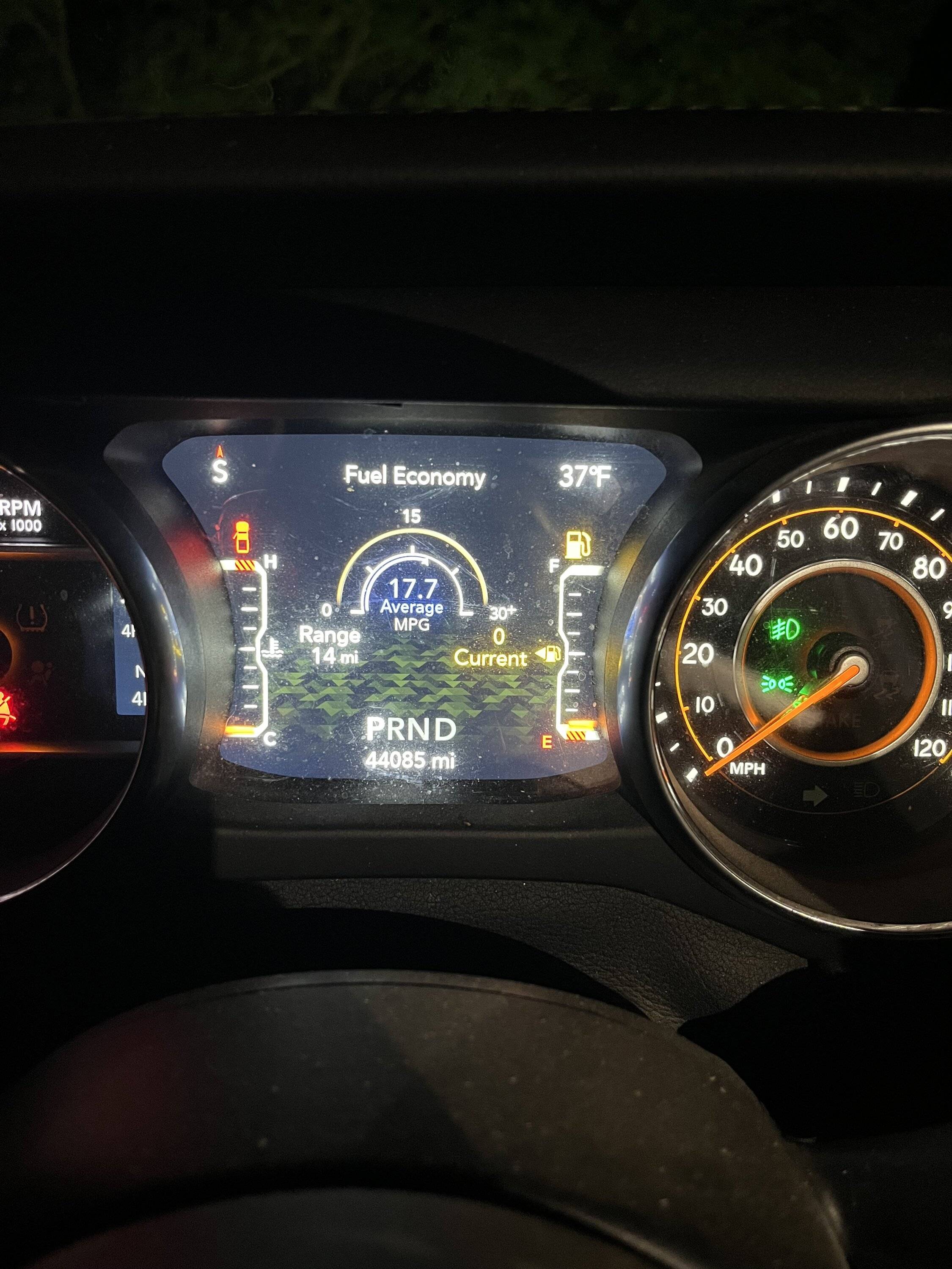

I just checked mine that has 35s with 3.73. I’m getting 17.7 according to the dash. Very little highway driving though.

I just checked mine. I’m getting 17.7 according to the dash. Very little highway driving though.
Get on the highway and it would likely drop because the drag is going to be more noticeable with the lack of available torque.
