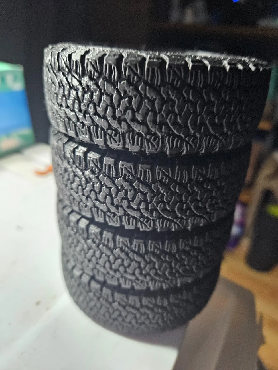

And with that said I still can Bark the tires at take off, And with that I 3D printed KO'2 for a Koozie..
