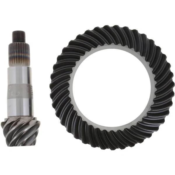

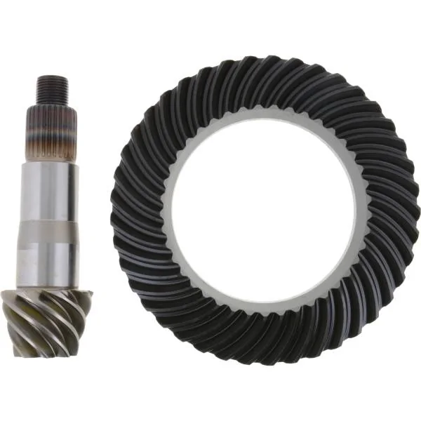

A Dana 44 is not a Dana 44. The old school dana 44 vs a jk dana 44 (and pro-rock/currie) vs an advantek dana 44 are all different ring and pinion sizes. The advantek dana 44 has a much larger pinion than the jk gear sets and the pinion for 4.88 and 5.13 has the same amount of teeth just the number of teeth on the ring change and the pinion gets a little smaller but the contact area does not decrease as dramatically as it does in previous gens.
If they're using advantek axles, then its the driver's. If they're breaking 5.13's they're breaking 4.88's too. Most likely if you have no issues with 4.88's you'd be fine on 5.13's as well.
Here is an advantek 4.88 vs a 5.13 both are 8 tooth pinions (even the 5.38 is an 8 tooth shockingly).
I noticed the gears are a different rotation? Maybe just a reverse image on one?
