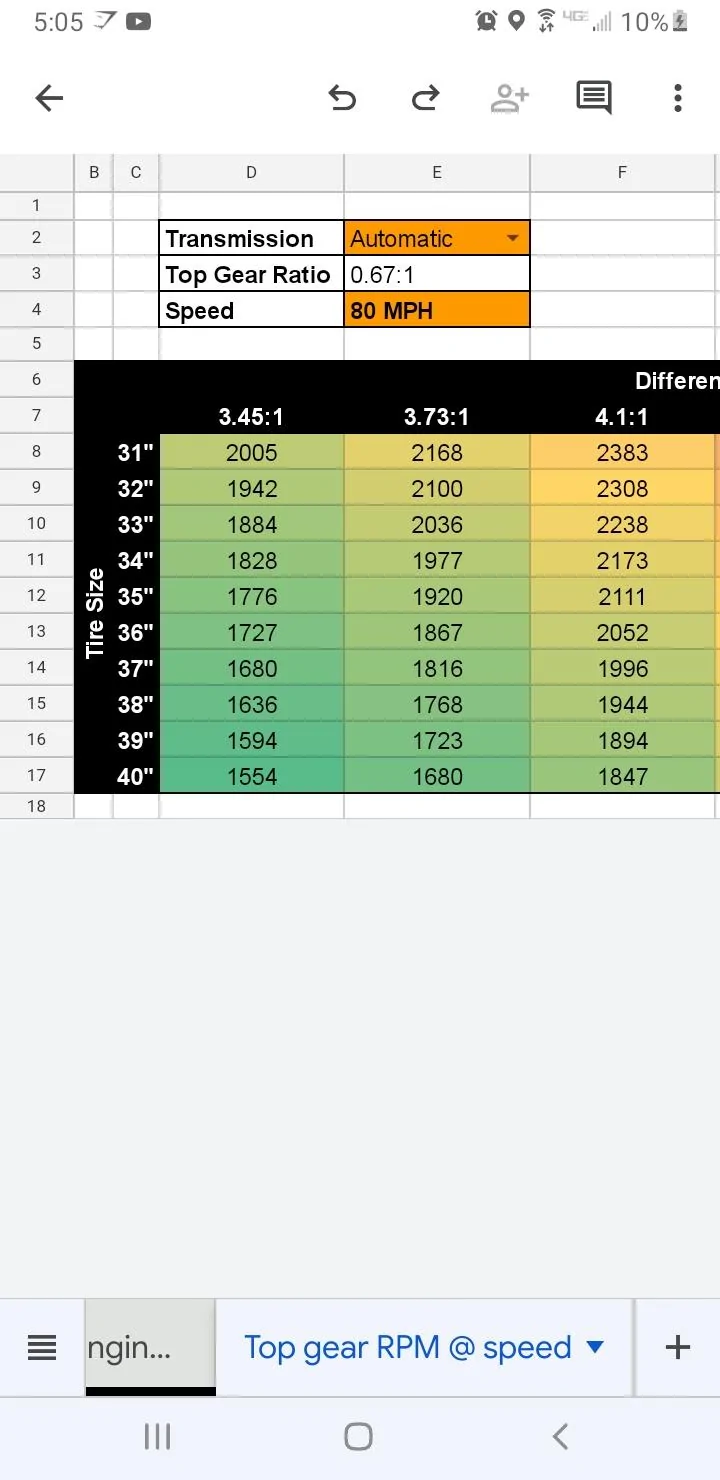

The calculator doesn't lie
Jeep Gladiator To Re-gear or Not to Re-gear Screenshot_20220221-170540_Sheets
