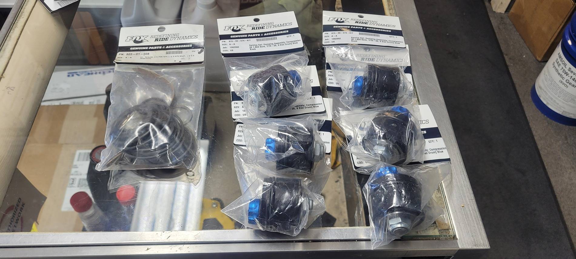

You would be the perfect candidate for the 2.0 if you aren't going to get them warm! The problem is that Fox does not offer the resi with CD clicker for the JT's and they are even discontinuing them for many other applications. I have been just stocking the CD clicker and adding to the resi's for those who want them.
Working on a heavy custom 4x4 Sprinter 3500 setup this week with 2.5 Elite rears and dual 2.0 resi's up front because space doesn't allow a the 2.5's diameter, but the client needs the service interval to make it at least a year?
