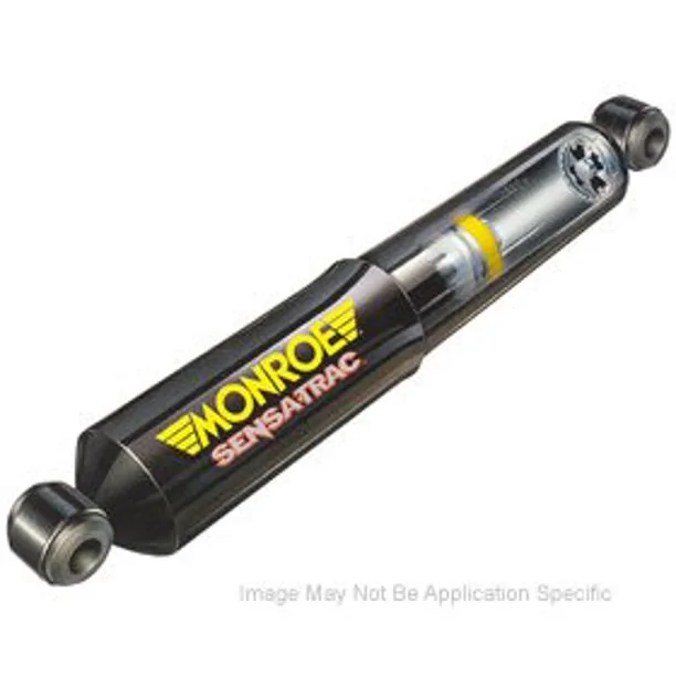

From Monroe:
"Unique precision tapered grooves in the pressure tube perform like an additional stage of valving for optimum ride tuning"
This is exactly what I imagined. I don't know the dynamic in relation to ride quality. Would it be a little more cushiony unlike a sub-1 setting where you can still feel the aggressive nature of the valving only mitigated by more access to the air charge, or would it produce a real progressive dampening? Hmm...
They are definitely wobbly in my opinion. I remeber the hype in the mid 90s when they came out. I had a coworker that sold the shit out of them for Ford Exploders, but I felt they were just too soft for the twisty roads we have in our area.
Not too long ago I razzed the Rancho guy on here about combining a RX9000 with a SensaTrac to make an adjustable bypass shock.
Its just a position sensitive bleed and would be dependent on the piston riding in the right location of the body groove. To do this, you give up some control in that zone.
This is where the SDi's really shine, but at a larger price tag.

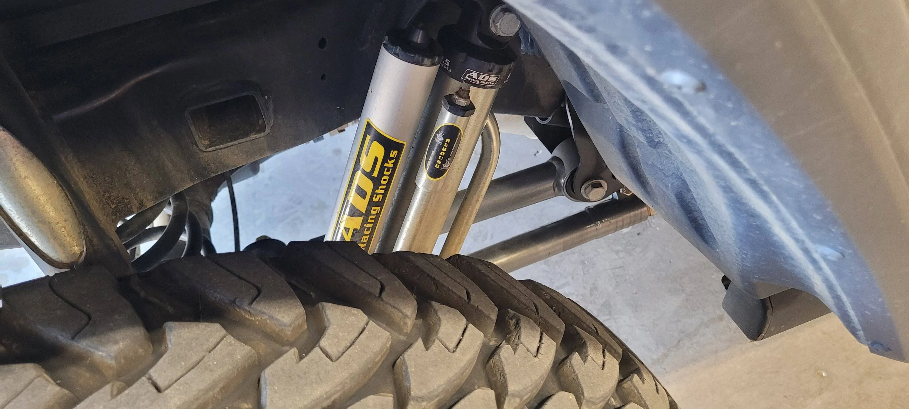

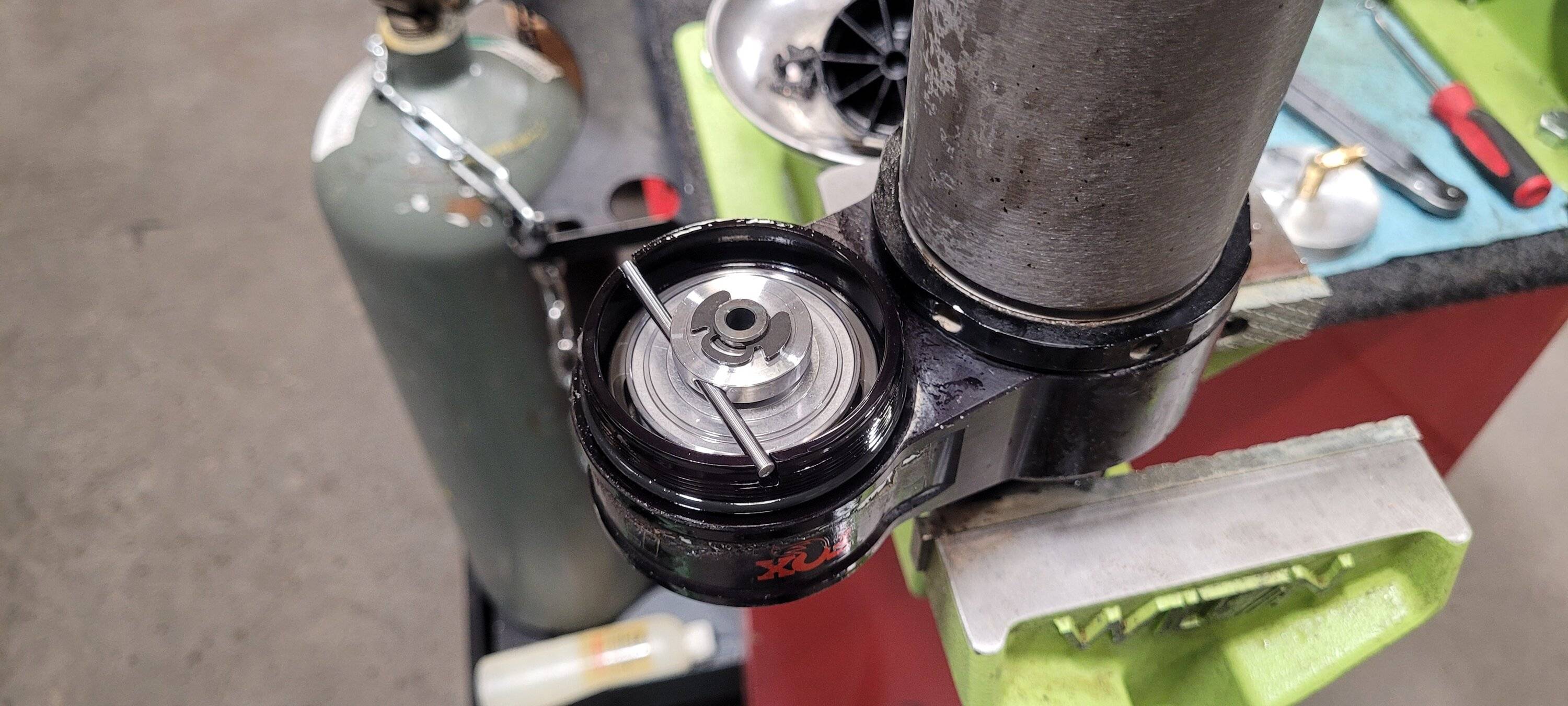

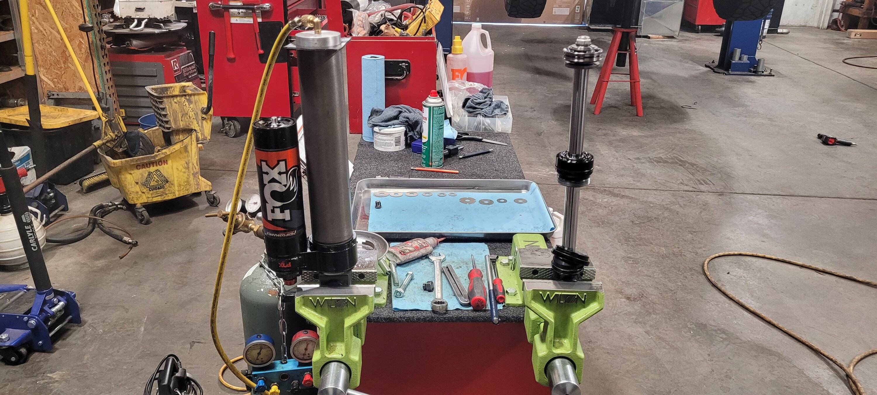

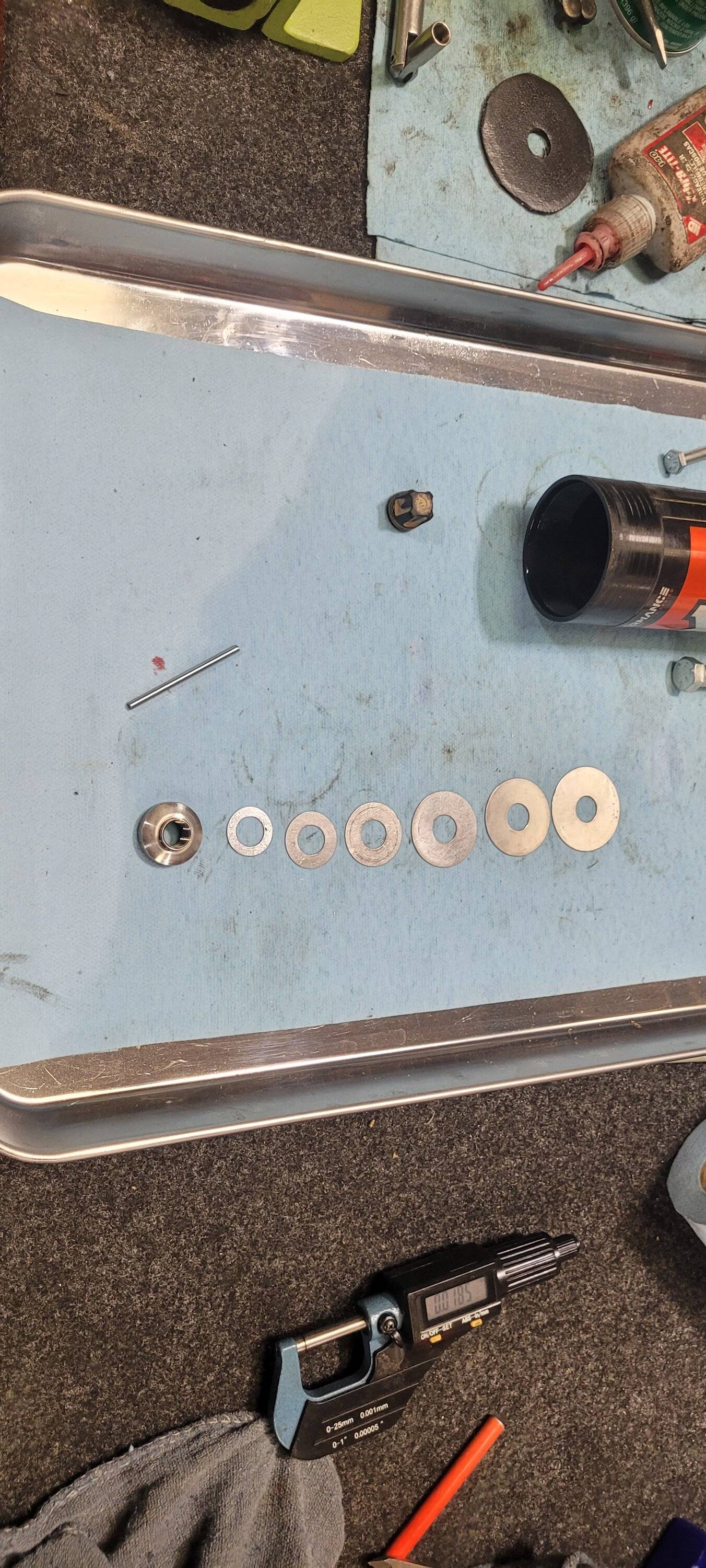

Fox shock tuning updates:
It's been a while since I have done any work with the Fox 2.5's since I have been devoted most of my time perfecting tuning for the @SuspensionDirect E-Cliks, BUT.......... I had sent off my ECM and touch screen to SDi for some updates and "secret squirrel" upgrades, so I took this opportunity to swap the Fox's back on and test for valving changes with @Clayton Off Road 's more recently released HD rear springs that are right at 10% firmer than the original SD offering.
We were taking a 5300 mile dual sport loop with the 19FBS GeoPro RV in tow heading north out of CA beginning with North Cascades National Park, Glacier National Park, Theodore Roosevelt National Park, Sturgis, Devil's Tower, Mt Rushmore, Crazy Horse, Wounded Knee, Badlands, Minuteman Missile Silos, Pikes Peak, San Rafael Swell, and a bunch of other historical/scenic stops along the way. Perfect time to do some testing taking notes along the way so that I could make those changes when we return........
First on the agenda was to reduce the high speed damping! I had noted since install the 38" Ridge Grappys that the small rough chop on paved roads was a bit on the much side as the tire pressure grew. I also have noted that these tires seem to increase in pressure throughout the day more than any other tire I have run in the past. Then combine that there is a strange resonance when you thump these tires with your fist or other hard object that was not there with my Cooper STT's or other client tires like Micky Thompsons or Toyo MT's. With the OE Falcon 33's, M/T 35's, and Cooper STT 37's the high speed seemed fine, but the jump to 38's just wrecked things and I found myself wanting to drop tire pressure mid day to gain some comfort.
I had noted that I was running the high speed clicker all the way loose F/R and I had already mellowed out the high speed valve stack on the piston inside the shock, so the obvious choice was to make a change to the valve stack in the bridge in attempting to get that high speed clicker more toward the center of adjustment in the front shocks and toward the bottom with the rears leaving headroom for loads in the bed and trailer tongue weight. I also noted that the rebound needed work becuse of the increased spring rate since I had tuned these for the original lighter Clayton rear springs.
These shocks now have right at 30K miles on them with some spirited dual sport driving! The oil was more of a purple color than the original translucent cherry red. No seals were leaking, so I just replaced the piston wear bands and added new oil while I was making the changes.
Overall I was pretty happy with the performance as it was, but I know it could be better! I really did however miss the E-Cliks! Being able to dial out porpoise and wiggling from the midwest winds would have been super nice on this trip especially since were were right at the ragged edge of overloaded! When we left home I rolled over the scales and were were right at 12,000lb GCVW and over on the RAWR, so I immediately dropped some water, moved some weight around, adjusted the weight distbition hitch, and added air to the rear tires for an amazing improvement in driveablity.
Spent the entire day at the shop doing maintanace like tire rotation/balance and the shock work today. It was a treat as I had started a quick temp install of a 5ton package A/C unit as a test to see if that would be enough to dry out the air and cool it enough to be better than the two evap coolers I have used over the past 20 years there. It was only 95 today and humid for our area, but it was 76-78° and pretty dry inside the shop! I hope it will work better with proper air distribution and air tight ducting.
So unloaded my settings ended up Front: 5 low speed/6 high speed Rear: 1 low speed/2 high speed I'd say that's a wrap on the compression! I'm going to do more testing off road to see how the rebound works and I also made a change in the bleed in the rear. See if I went too far OR if it's perfect........ I'll update ya!
