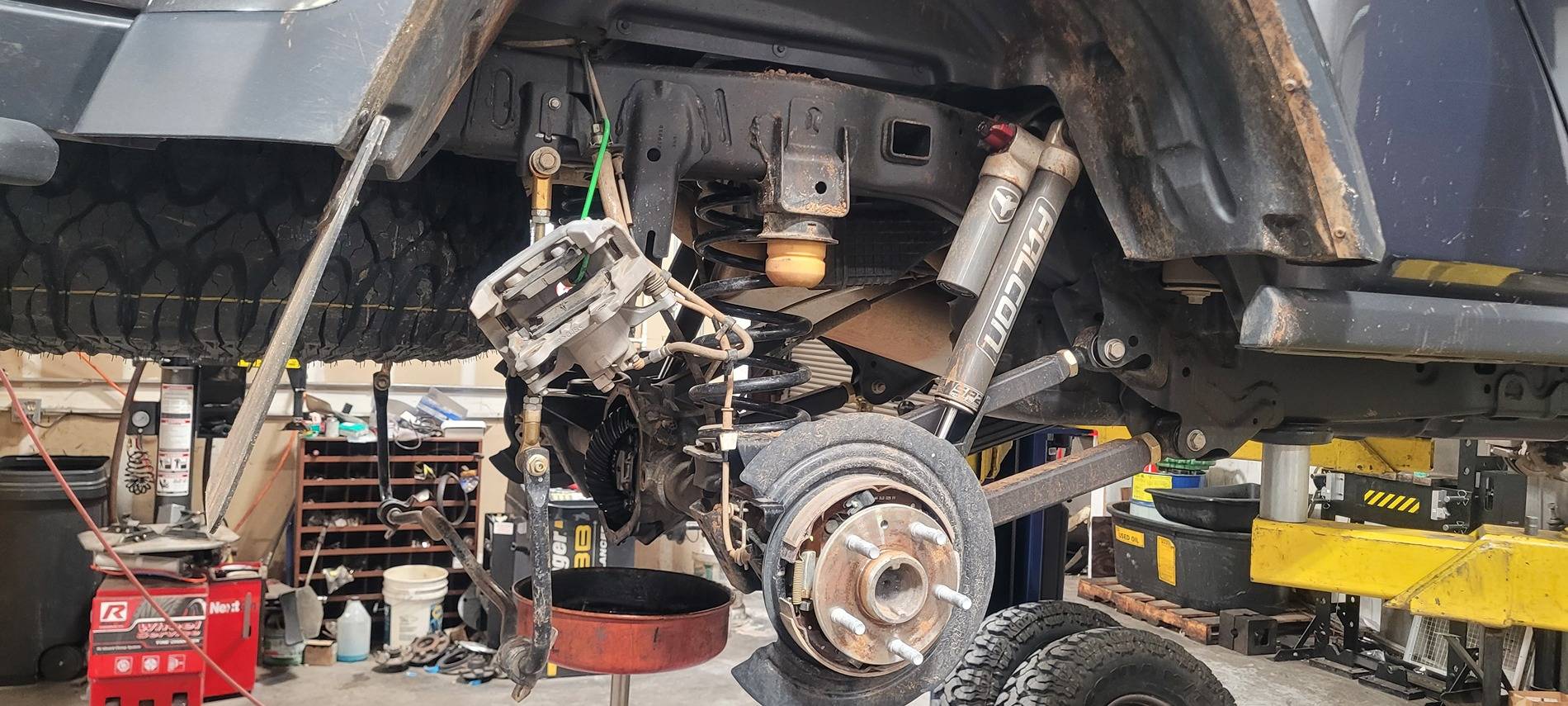

What do we have here.....Hmmm
A local on a Clayton suspension and Falcon SP2s who is unhappy with the ride/rocking?
This could be a good thing for a lot of people IF we can work together on this project?

But Clayton and Falcon are the pinnacle of design......
I know you are joking? ;)
Yes, I do feel they are both a high quality product, but I also feel they don't play well together? It's all a matter of getting the shocks tuned for the higher than average ride frequency the heavy Clayton springs deliver.
After all......Shocks/dampers are just frequency changers?

Just being a smart ass, cause the general consensus is just do a clayton lift and slap on some falcons and all is right in the world. I am glad you are looking at this in detail and seeing issues.

I do like me some Clayton spring rates for hauling loads! I wouldn't say the suspension kit itself is revolutionary, but it is top tier where the components are concerned. This is why I have chosen Clayton over everything else on the market.
I could use MC, Evo, or any of the other quality components combined with Clayton springs to get a great result though.

This guy told me he did all the research and this is the package he came up with as "The Best". I have done work for him in the past, but he didn't come to me for this job....Maybe because Clayton never added me to the dealer locator. They have pretty much zero presence up here in NorCal....I sent them an email this morning hoping to get added?
I feel bad because I could have set him up right out of the gate with a badass package without having to pay twice.

I haven't done anything to the truck yet in regards to the suspension. It's here for a gear swap, but he mentioned at check in that his wife wasn't happy with the rocking on the highway.
I noted on the roadtest how rough it felt on the small square edged bumps and the rebound was a bit lacking, but the rocking wasn't as bad as I expected. The shocks are all set to #1 (soft) so I know there is improvement in the rocking to be had, but the question will be how much rougher it will make the small bump comfort/compliance?
When it hits the ground, I will try other settings and see if I can come up with a middle ground. If not, maybe we pull them apart and work some magic?
