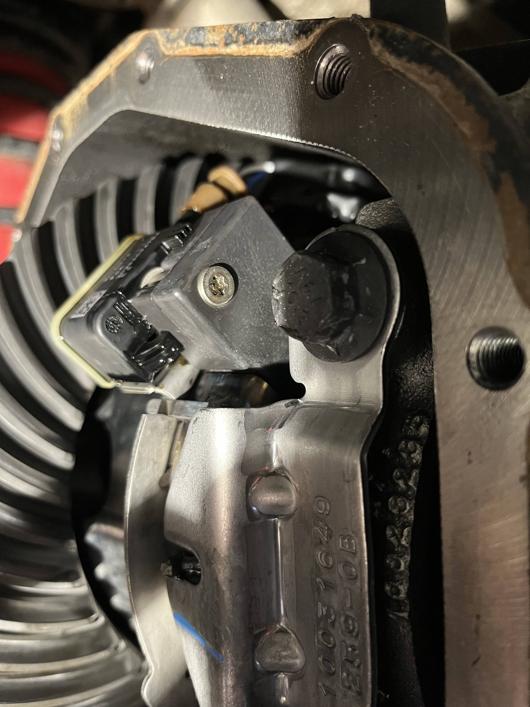

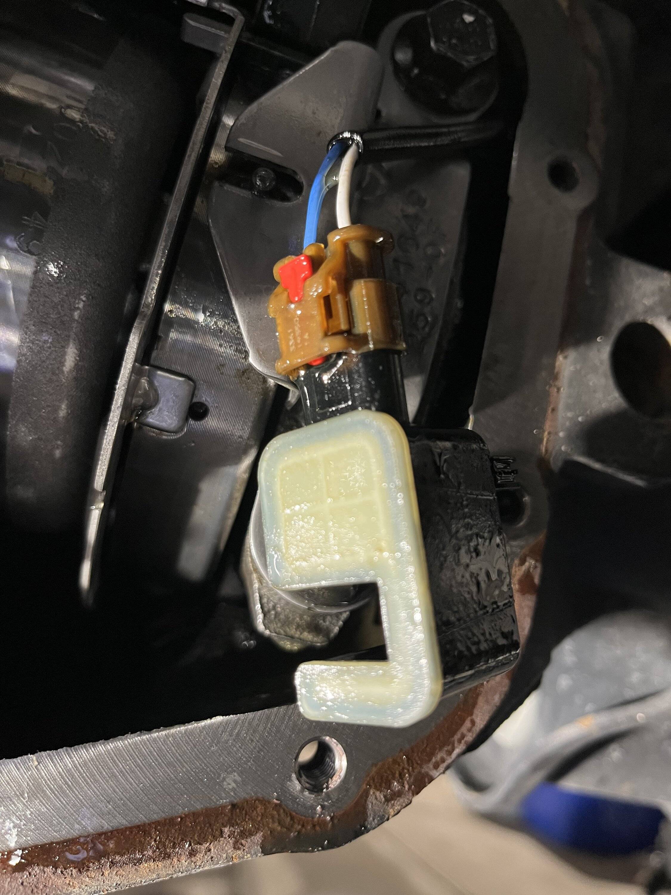

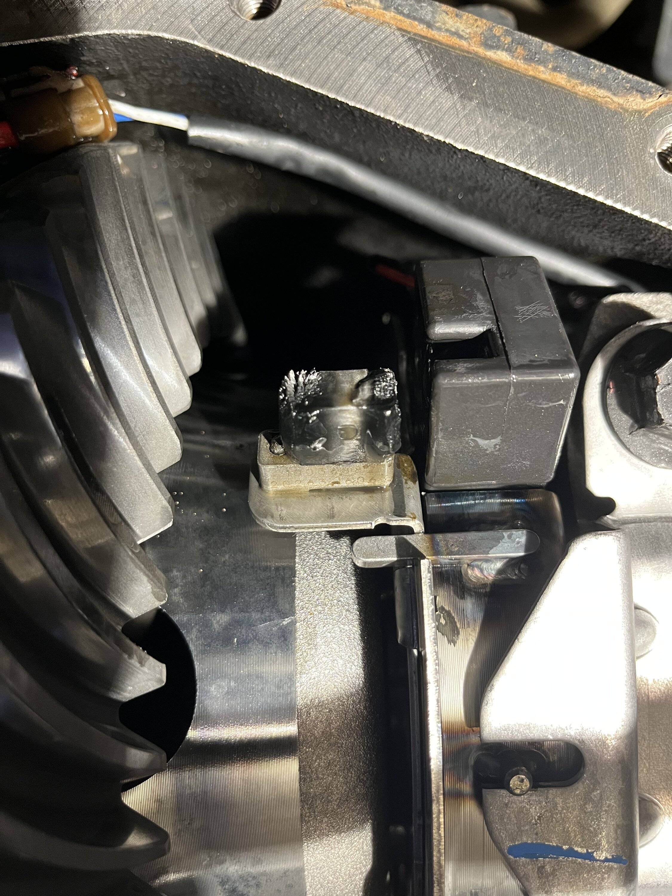

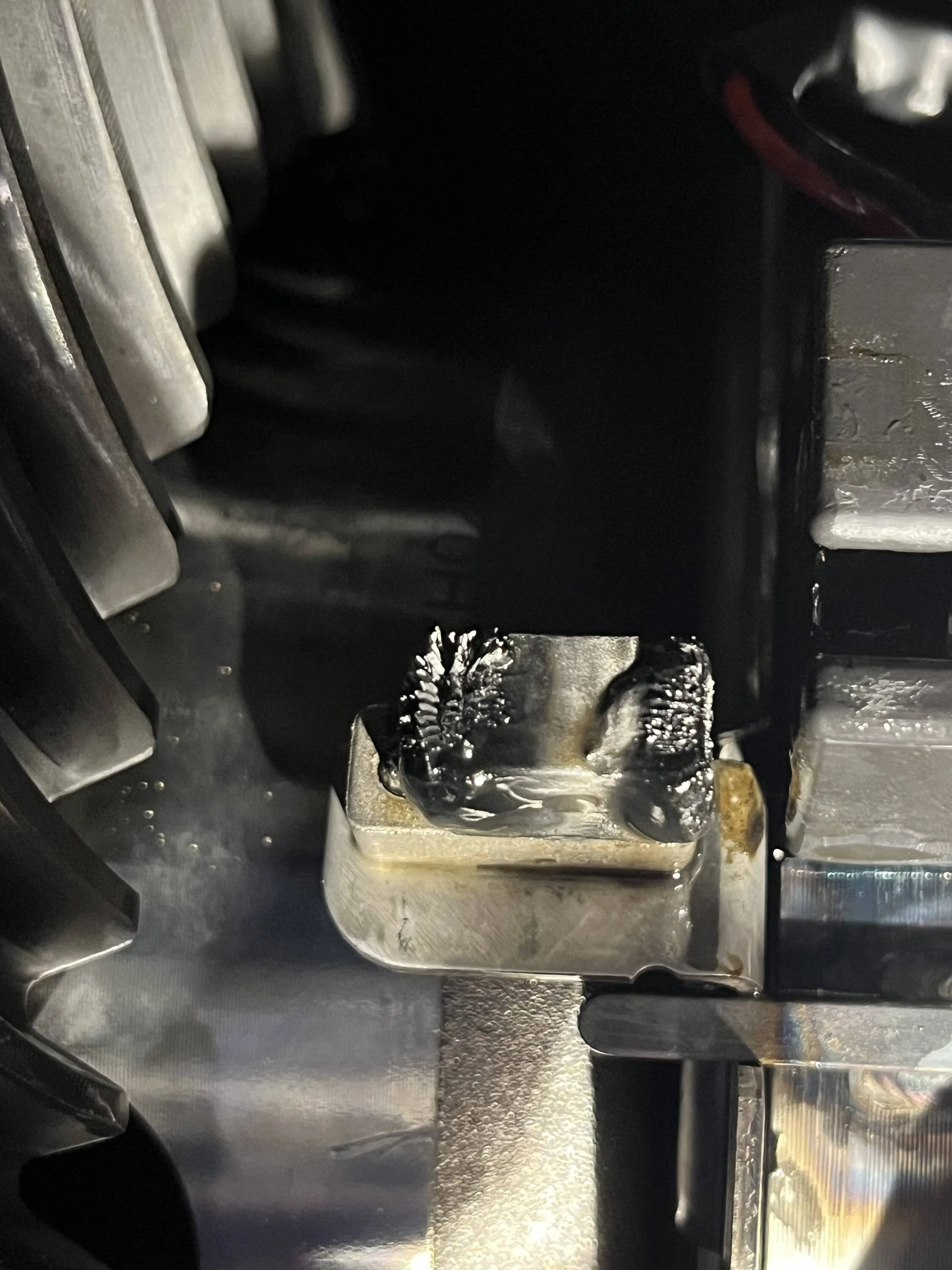

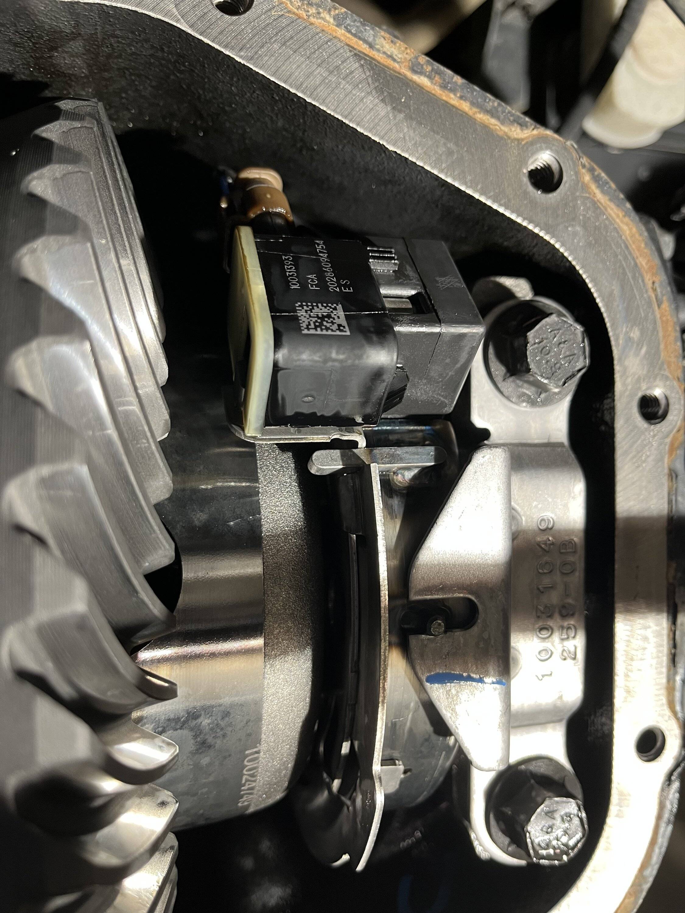

Not normal. If this was mine I’d take off the diff cover (gasket is reusable)unplug the locker sensor, undo the single Torx screw holding it in, then gently lift the sensor off the magnet. Inspect it, maybe pull off any magnetic debris stuck to it. Spray out the diff with brake cleaner and reinstall it all back.
It would also be a good time to see if the locker sensor has any diff fluid in it. Warranty replace it.

I don’t have excessive play but what I did have was a long delay in locker engagement and disengagement. At times the dash light for the lockers would blink so long it would quit and I’d have to try again.
After I cleaned the locker sensor magnet, engagement and disengagement happened on the 3rd blink of the dash light.

Your sensor magnet most likely has some good magnetic debris clogging it up. Does your diff have a drain plug? My 21 JTR does and when I pulled that some time ago the drain plug magnet had a good mound of stuff on it. That would tell you the locker sensor magnet would at least have the same thing.
