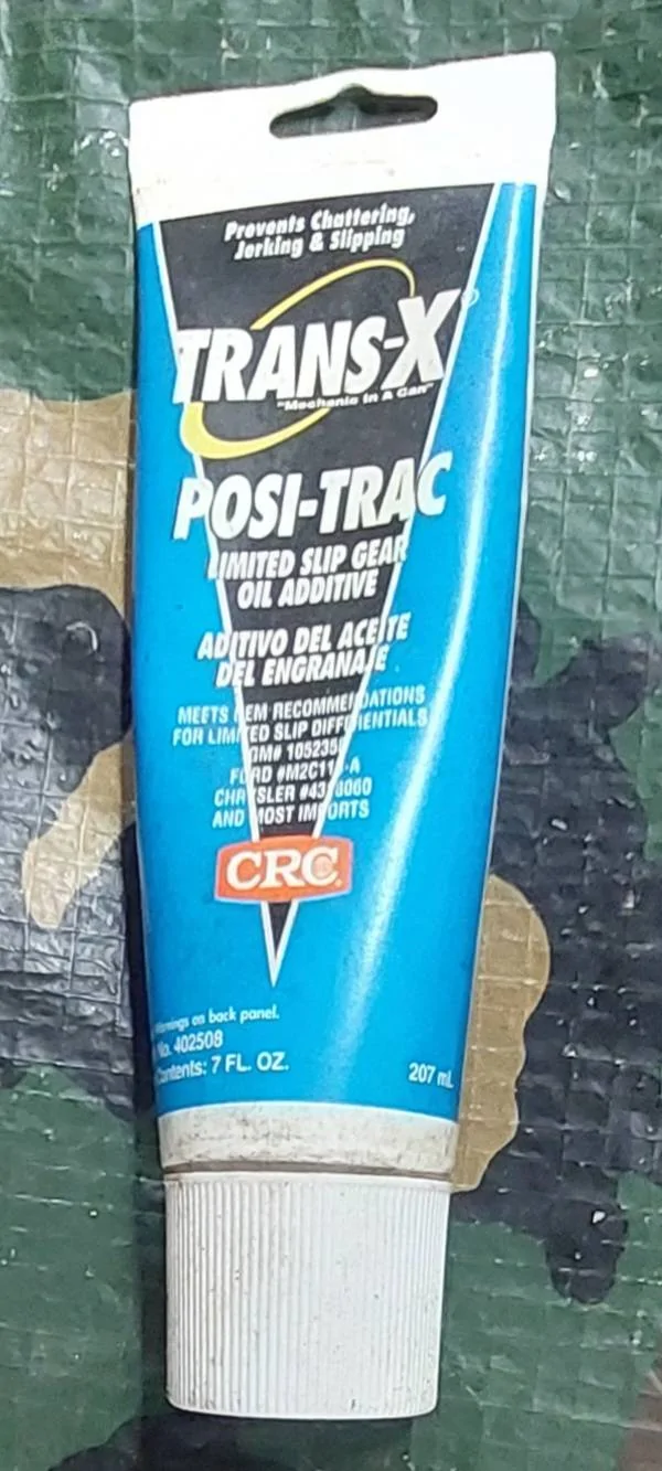

Now, on the Trac-Loc, I've got a few axles with them. I have always added Limited Slip additive when a change of gear oil. In my "older generation D-44s" and a D-35 now what does this have to do with anything well one in in 1990 XJ and #2 is in 05 LJ both still functional as Limited Slip between them there is close to or over 400,000 miles on them. This is the "Stuff" I've been using since 90s in Trac-Loc equipped axles. Is it the best I don't know or say it is. 🤔 :like:
I always try to have a tube on hand.
I’m gonna default and say get the Mopar stuff. You can get it cheap on Amazon. In the manual I sent you, it should have a spec or requirement for the friction modifier to meet.

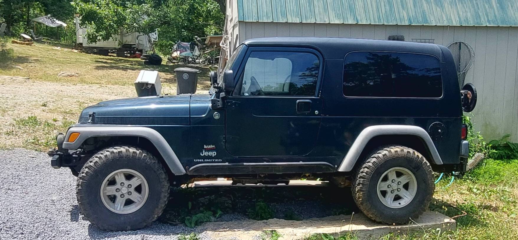

You must now share a obligatory picture of your LJ
:like:
Jeep Gladiator Rear Axle Question 20240625_120229
Since it wouldn't be fair to my other Trac-Loc equipped Jeep I figured it needed to be here too.

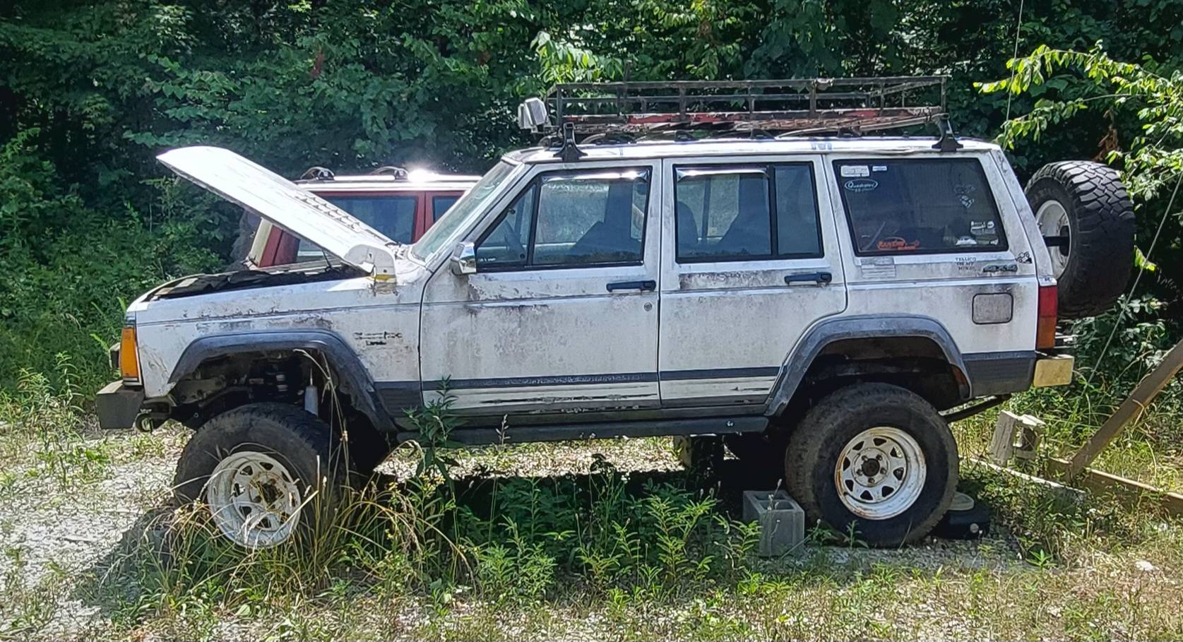

Jeep Gladiator Rear Axle Question 20240625_120411
Sadly it needs to much to probably put back on road, with some work it could be a trailer queen to trails at least.
Oh the 91 XJ behind it has 3-4 in lift and setting slightly higher up the hillside.
