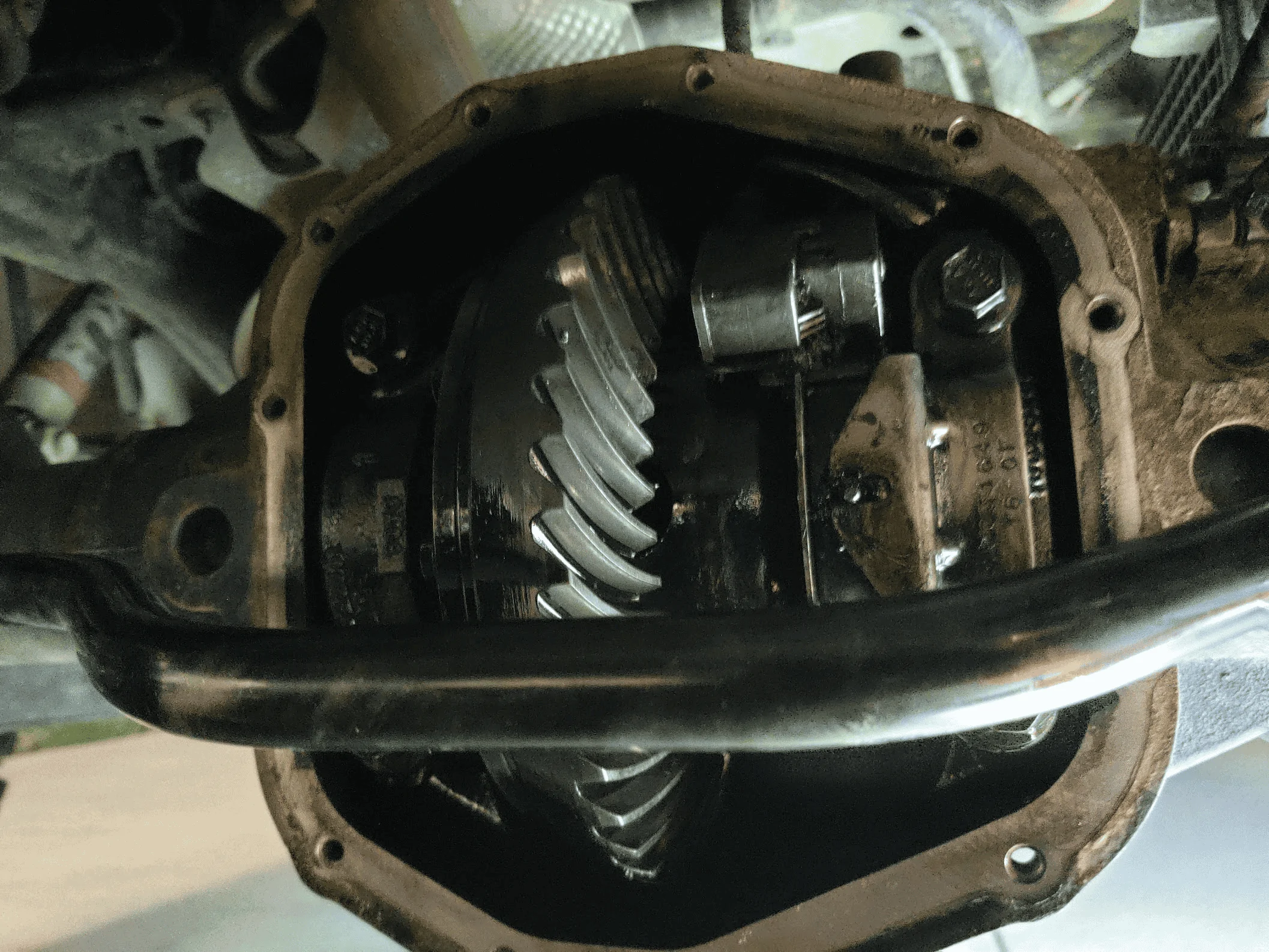

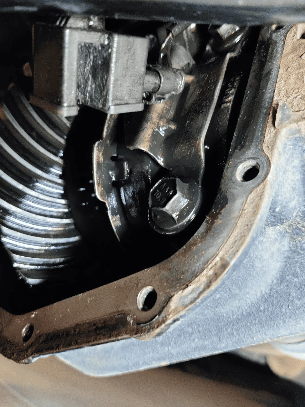

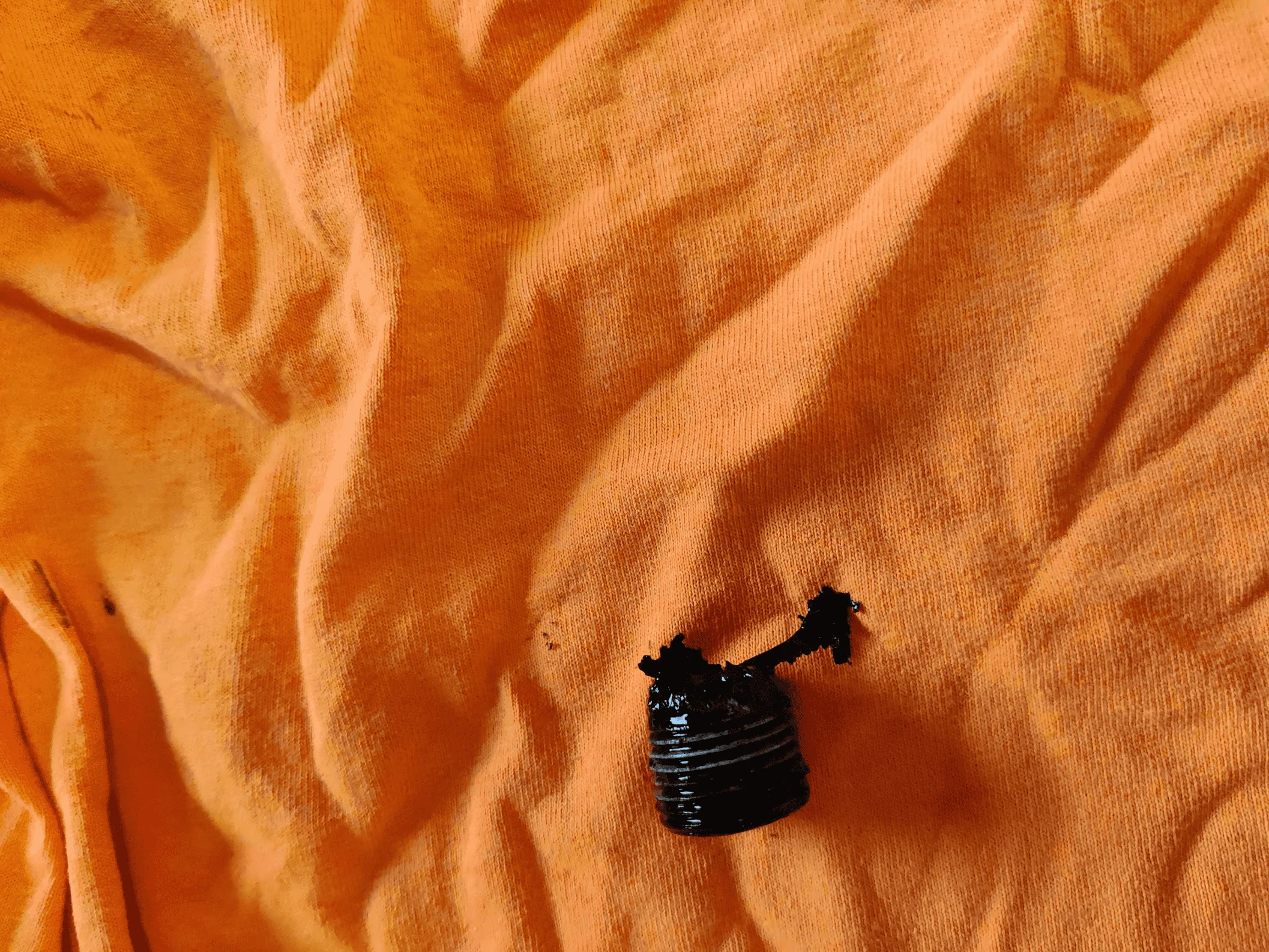

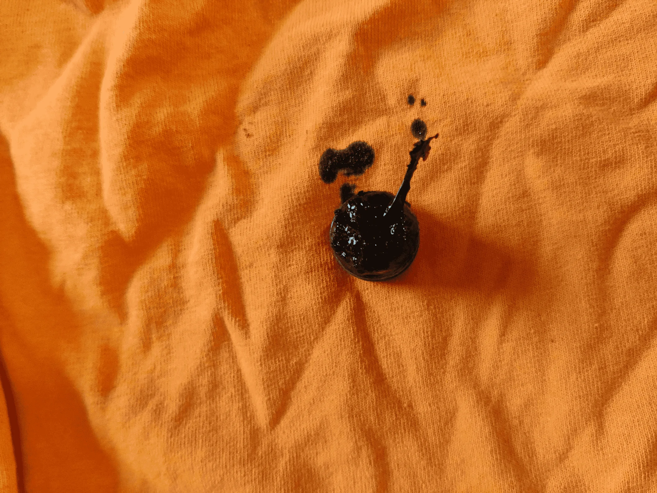

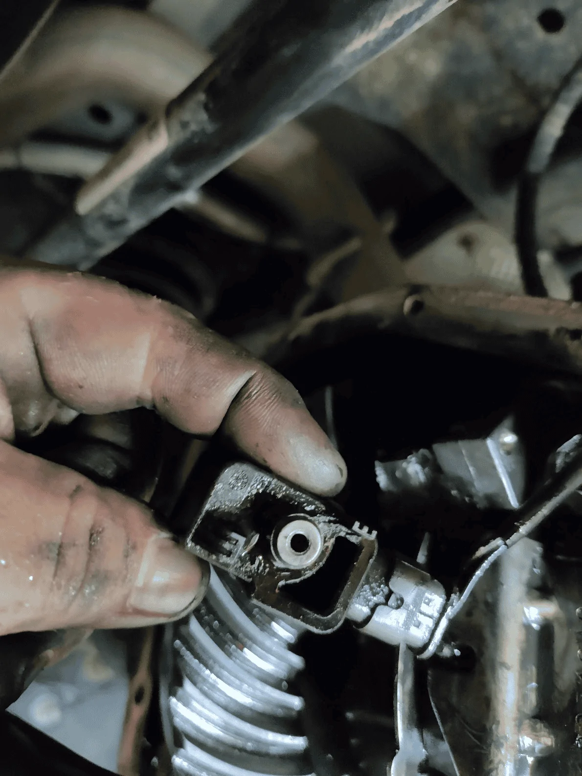

I removed the cover and looked at the sensor earlier and couldn't tell whether the sensor is the problem or not looking at it. I could not get the connector to come loose so the picture I took is with it hanging by the cable. After putting everything back together I tried it again and it still doesn't work. I was hoping the problem would go away once I wiped everything off and replaced the gear oil.

You may have already done this; do you have a way to verify that the elocker is getting current?
I hope you get this figured out and solved. I thought there was a way to have the steelership flash your Jeep, so that the early gladiator models could engage their rear locker in 4hi ( like the Mojaves can for sand-mode ). I could swear that I’ve seen that in the posts, when trying to figure out how to engage mine in 4hi. I would assume that the rear diff is the same in a Rubi & Mojave.

You do seem to have a little more cruft on your drain plug than I’ve seen on the rear of my Mojave. There’s no clutches in there ( I think ) so that amount seems kind of high. I changed the diff fluid in mine early and often to start off, as well as my wife’s HA ( lsd rear end ). Even in her rear diff, there wasn’t that much dark/magnetic matter. We have approximately 40k each on ours, and I’ve changed her rear diff fluid twice now. Mine seemed really clean ( just nasty diff oil ), with little to no debris.
think, at any point, that rear diff might have gotten hot? Your original post said that you’re unsure if the service history, how many miles are on it?

69k miles and I am not sure if the fluids were ever changed before last night. I will change the front soon and take a look at it.
Dude, that sensor is looking packed in with nasty magnetic gunk. When you pulled off the sensor, did you notice the magnet there under the sensor and cleaned it off?
