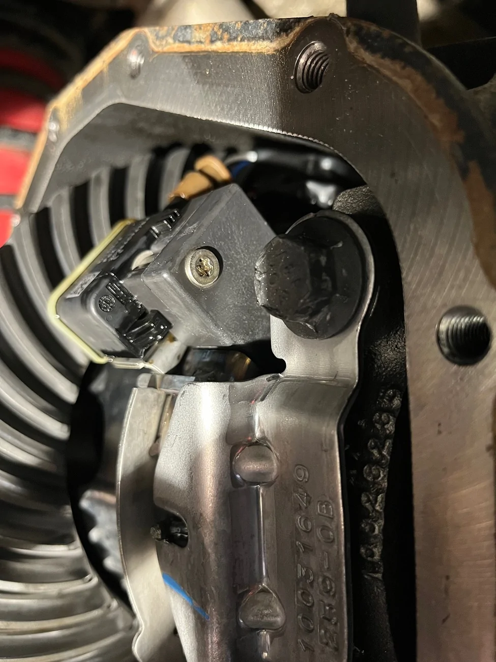

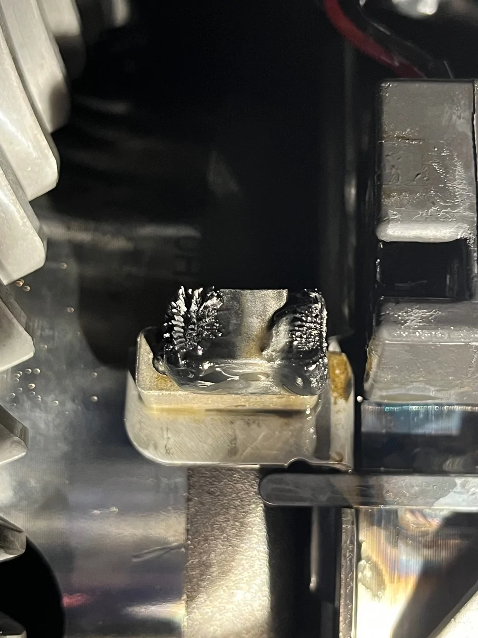

Dude, that sensor is looking packed in with nasty magnetic gunk. When you pulled off the sensor, did you notice the magnet there under the sensor and cleaned it off?
yes i cleaned both off but could have done a better job I am sure. How do you all go about cleaning the magnet and sensor? I have not worked on vehicles enough to have the knowledge of what to do and not cause a bigger problem and my buddy said to avoid using brake clean on anything inside the housing. I only cleaned the cover with brake clean and wiped everything else down
I did this late last night and kinda rushed the job

I’ve always sprayed liberally and let it gas off before filling. I stay away from spraying any electrical connections (there’s separate cleaner for those and just rag wipe the magnet off. Q-Tips work good for wiping out the nicks and crannies of the sensor. Having a look at the crud you showed, is it possible some of it has breached the electrical connection and there’s some sort of short in there?? Maybe.

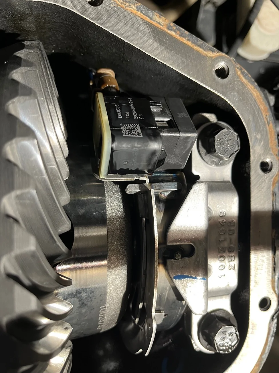

I took another look at the sensor and cleaned it with contact cleaner and it is definitely full of oil
The zautomotive cable is a fix correct? I do not need to replace the sensor for it to work again?

If the sensor is full of lube. It's shot. It shorted out.
Brake cleaner and plastic does not play well together. Your sensor is plastic. So is the front pinion bearing retainer. A few guys on the Power Wagon forum had to replace the whole locker assy before of them using brake cleaner. To replace the sensor on a PW. You have to replace the whole carrier assy. That was a hard lesson to learn.

I didn't use brake cleaner on the sensor. I use electrical contact cleaner. I used brake cleaner on the cover only.
