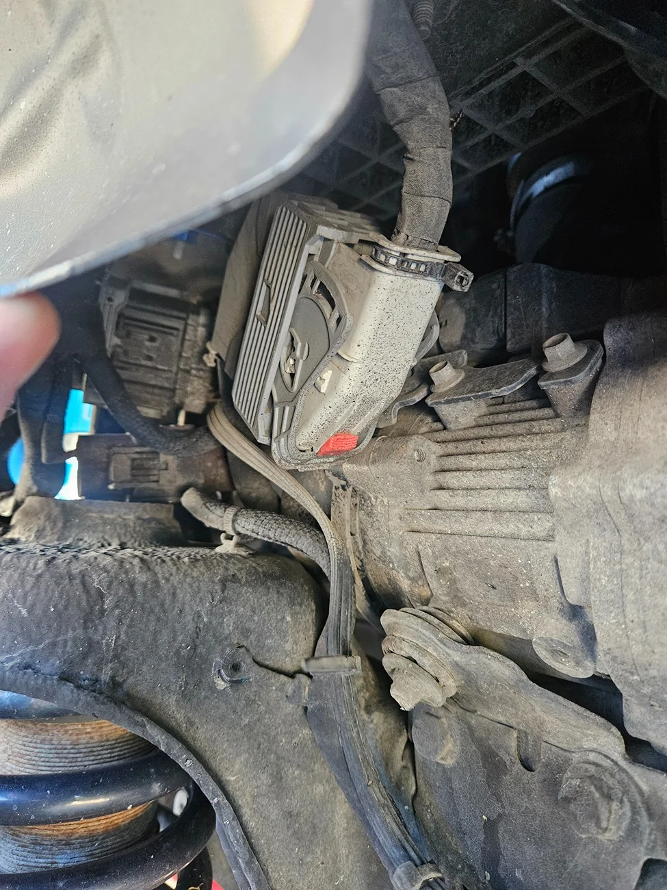

This is what my plug looks like. Looks different from the other ones posted.

@Rusty PW
You're looking at the wrong connector. On JTs with the 3.6L you'd be looking in the right spot, but on JTs with the 3.0L the pump is rotated 90° so the connector is located on top, not on the outboard side facing the wheel well.

@Rusty PW
Ok........so when I get another chance. I'll have another look see.

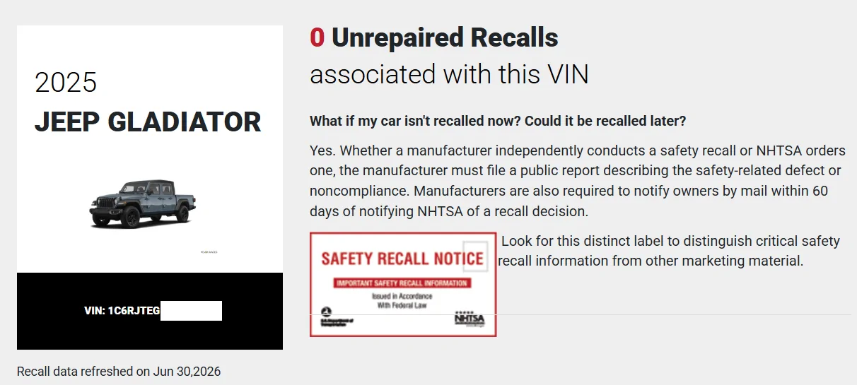

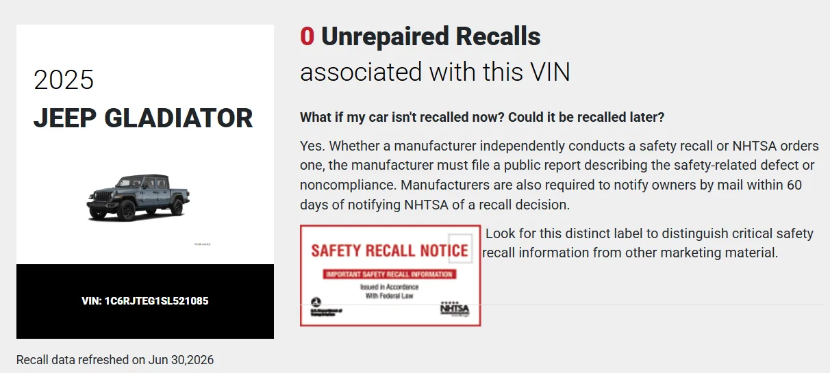

40,514
54,044
Still clear for both of ours - can relax and not worry about fires.
