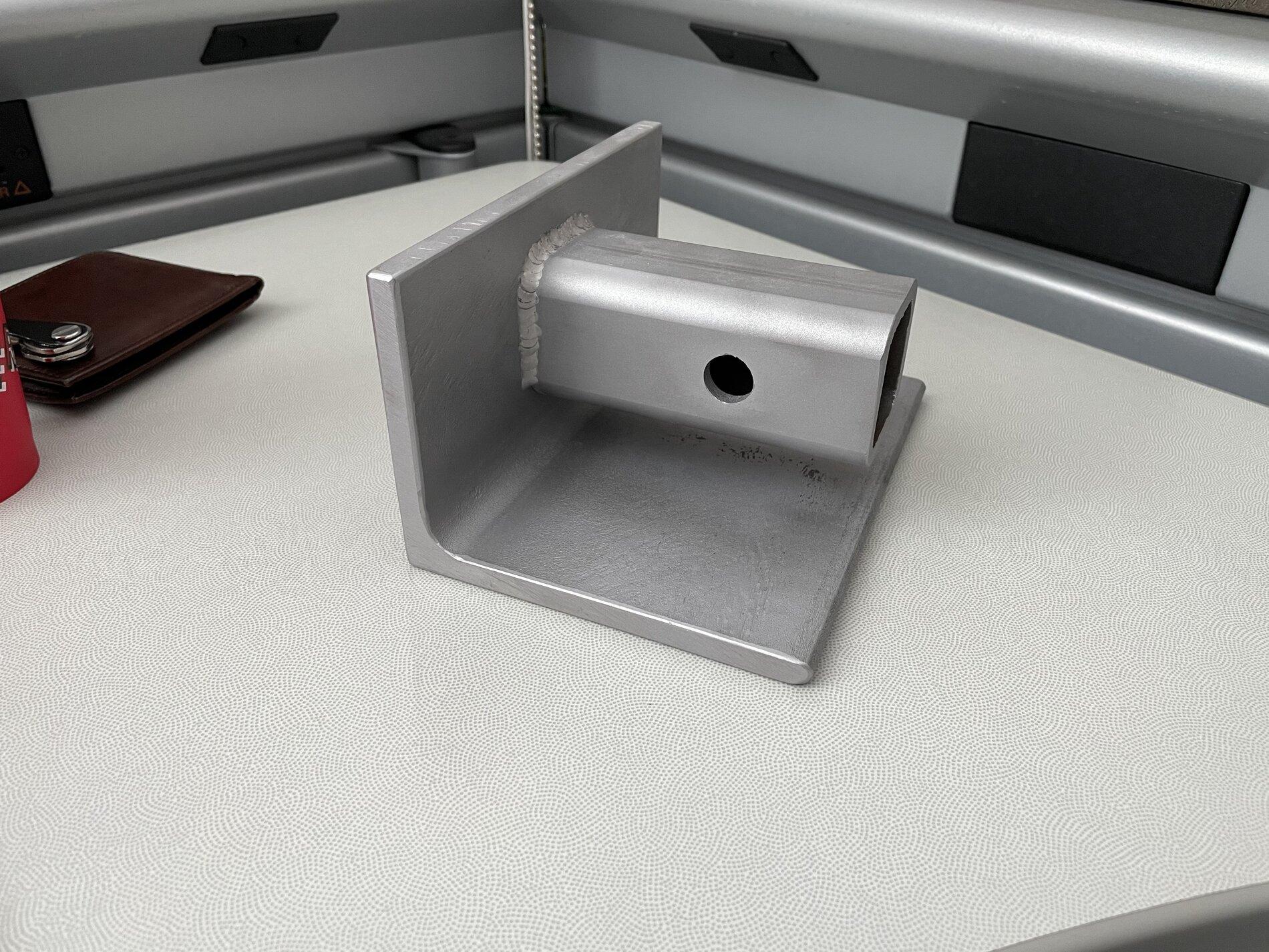

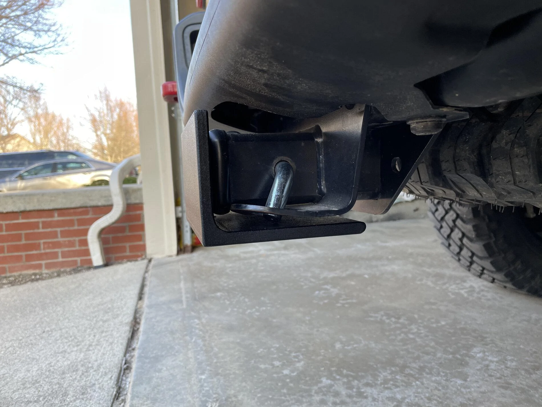

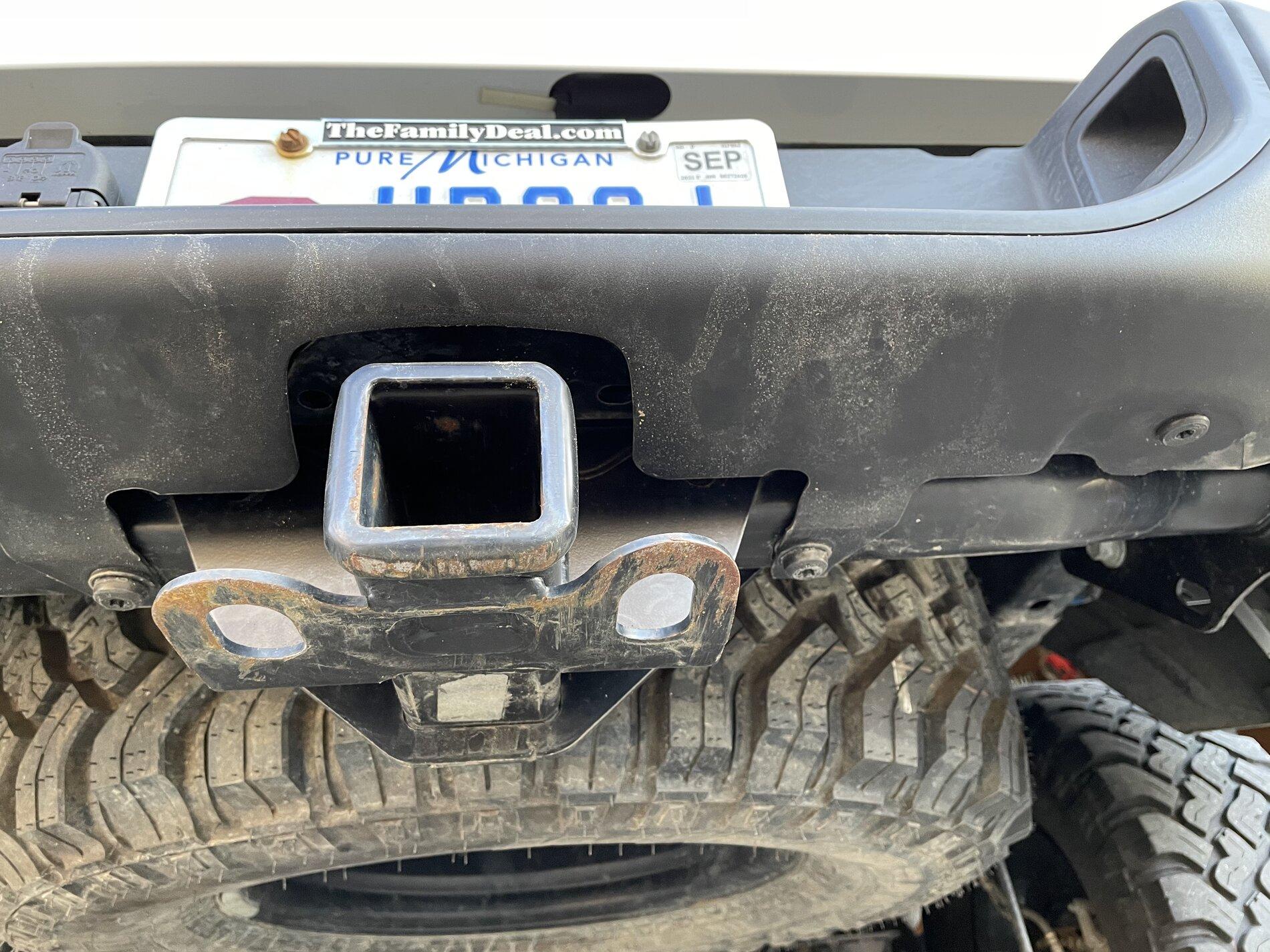

As most know, one of the inherent flaws in the JT is the departure angle. On mild trails, I have no issue with it, but as soon as you start adding in drop offs and sharp elevation changes, my Gladiator loved to smack the receiver. It had gotten to the point where the breakaway chain tabs had started to bend and since I use my JT for towing, I did not want to risk damaging or weakening the receiver itself.
Jeep Gladiator Receiver Hitch Skid IMG_1598

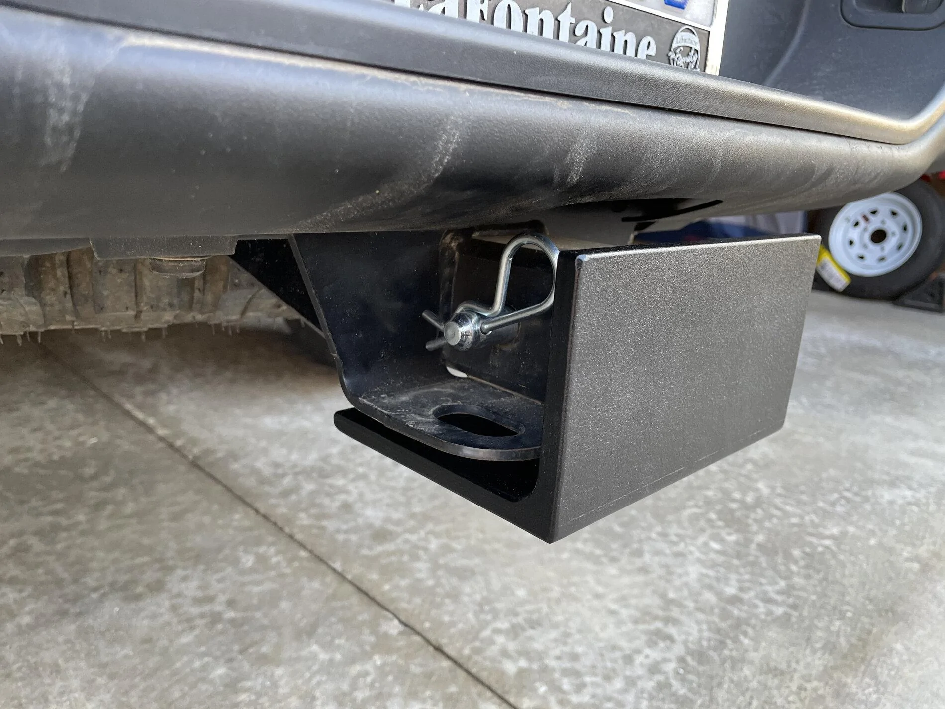

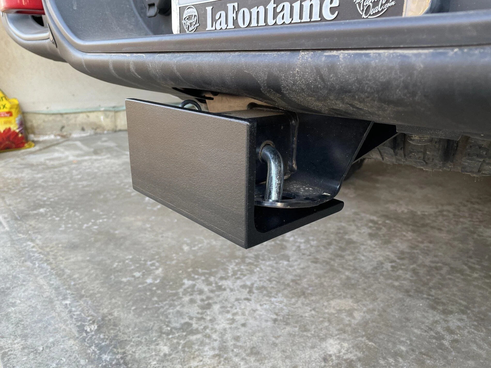

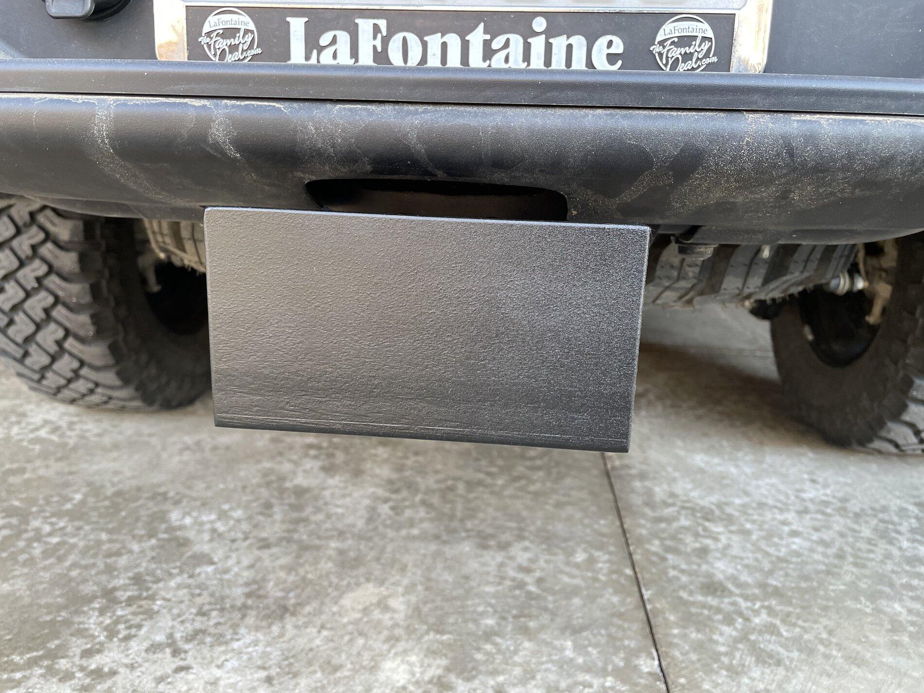

I had poked around online and found a few skids that some of the Tacoma guys use (Curt, Body Armor, Total Chaos, Sheridan, etc), but all of those seemed to hang too low or stick out too far, essentially decreasing the departure angle. The ones that did stay pretty high and tight, would not be wide enough to cover the hitch, as well as both chain tabs. The other thing is, there are several other things for the JT I would rather spend $150 on than a plate and 2" tube. I took some dimensions and made a quick design that would work using some scrap we had at work, asked a favor and voila! A rear receiver hitch skid plate that only loses 1/2" ground clearance, and sticks out 5/8" further than the unprotected receiver.
Jeep Gladiator Receiver Hitch Skid IMG_1540 2
Ended up using 2"x2"x1/4" tube with a 5"x3 3/4"x3/8" angle welded to it. Rattle canned it with some underbody paint and satin black spray paint I had, and it is ready to test out next weekend. Should be plenty beefy enough to hold up to some abuse on the trail.

Wanted to share what I came up with, and see if anyone else has done anything similar to protect their hitch while off road.

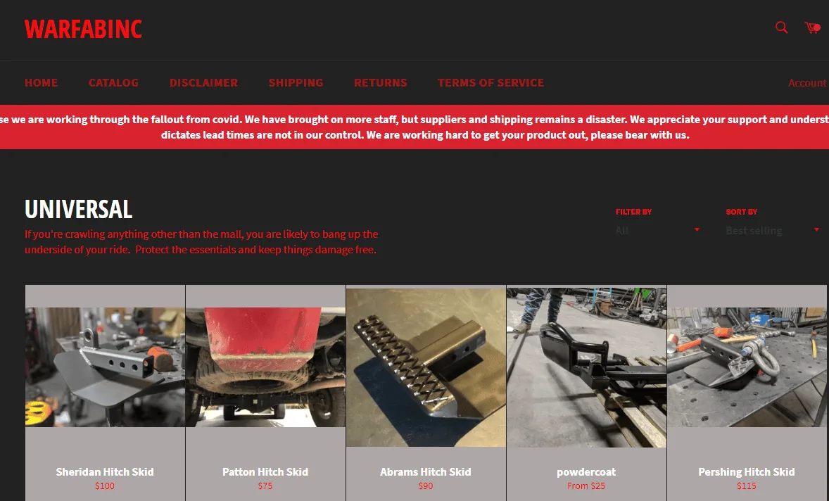

As much as I love DIY, these guys are local to me in CO and they have a $75 version that I could live with... lots of other options too. I'd just have to pay about $7 in taxes and free local pickup which makes this "within budget".

That is my plan if that happened, but I am pretty confident I could darn near park the truck resting on this and not have an issue lol
I looked at theirs quite a bit, I like the different designs they offer and how far under the hitch their skids go. If I did not have access to make mine at work, I think I would have gone with WarFab's

Those warfab one's are tight! I like the idea of having that center recovery point on the Sheridan...

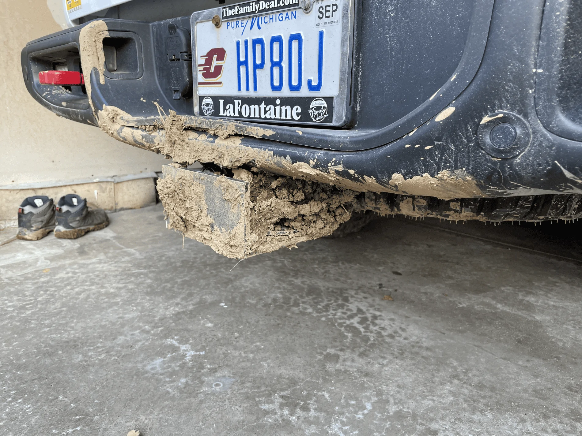

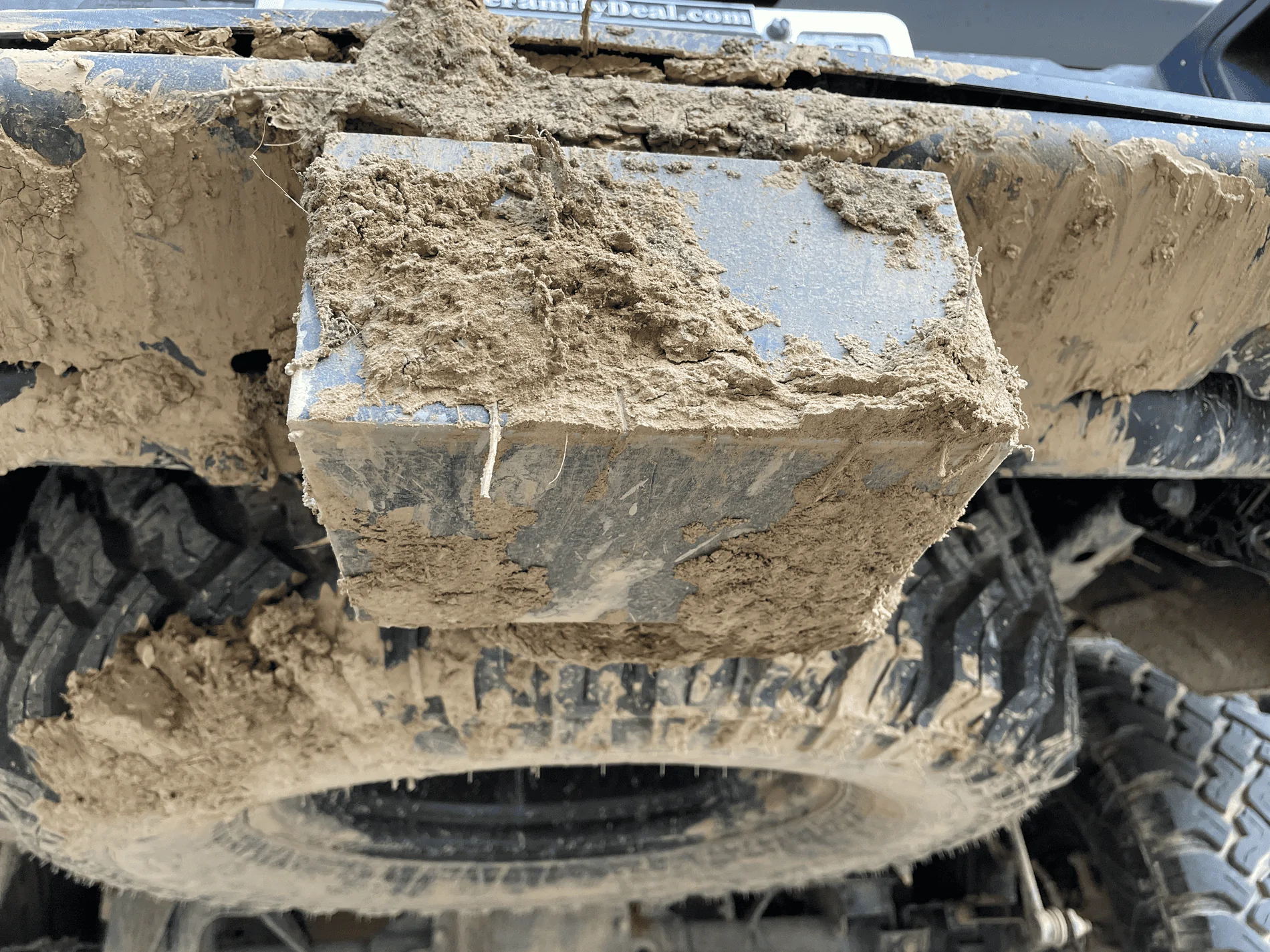

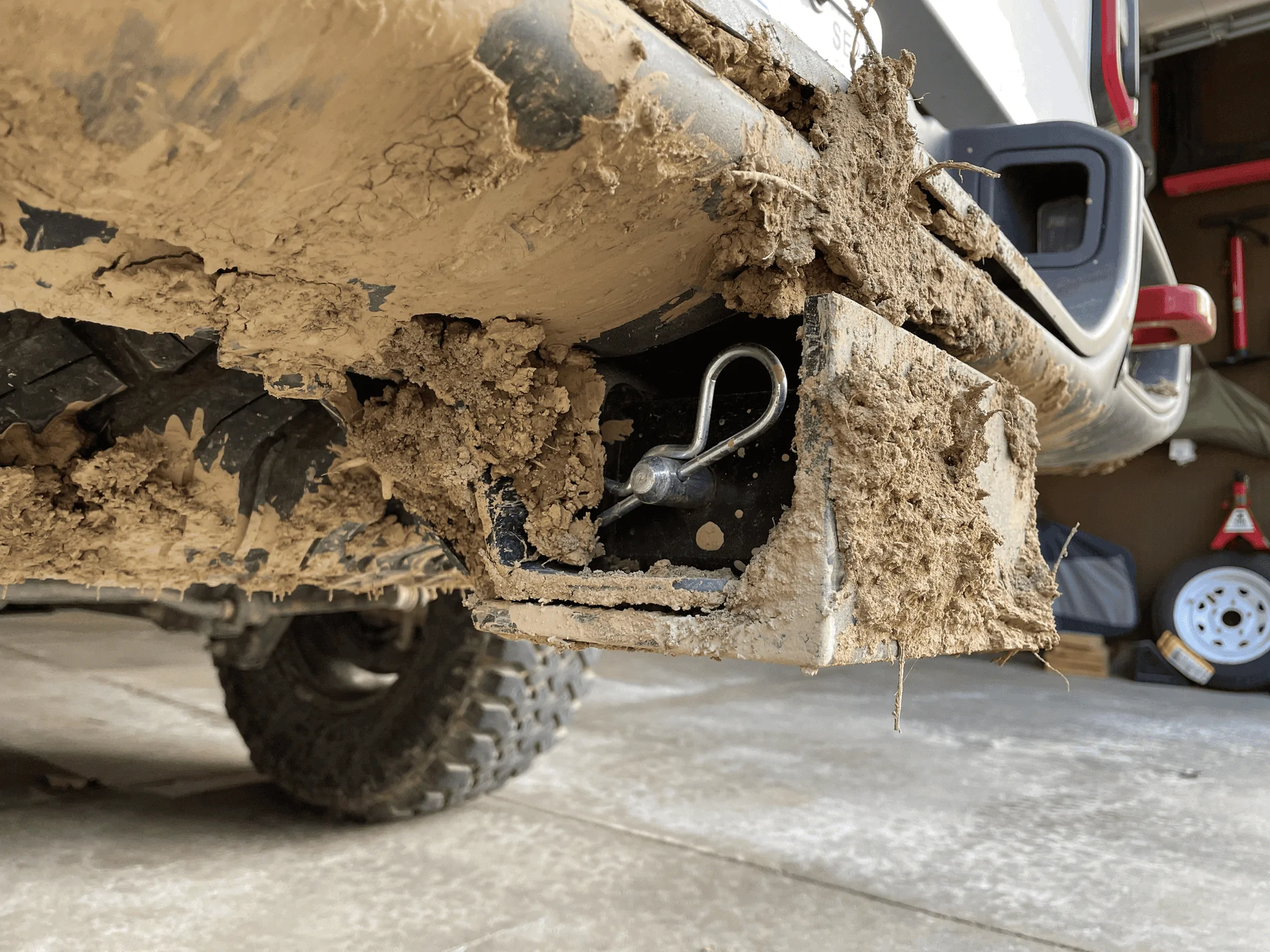

Just remembered that I never posted an update! Got to test it out a few weeks ago, and it did it's job well. It did act as a bit of a shovel, and in reverse it plowed more than just the hitch did, but I can't complain. Probably didn't need it in the sloppy mess we were in, but next time I am on some hard packed dirt or rocks I sure will be happy to have it.
