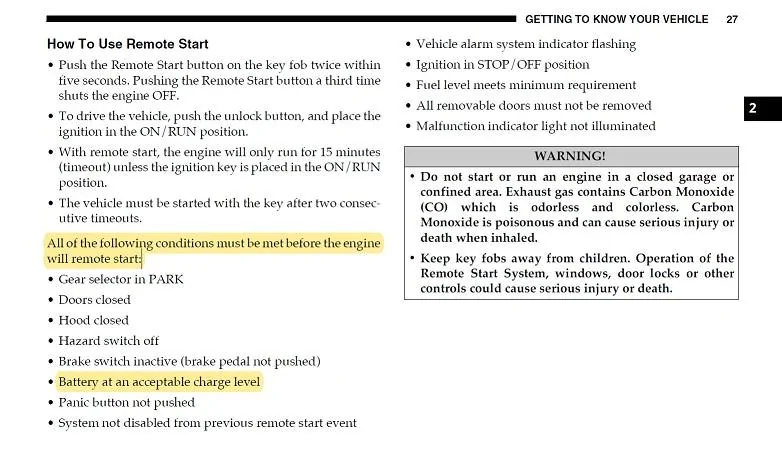

Per owners manaul. Basically if the battery voltage is too low, remote start won't activate.
