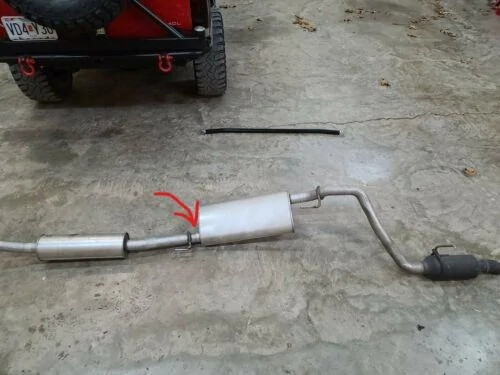

Before you go buy that Rock Crawler Exhaust try this...
If you want something quick and dirty, one cut between the first exhaust hanger and the large suit case muffler. Bolt on a turn down tip then wake up the neighbors. Does not drone on the highway.
