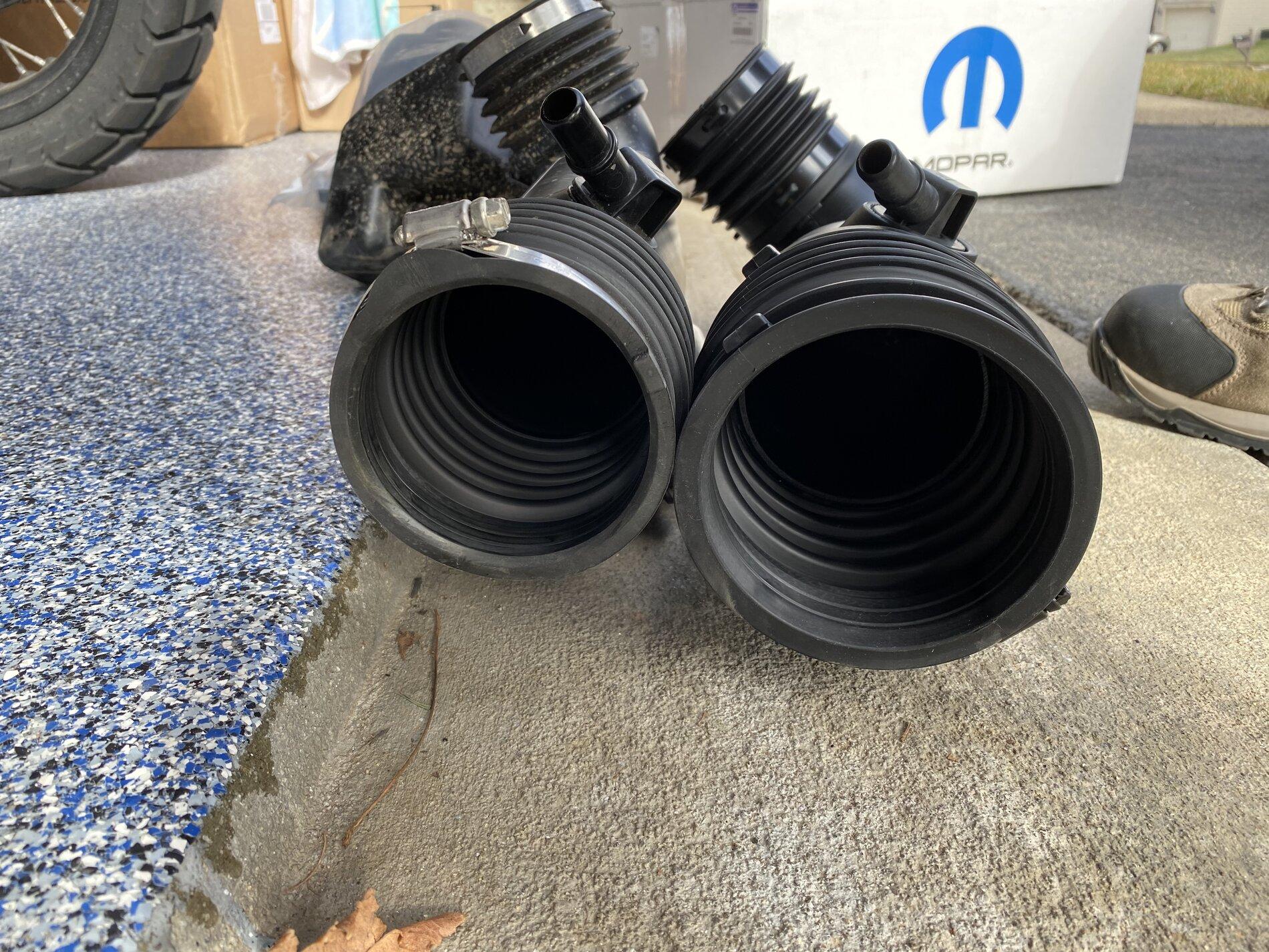

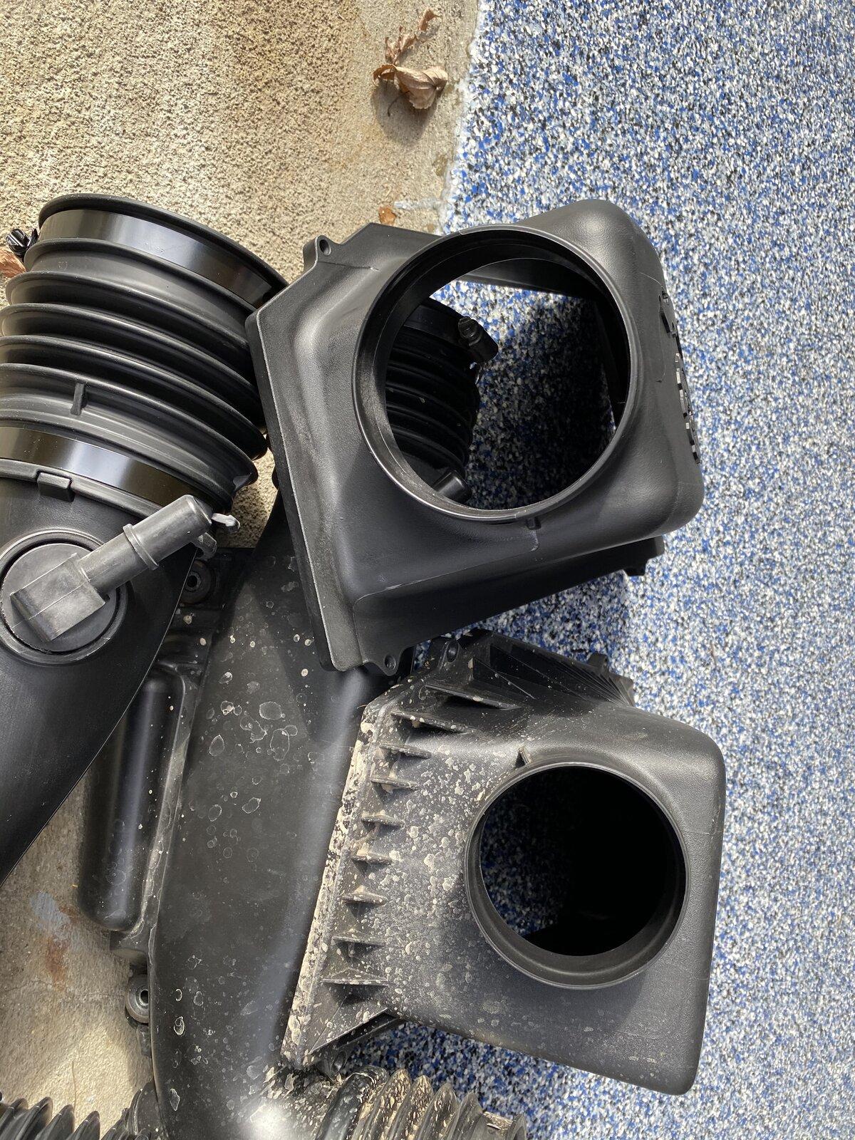

-Both of these intakes were designed by mopar engineers. One without a nvh constraint
-one of these airboxes more closely matches the size and outlet diameter of all the other current 3.6 pentastar applications.

So which is which and what is the one in our stock JT?
The larger one is the mopar intake the smaller the factory JT. The mopar is closer to what is in my woman’s grand cherokee
