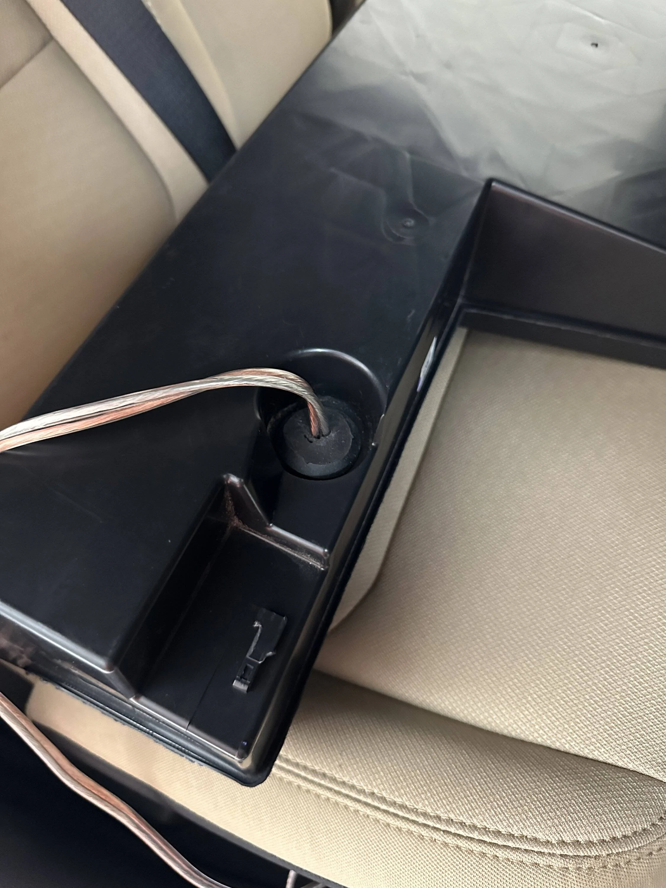

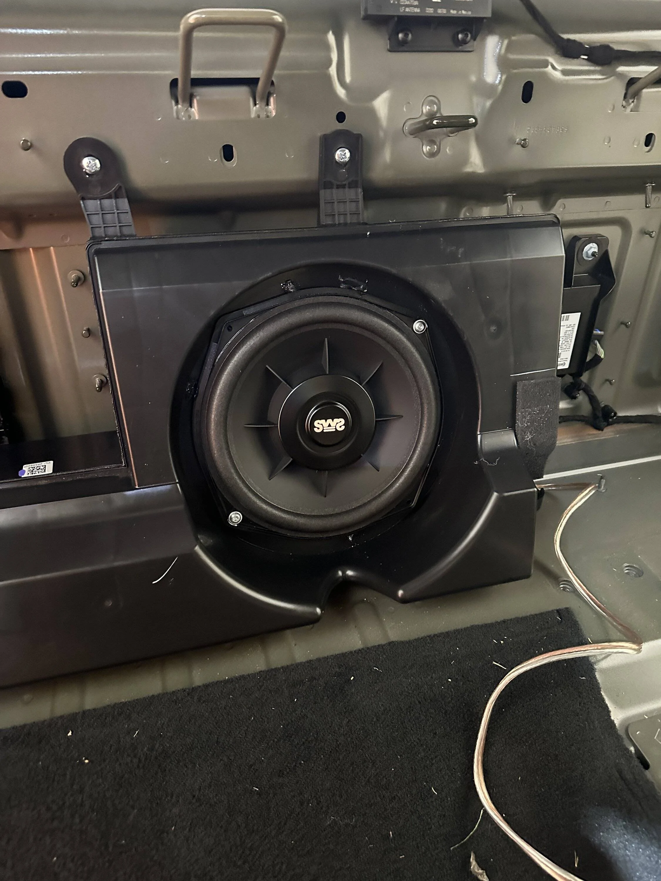

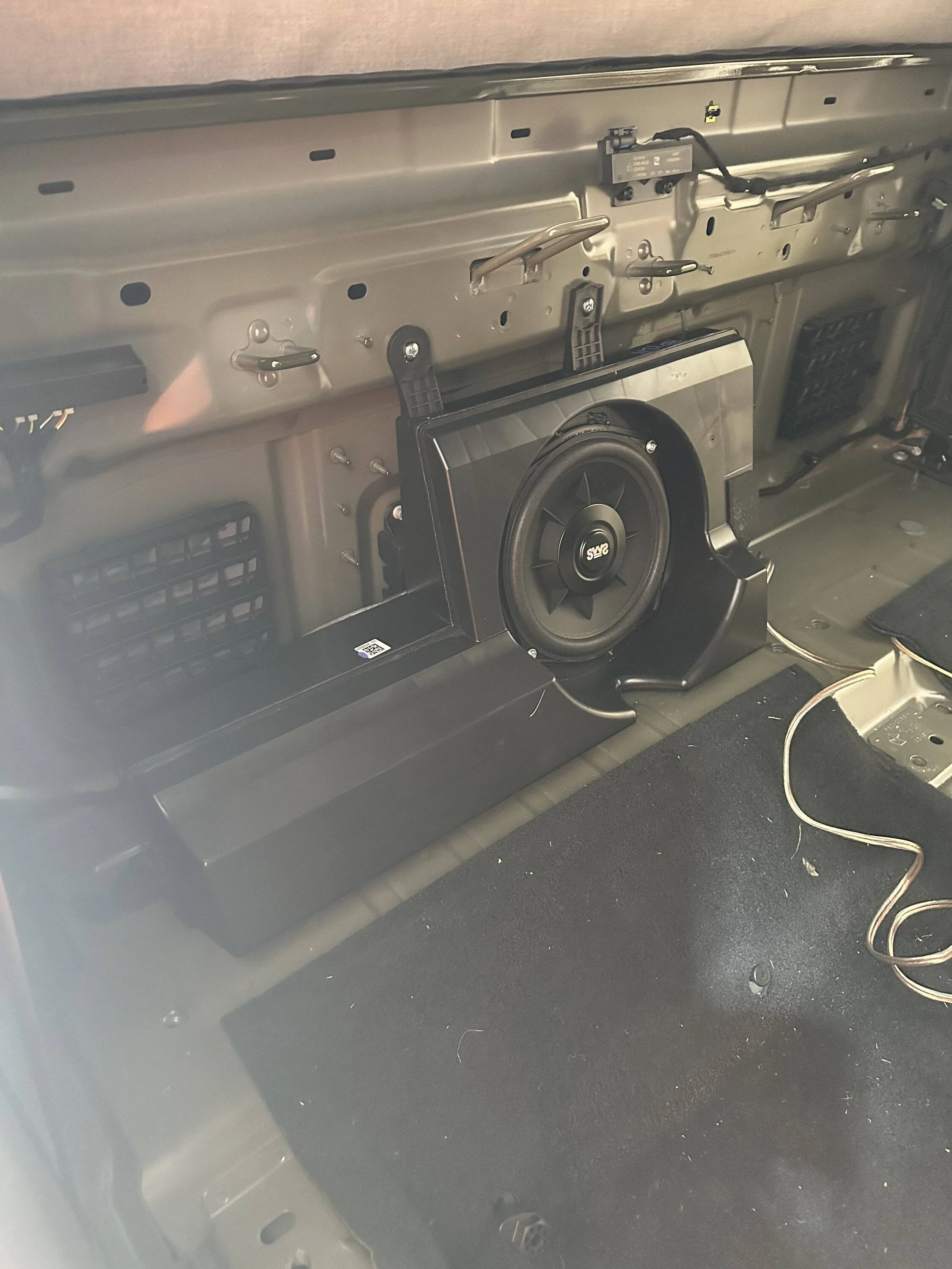

So, I removed the rear seats. (Instructions for this are detailed in the forum and YouTube.) The most difficult thing is removing the rear trim panel. You are going to break it and need a new one to replace it. Candidly, this is an unforgivable design flaw on the part of Jeep. Itās simply unacceptable that an owner cannot remove a piece of interior trim without destroying it. (Mopar part 6LJ84TX7AC is what youāll need.) Removing the old sub is simple. I then removed the existing speaker wire and threw it away but I saved the rubber grommet piece. I then ran new speaker wire through the grommet and reinserted the rubber piece into the OEM enclosure which was a PITA. I then stuffed the enclosure with polyfill. The sub I installed is an Earthquake SWS-8XI 2 ohm shallow subwoofer. (https://www.amazon.com/gp/aw/d/B003R5NS9U/ref=ya_aw_od_pi?ie=UTF8&psc=1) It fits in the OEM subwoofer enclosure using two of the screws that held the OEM subwoofer in place. I then used some silicone to seal up the unused screw holes. Photos of this work are attached below. Also, no other trim pieces or rings are needed to mount the sub. It simply fits in the enclosure with the parts included with the sub.
As far as performance, it isnāt as good as the JL Audio 8 inch which is to be expected. For its size, I am pleasantly surprised. Since I listen to blues and rock, this sub works for me. If you want to listen to rap, donāt use this sub. You will be disappointed. Given my concerns about theft, my desire to maintain an OEM look to my audio system, and my choice in music, I am happy with the results. In my teenage years, I would have been disappointed with the final results.
