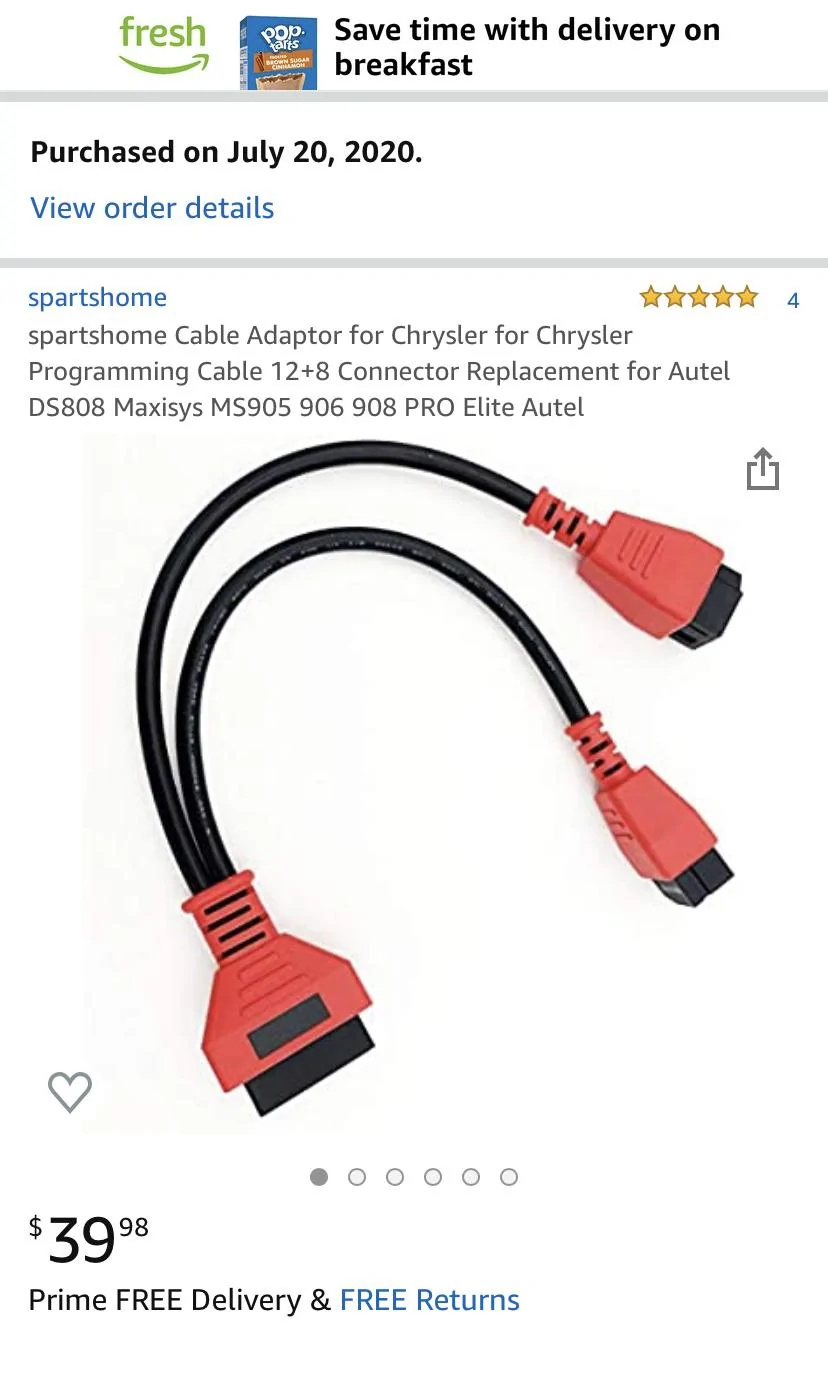

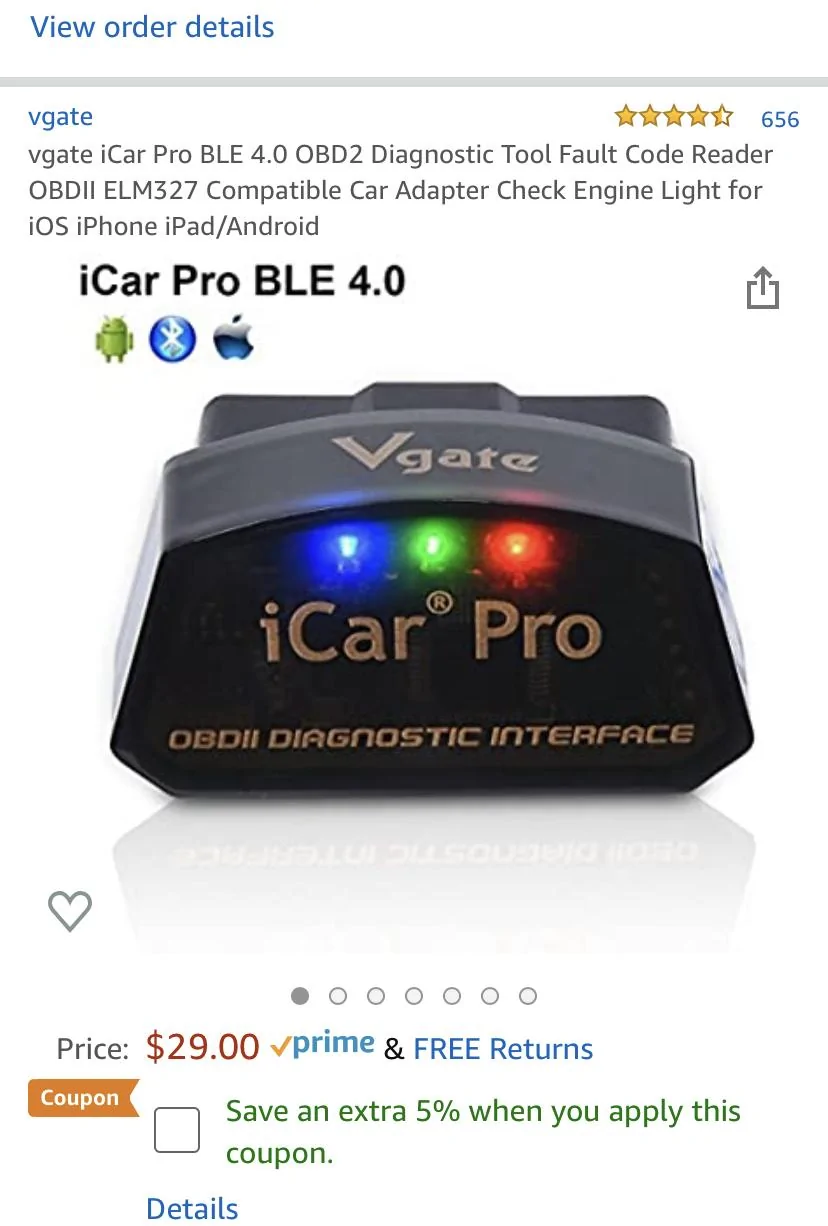

JScan prices.
I just bought everything needed an hour ago.
$30 for the VGATE like in post #24 (Prime free shipping)
$40 for the additional cable needed and mentioned in post #25 and #27 (Prime free shipping)
$19 for one car license (Will buy later)
So about $90 all in for one car.
The two parts arrive on Friday.
Side note .... I need it for four cars so I need to spend near $60

OK, if the vgate plugs into the port, and the app runs on "a phone" and uses bluetooth, why is a cable needed?
