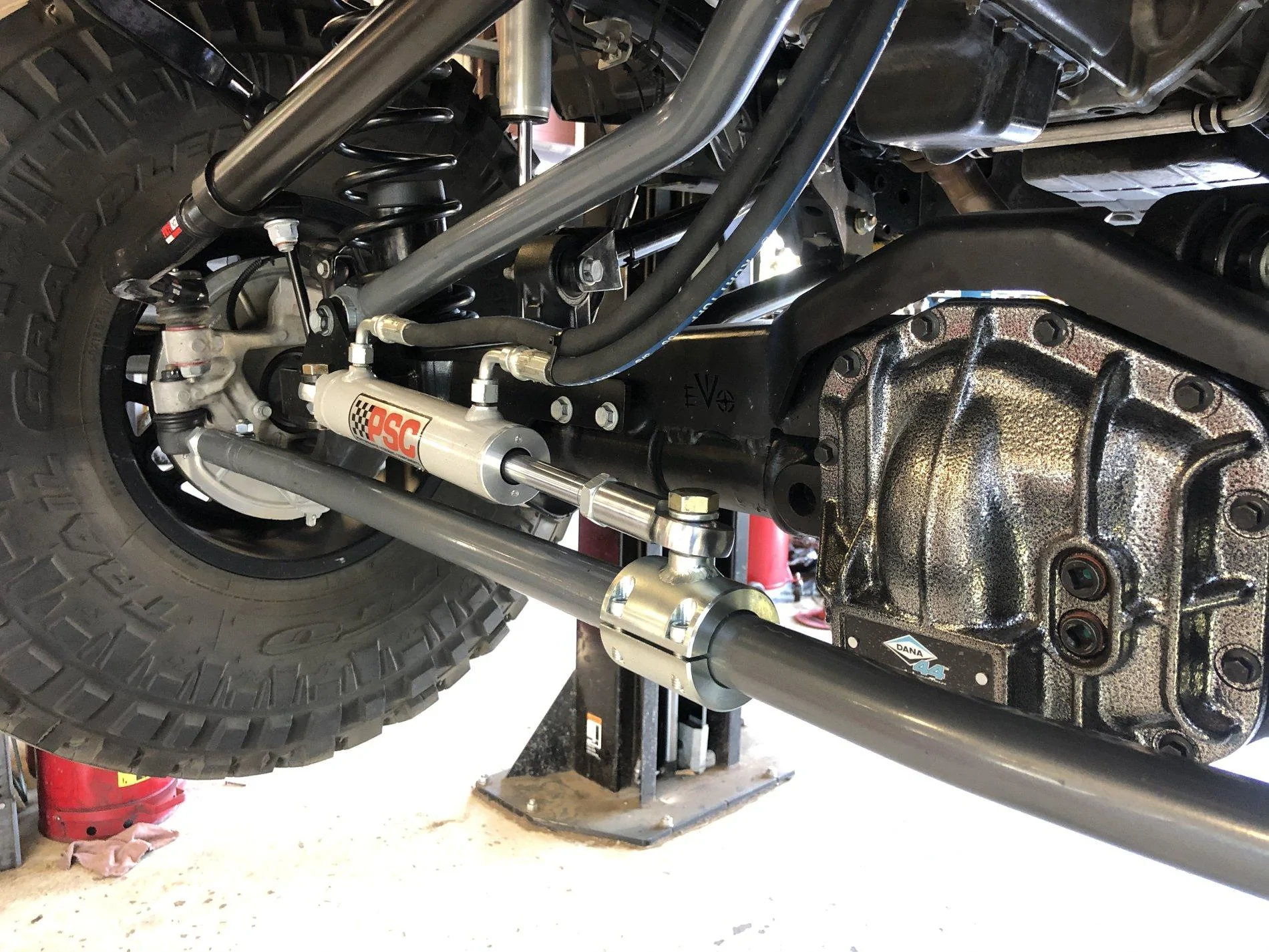

Is anyone running steer smarts flipped drag link and relocation bracket with the Pro-X? Are they needed or is under the knuckle perfectly fine? I plan to run the Yeti tie rod, drag link with griffin, and track bar along with the relocation bracket accordingly.

37s 3” 40s 4” in the front. I had to ditch my stupid oversized steersmarts Trackbar for a synergy one due to the huge clamps SS uses. I am not a fan of their stuff, I’ve had a lot of issues over the years with SS and their customer support is horrible but I didn’t want to drill the aluminum knuckle out. I’m already nervous about those knuckles so I used the SS top mount no drill I think the stud size they use is weak so I added A PSC hydro assist Ram and big bore box to relieve the force applied to the draglink mounting point and spread it out over both knuckles. Hope that makes sense.
Makes perfect sense. I really appreciate the info!
