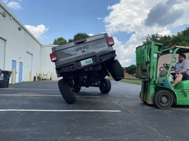

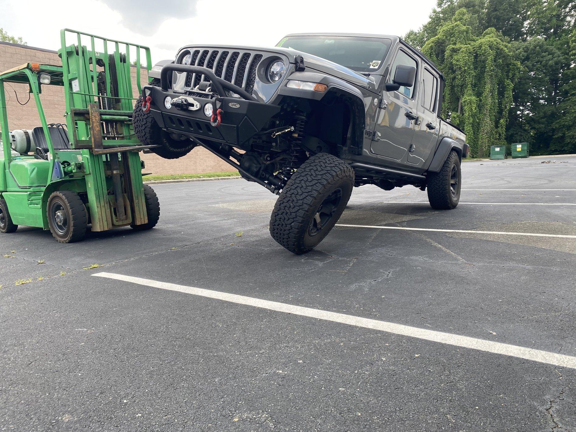

Came out awesome!!!! What an improvement over the stock suspension!!!

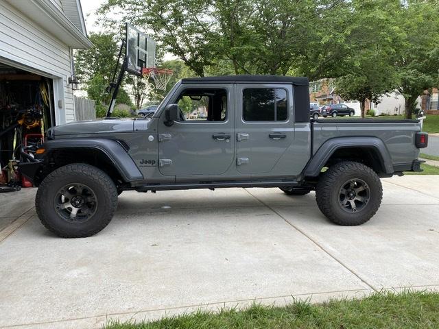

That looks terrific, love the flex. Do you have a picture from the side with the new suspension and 35" tires? Also, what is your height now from the ground to the highest point of your hard top? Thanks.

Here is a side shot. I’ll measure it tonight and post. After a 700+ mile ride home I can’t say enough about this kit. Nasty expansion joints are a joke, especially mid corner. Now I understand what RK means by the track bar cross talk. This kit really transforms the truck on the road. It’s rock solid!! It drives straight as an arrow with 2 fingers on the wheel even when I was intentionally hitting bumps in the road trying to upset it. I’m really excited to get it on the trails.

And as a point of reference, the front tire is 35” off the ground measuring from the lowest spot of the tire between the fork lift arms and the rear gets to 33”. (35x12.50x17 KO2s). And it’s very stable with a tire all the way up. We shook the hell out of it and it didn’t budge at all.

It’s 78-79” at the highest bar on the soft top. It fits in a standard garage door with a couple inches to spare.

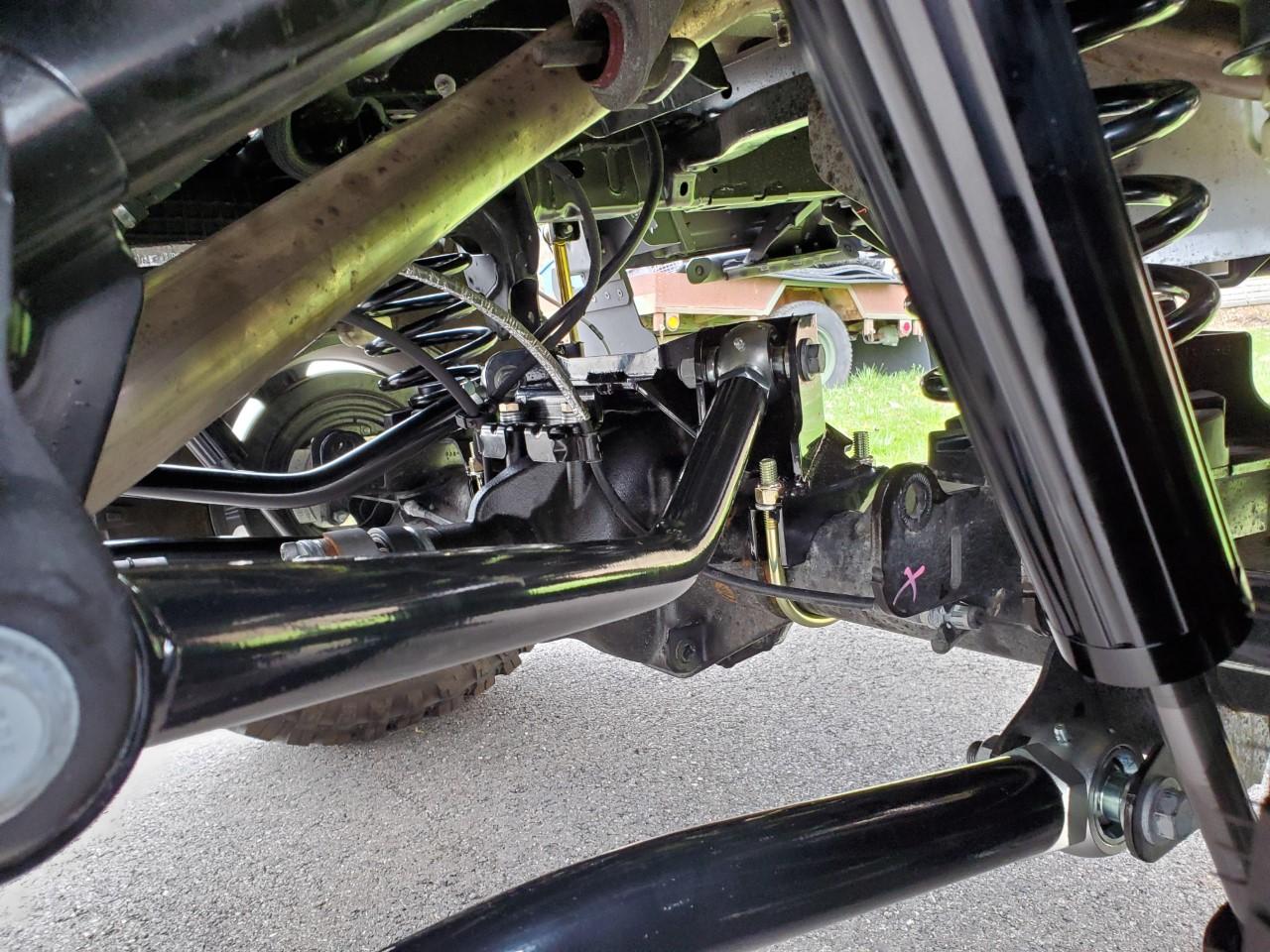

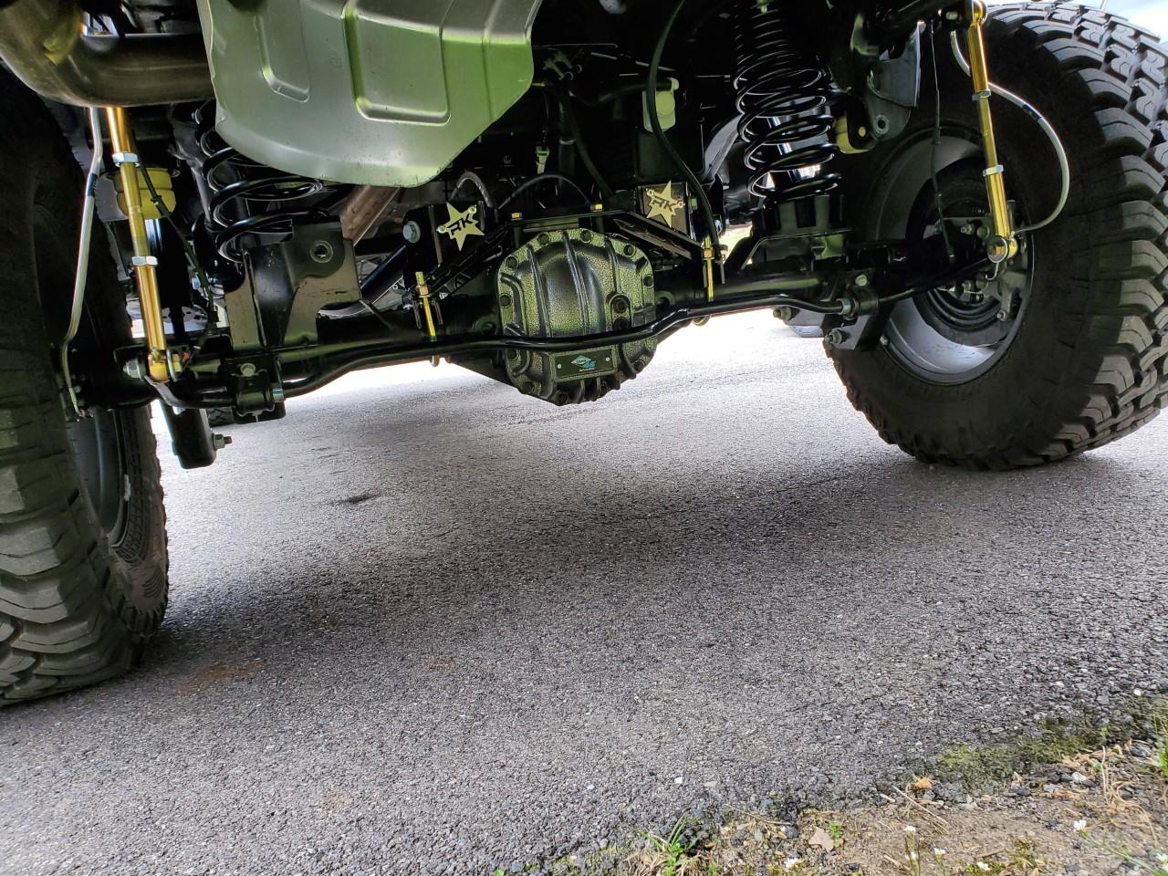

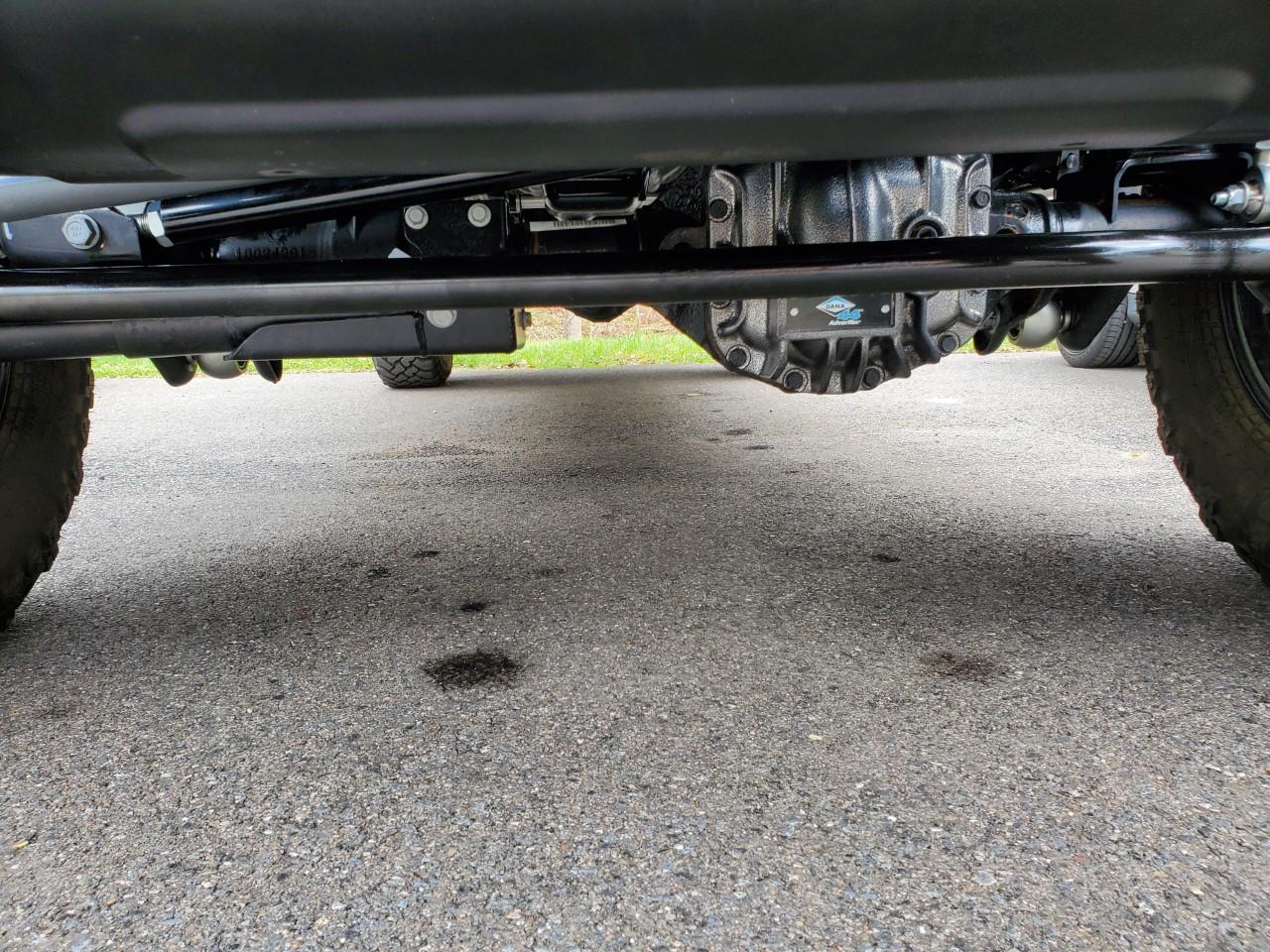

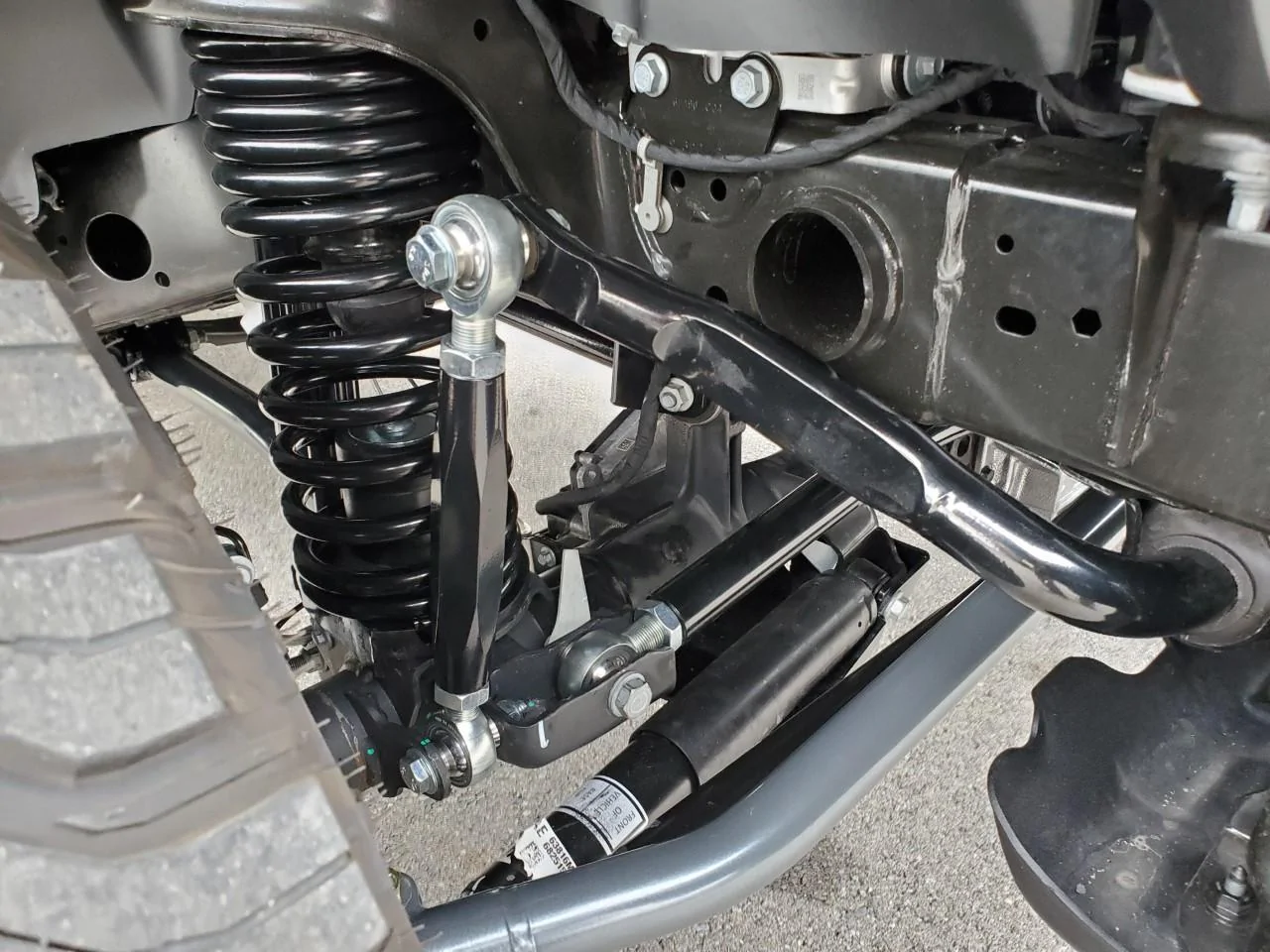

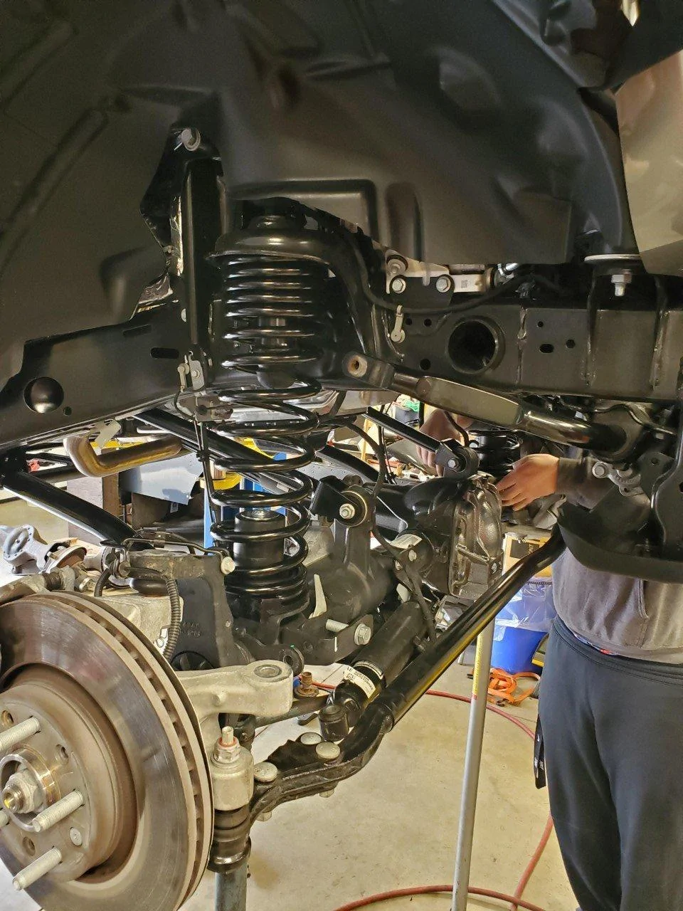

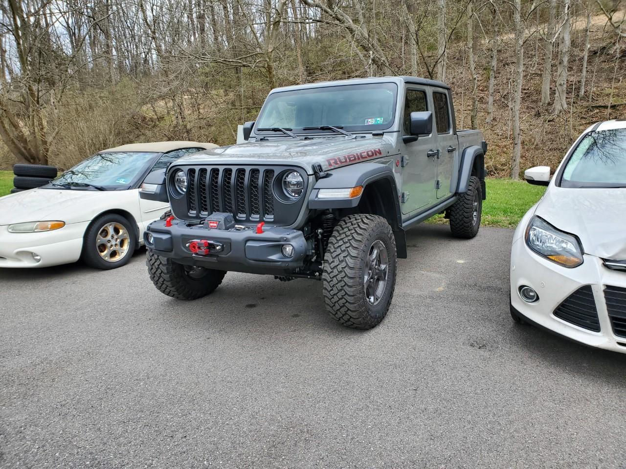

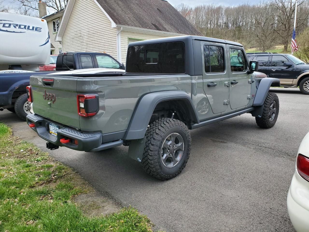

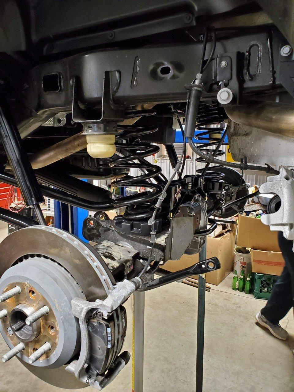

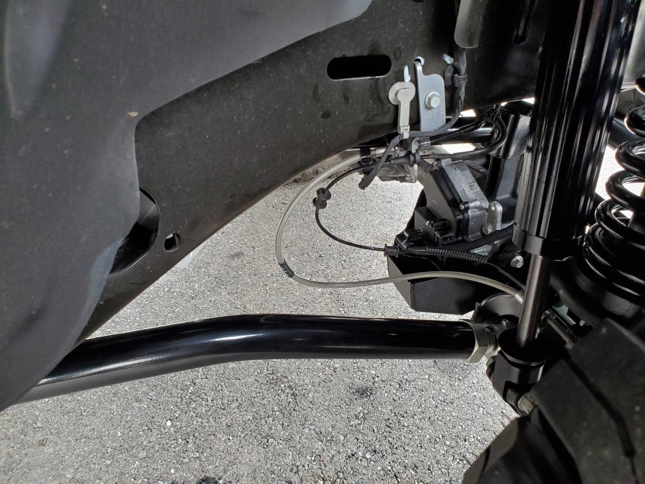

I got my lift completed yesterday. Unfortunately I haven't driven it yet and still need to make sure front axle is centered and recenter my steering wheel. I had a slight emergency. My oldest son who is Army ROTC at Virginia Tech was sent home by the University as they continue to try and limit the campus population as much as possible. Anyway his Jeep Liberty's A/C compressor took a dump in West Virginia on his way home and I had to drive down and trailer him home last night. So before I left to get him I wanted to get my Gladiator done and off his lift. I figured I'll come back over this week and finish adjusting and tightening what I need to and bring it home.
The lift install went smoothly. My hats off to anyone who installed this kit on the ground. I originally planned to do it that way till my buddy said his lift was open all weekend. Took my youngest son and I about 10 hours total to install including installing new stainless brakelines and replacing my Draglink with a heavy duty Synergy. I have the Tie rod and stabilizer relocation kit as well but figured I'd install that at home right before I take it to be aligned. I have already sent a message to Rock Krawler because my kit was missing the rear bump stop pads. But no biggie, can install those easily enough later. Here are a bunch of pics of install, finished product, and my piece of roadkill....LOL
