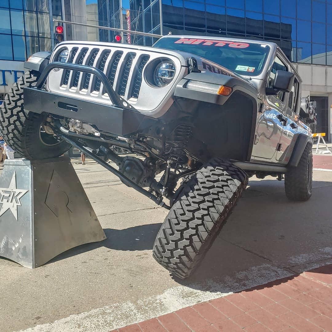

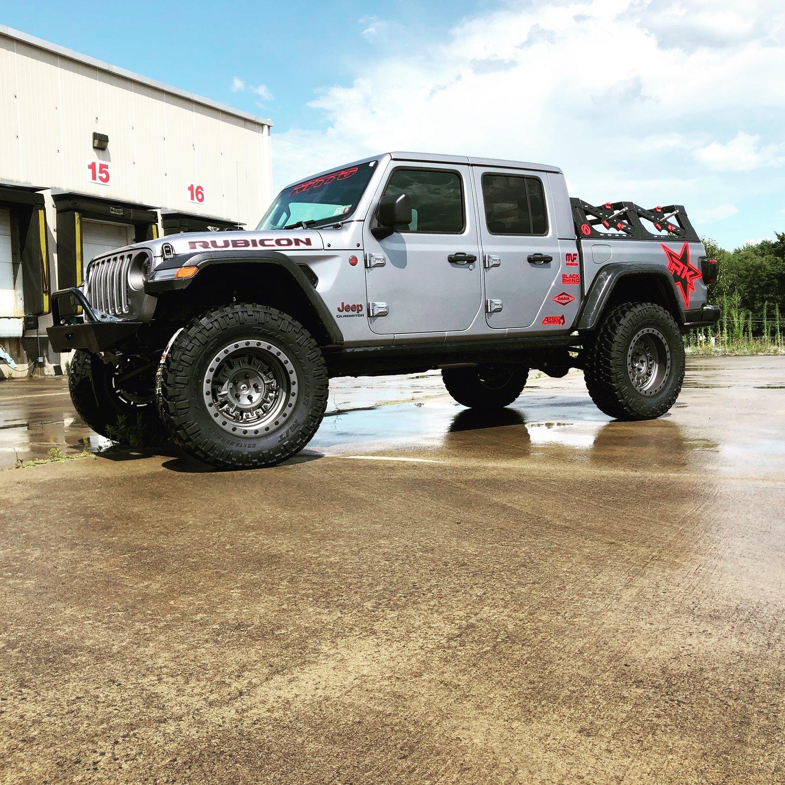

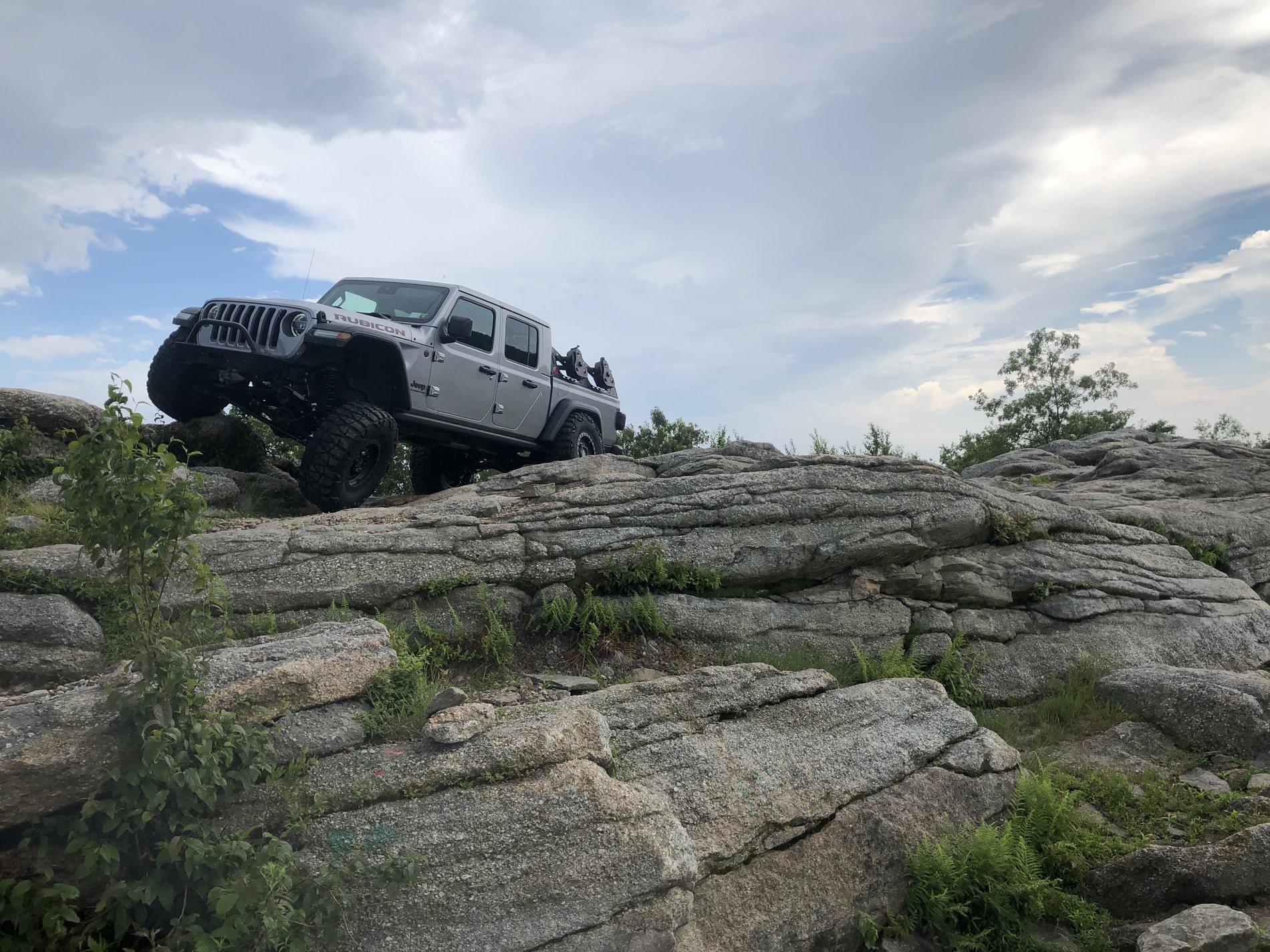

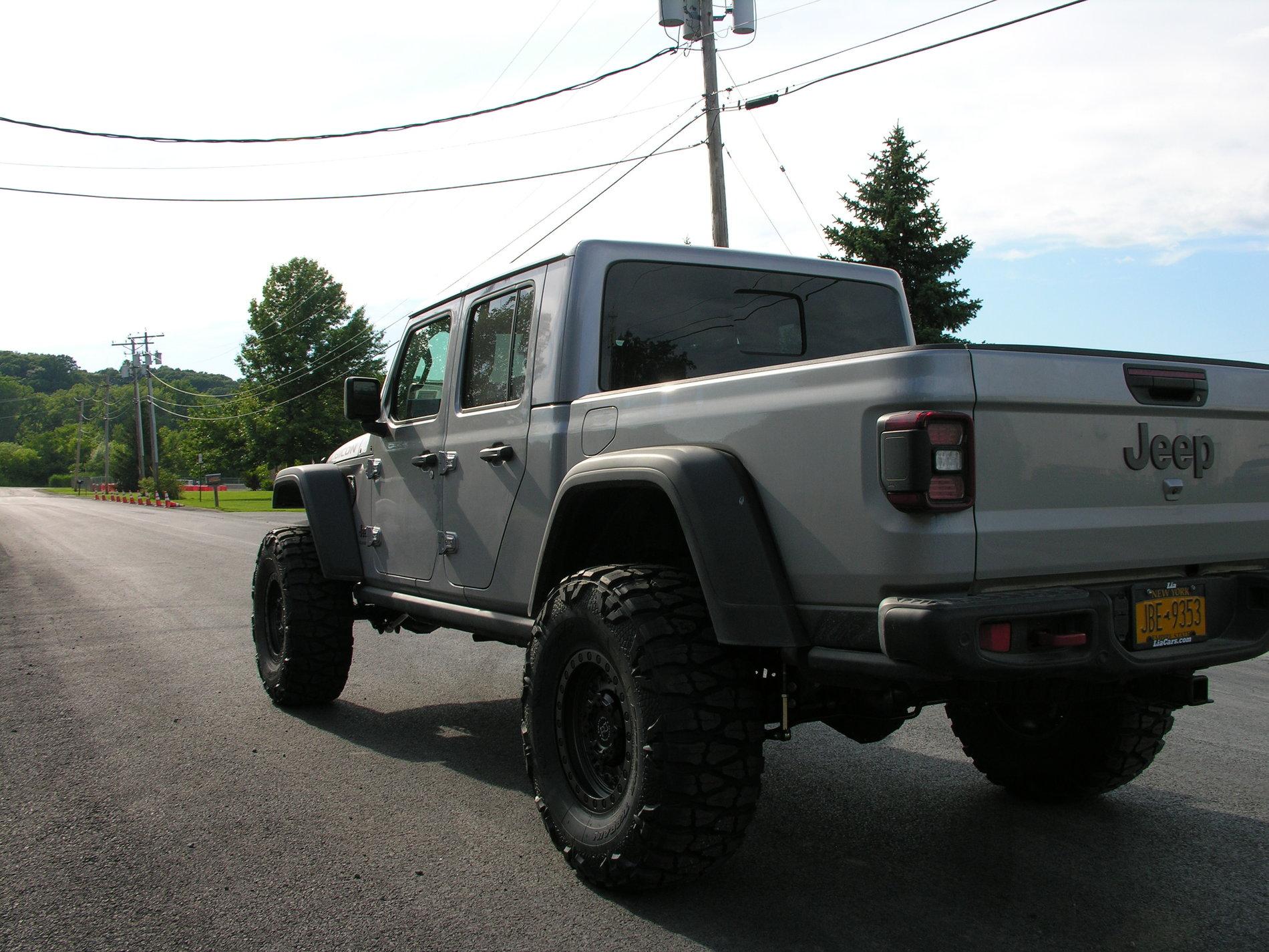

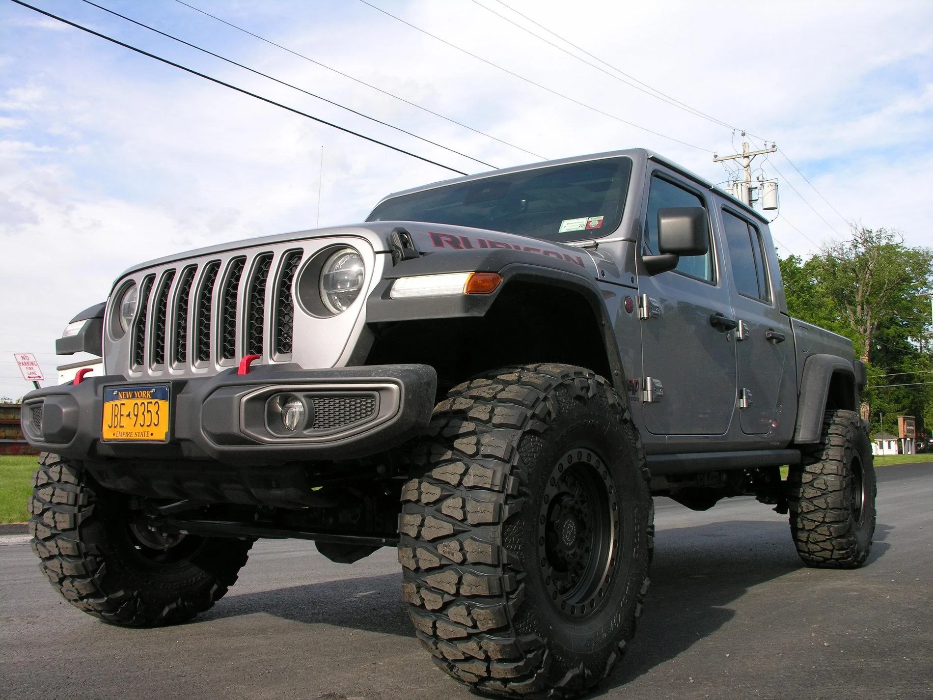

We've finally finished designing and testing our 3" X Factor systems and are getting everything set for production. Here's a few images to wet your whistle. http://rockkrawler.com/suspension/2...x-factor-series-mid-arm-systems/new-category/
