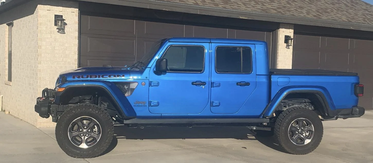

UPDATE on my Rock Krawler Lift:
Just an FYI on my experiences with this outstanding lift kit.
I have over 7000 miles on my Rock Krawler 3.0 X-Factor No Limits Lift and loving it every time I drive.
I get all kinds of compliments on how the Jeep “Looks” and I’m still riding on OEM MT’s (33”)
The handling and ride comfort is superior. BIG improvement over stock.
NEWS:
Fox has now finally released their 2.5 Shocks with remote and DSC for the rear on the Gladiators with a 3” lift (Part #883-26-074) and I’ll be adding them soon to finally complete the setup for all 4 corners. I added them on the fronts when I installed the lift. Ran El Cheapo Adjustable Ranchos in the rear Only because 1. They were temporary to get the lift kit installed and 2. They were adjustable and just “OK”.
ISSUES WITH KIT:
I had very few issues during install. Instructions were good. I did have to scratch my head on a couple things like disconnecting rear calipers to get enough droop for spring install and disconnecting driveshaft on front axle to get enough droop up front as well but not much more.
After install I checked alignment myself and thought all was good. Had to recenter steering wheel to get rid of disabled traction control light. Computer in Jeep doesn’t like the steering wheel being off center by too much.
I also had a squeak coming from the rear and was annoying. I had Plasti Dipped my springs red to match all the RK parts I painted Red and that may have contributed to the squeaking. Luckily I save my OEM springs and the rear set had these blue Isolators on them so I had an Ah Haaa moment and removed them from the OEM springs and put them on the RK’s and squeak is GONE. YAY!
Another problem I had was excessive front tire wear on the inside edges, smoked ‘em in about 10K miles but was my own dumb fault. I “THOUGHT” I had the correct toe in setting. I rechecked after I found my tires were shot only to find out they had way too much toe out hence excessive inside edge wear.
I rotated the tires by swapping rears for fronts and set the toe in to 1/8” using and expandable bar set to the front edge spacing locking that distance in and then moving it to the Rear Edge and checking until I had a 1/8” gap.
Lesson learned The hard way. Would have been cheaper to get an alignment check but I thought I did it right. DUH. Now I know a better way to check it.
With toe in set correctly now it handles and steers ultra smooth. Images that? LOL
Getting 2 replacement tires this morning and having them CHECK THE ALIGNMENT!!!!
Enjoy your RK Lift Kit and Jeep.
Ride on!
