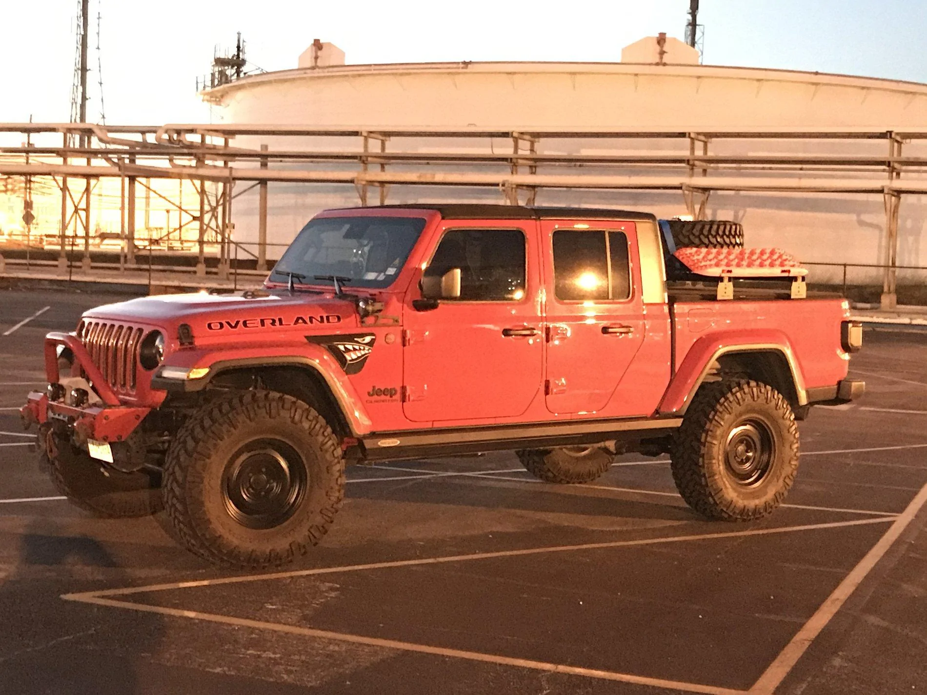

I have the 3" kit on my Overland right now with 37's and an extra 1/2" spacer on the front coils. I haven't really flexed it out but I can tell you that the only real issue I have is that my 5" back spacing on my wheels is not enough at the tires rub the lower control arms just a little. I put washers on the wheel stops to fix the issue but I didn't plan on that happening. I'm also going to swap out the coil correction pads that came with the kit for 1.5" coil correction pads to gain about another 1" so I am closer to level. Right now I still have about a 1" rake in the front and I want to get it level. I really like the look of the Mojave and wouldn't mind having it sit more like that.

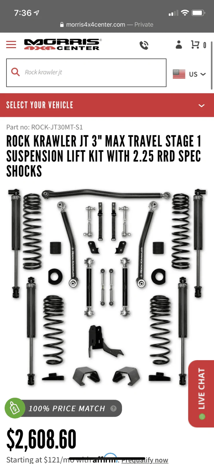

Max Travel Replaces front lower and rear upper control arms, this gives you the ability to adjust caster and pinion angle but uses factory arms in the front upper location and rear lower location which lave limited amounts of misalignment and will bind earlier, limiting travel and reducing capability.
X Factor replaces all of your control arms with adjustable arms that go to factory mounting points. It gives you the ability to dial in caster and pinion angle while having spherical joints at each connection and help to alleviate binding.
Pro X replaces all of your control arms with adjustable and triangulates the rear to really free up the rear end under suspension travel, gave us the ability to put the geometry that we think is correct for the rear, rather than being tied into the factory geometry. The triangulation deletes the rear track bar and the cross-talk associated with it. The axle stays dead center under the rear of the jeep and does not sweep left to right like the factory geometry forces it to.

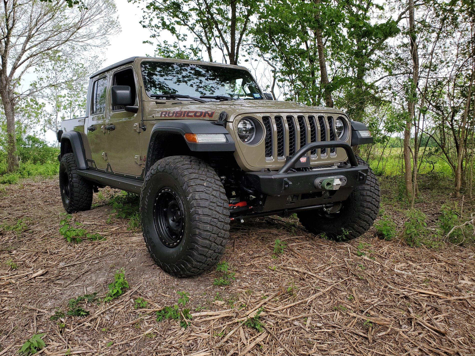

My lift is installed. Pro-X "No-limits" with RK shocks with Yeti track-bar, drag-link and tie-rod and Fox ATS steering stabilizer. Rides on 37" BFG KM3's. The ride is excellent. Much smoother and more responsive than the oem suspension. The RK shocks tuned for the Gladiator provide a superb response.
