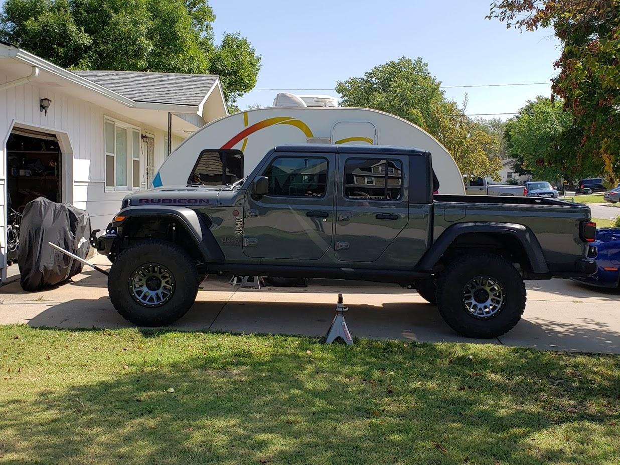

Went ahead and ordered this kit this morning. They said should be able to ship it out in two weeks or so. Keeping fingers crossed. Anything else I should get to go along with this system?? No need for a driveshaft correct??
I installed this kit on my Rubicon and running 37" tires and a winch. I ended up adding 1.5" spacers to the front to level it out.
I used Teraflex as I forgot that Rockkrawler had the 1.5" correction pads for the front also so either should work.

Any pictures of the finished product yet? I installed the same kit on an overland and used a .5” Teraflex spacer in the front and I’m about 1” lower in the front than the back. I have RKs 1.5” front spring pad spacer on order but like everything else.... it’s back ordered.
This is all I got as of now. Driveway has a slight angle to it.
Back ordered, thats right. I remember now when I was looking at them and that is why I went with the Teraflex. Measuring the bottom of the doors I have about .5" lower in the front but to me that looks just fine even setting on level ground.

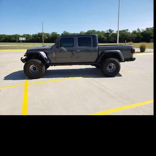

Yeah, not real happy about that 1.5" spacer either. Its all installed now so guess I will just have to deal with it.
Here is another pic on level ground. Still has some rake to it but livable.
Thanks for this. I have the 3" Prox-X kit in my Rubicon. I love the kit and the ride. I'm living with the rake right now as it does allow you to maintain the vehicles payload and towing ability. But...after seeing this...really shows how much I'm missing out on....lol. I have a steel front bumper with a winch so even with the spacers I'll likely still have some rake.
Looks like we are running same front bumper too. I think my sport fenders will help but running 35s right now. I’m at a loss what to do now. Yours looks super lifted compared to others.
I think it is the fenders. Most rubicons run 2"-2.5" but I wasnt going to pay the money the other lifts wanted. I do have to say the ride is awesome with the Rock Krawler.
