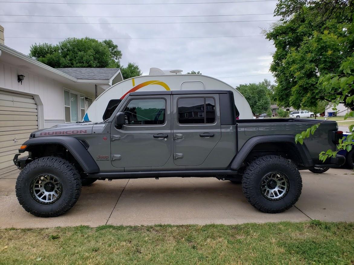

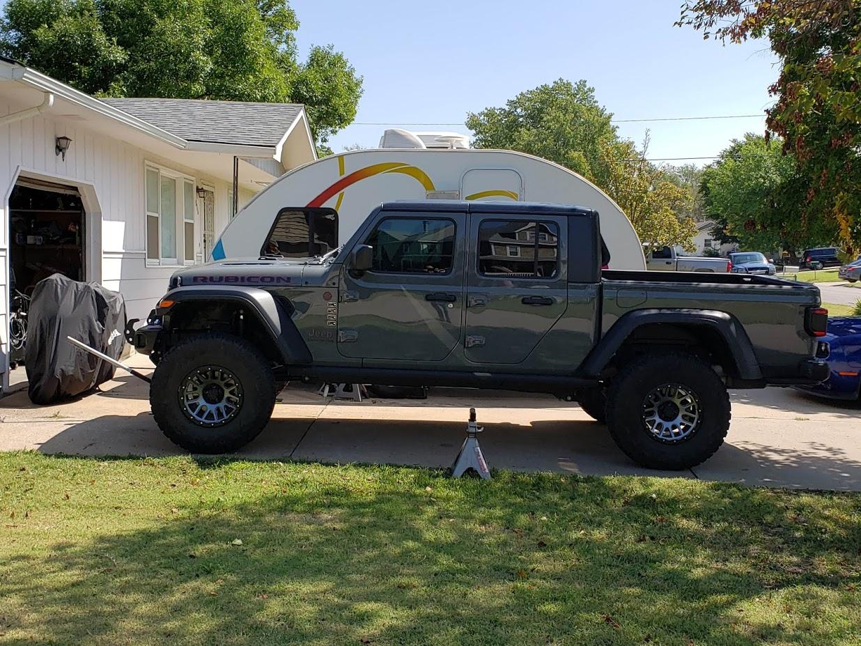

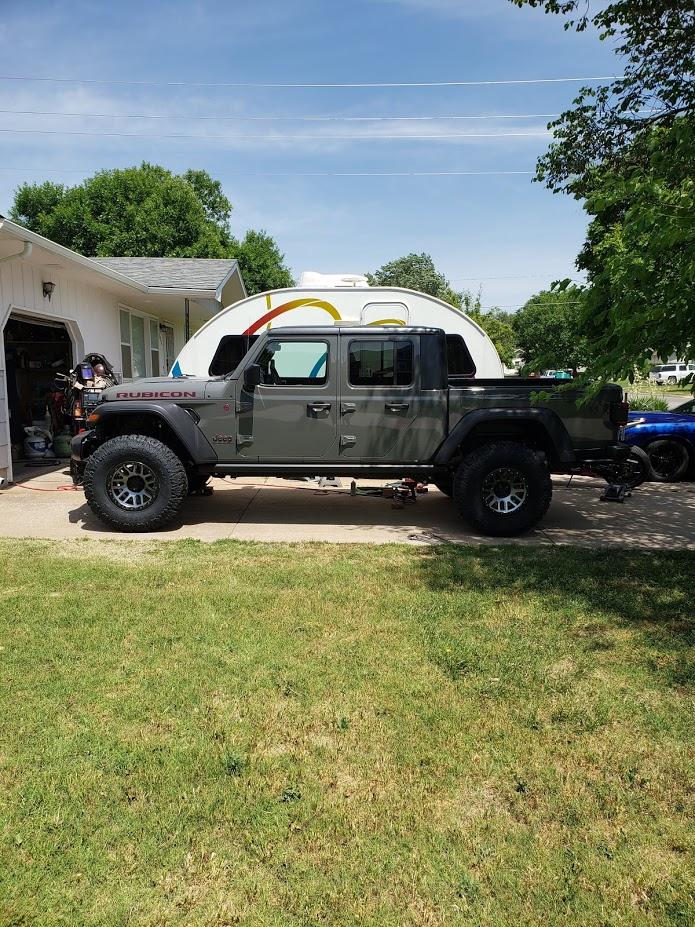

Here is a progression from lift first installed, lift with front steel bumper only and then how it sits now with steel front bumper 12000 lb Badlands winch and a week of complete flexing from Colorado trails. Sorry it is not sitting level but I wanted it to be consistent.
Jeep Gladiator Rock Krawler 3" X Factor JT System lift pre bumper
Jeep Gladiator Rock Krawler 3" X Factor JT System lift after bumper
Jeep Gladiator Rock Krawler 3" X Factor JT System now1
