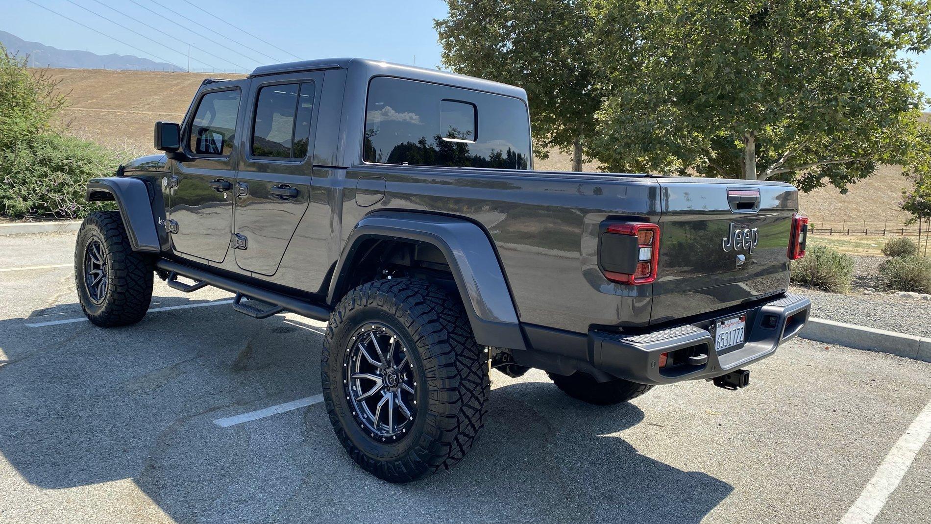

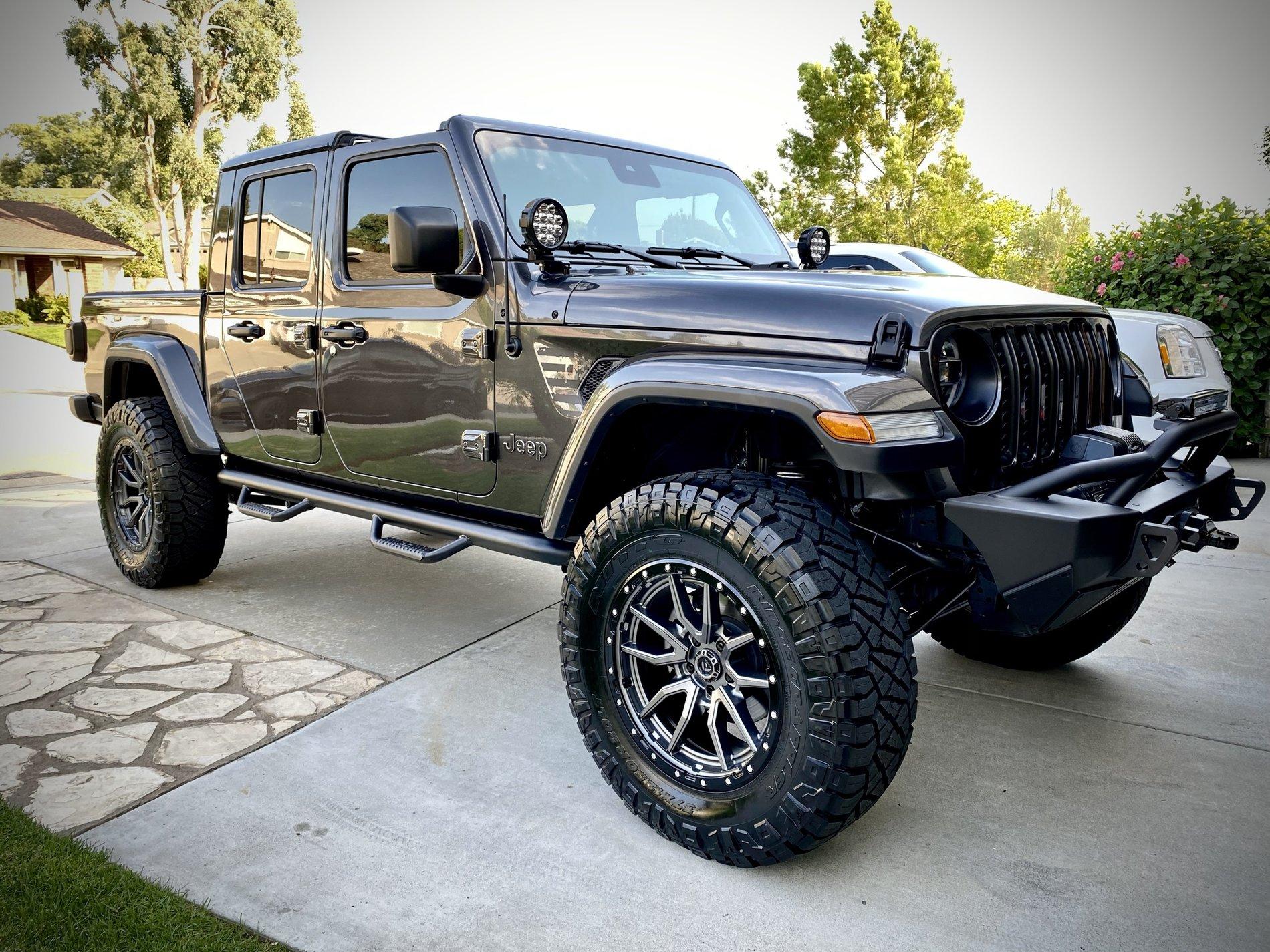

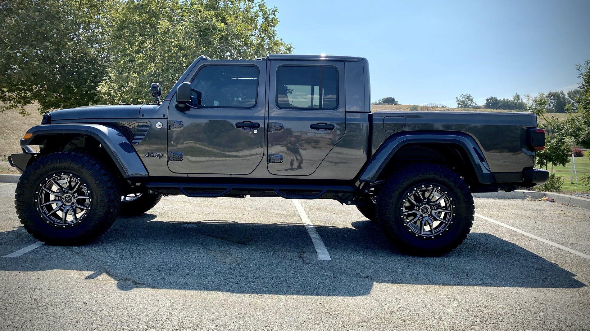

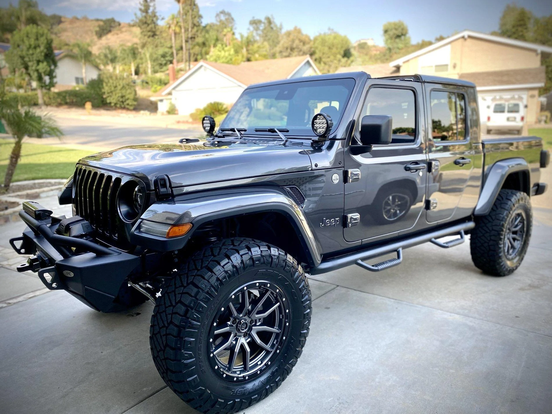

3" kit with .5" spacer added to the front on an Overland. 37x12.5R20's with 5" back spacing. Front still sit's about an 1" lower than the back with the steel bumper and winch. Looking to add about 1" more to level it out.

That looks killer!!!
I forgot to mention....I added a 1/2" coil spacer to the front to make up for the heavy steel bumper and winch. Still has a small rake and I could use at least probably a 1.5" spacer to level it out. Just don't want to affect how nice it rides now by throwing off caster or anything else :)
