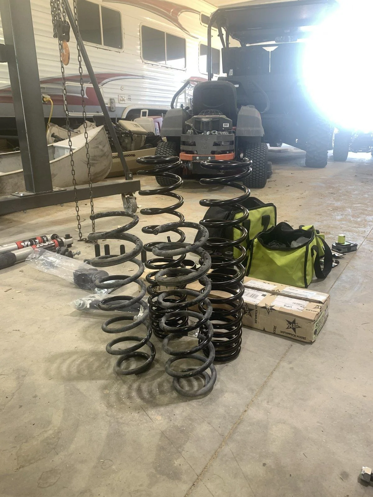

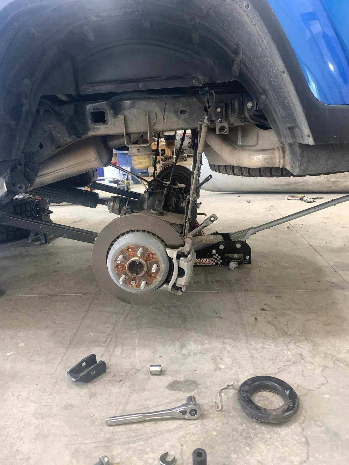

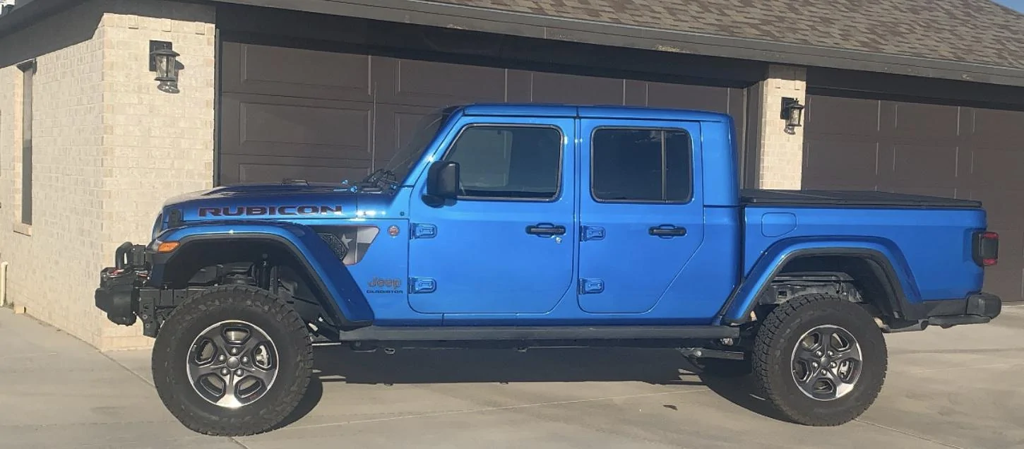

I finished installing the lift today. I started yesterday afternoon and finished this evening. I pretty much completed it all myself with a couple of floor jacks and a couple of sets of jack stands. Next up, new wheels and tires!

I wanted to give my first impressions of the lift. First installation instructions were good. I only ran into one or two small items to work through. Overall great job on the instructions though.
When I first got in to drive I felt the suspension was much firmer. I was actually worried I might not like how it rode. Today I drove about 300 miles of 95% interstate and while it is a firmer ride the truck handles much better. I found myself doing 85+ a couple of times when in the past the way the truck would just kinda float over the road would scare me at those speeds enough to slow down. Similar story on taking high speed turns. The truck felt more connected to the ground for a sportier ride than stock. All in all I would say it is a vast improvement over stock. I can’t wait to get it out on the rocks and see how it handles.
Before I got on the highway, I took it in for an alignment. I gave them RK’s recommendation for caster however they did not adjust it as they said they couldn’t break the control arm jam nuts. I’m thinking they didn’t try very hard though. I ask them what angle the caster was at and they told me 7 degrees on both sides. Recommended is between 5.0 and 6.25 with +0.2 to 0.4 on the passenger side.
@Rock Krawler Suspension What effect will having this additional angle have on caster? Also what is the purpose of having the passenger side at a higher angle than driver?

I'm glad you're liking it.
Having caster in the ~7* range can create pinion bind when at speed, in 4 wheel drive and the axle is drooped. Some manufacturers even recommend 7* on JL/JT so, I wouldn't worry too much but if they're breaking jam nuts by loosening them, I'm impressed.
The premise of cross caster is to simply account for road crown. most roads are graded towards the shoulder and that grade will make the vehicle want to turn down hill. Without cross caster, you'll always hold the wheel slightly left to go straight on a crowned road. With cross caster, we trick the jeep into wanting to lightly turn left so when it is on a crowned road, it drives straight without steering input. Jeep knows this and they build cross caster into your front axle when they weld the tubes into it. If you're in an area that sees heavy rain, the roads are crowned more and you'll want to run more cross caster. If you're in the desert, the roads are crowned less and you'll want to run less cross caster.
