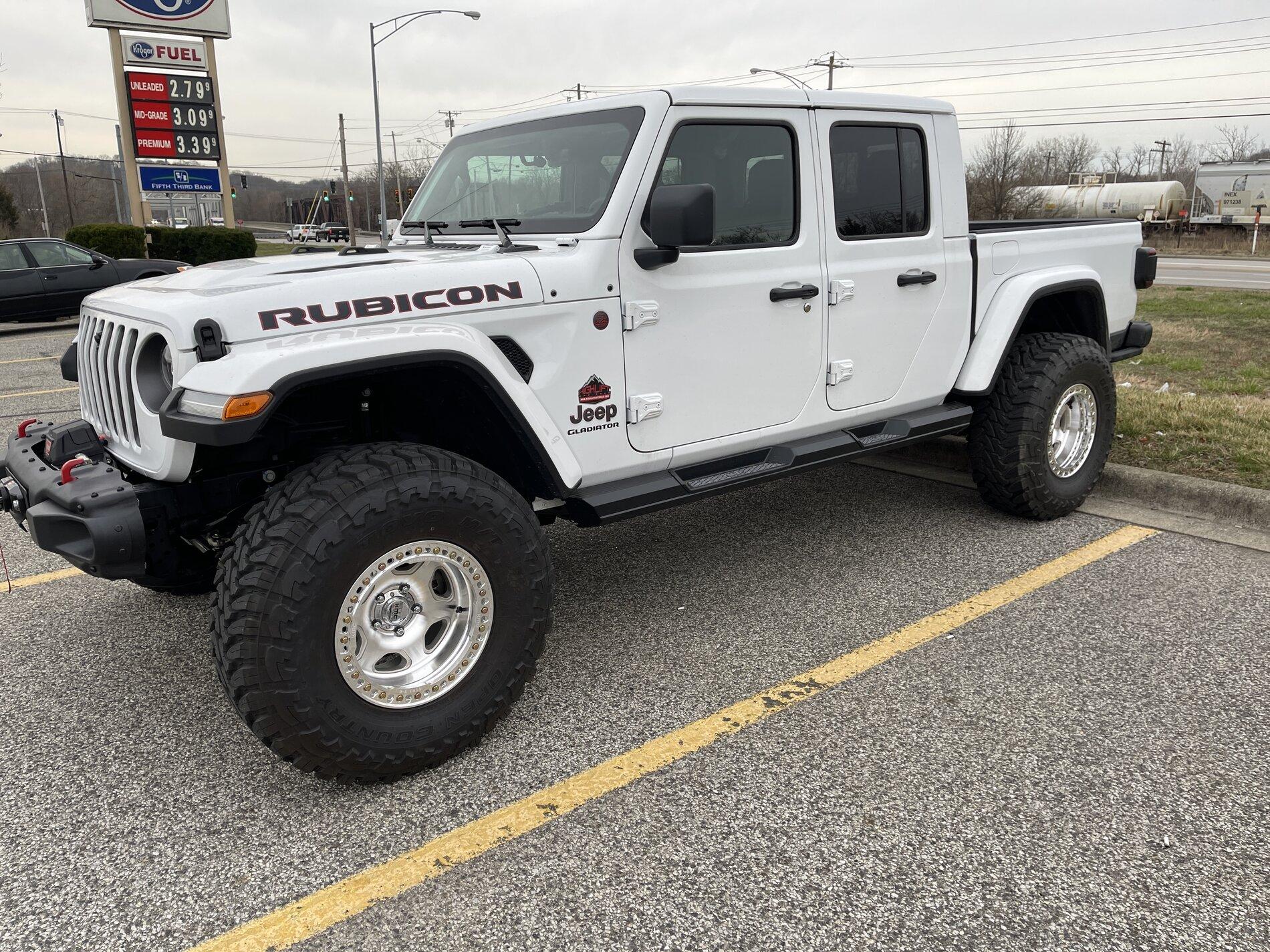

Is it possible to order rock krawler decals anywhere? Really loving the ProX kit on my gladiator.
Jeep Gladiator Rock Krawler 3" X Factor JT System 7BEB3085-EF0B-4736-A8F6-E033A7DD72AF
pixeldecals
Rock Sponsor (Level 1)
Apr 3, 2017
193
349
Chicago Area, IL
www.pixeldecals.com
Yes, we are authorized by RK to make all their graphics. Send me a message or email and Iā€™ll get you set up!
