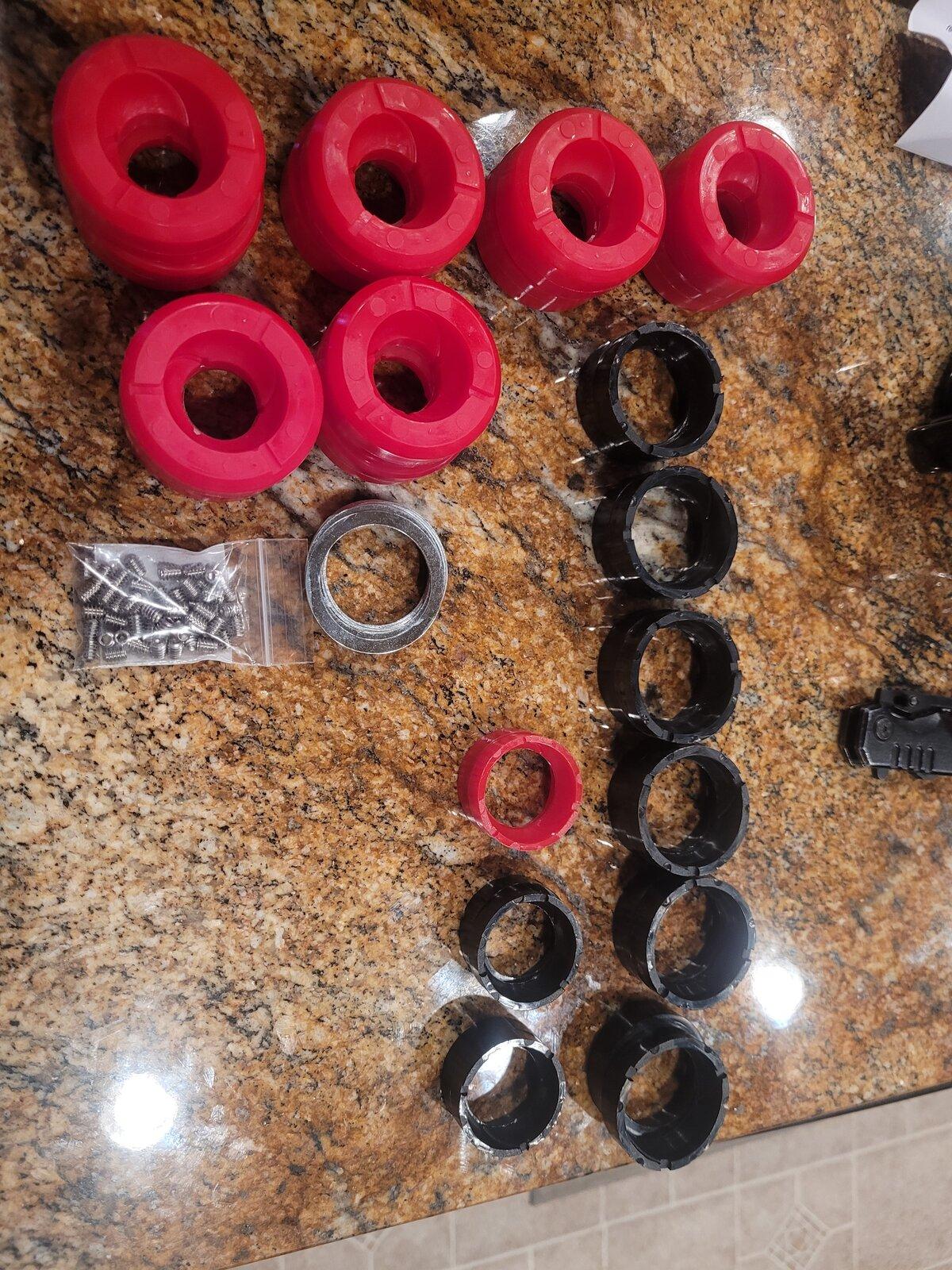

Pulled my rear arms and the same thing has happened. The original, factory bushing did this exact samething. When I pulled the arms off the balls were loose in the bushing, just like the originals. I installed the pictured set at 25ftlbs and they were well greased.
Jeep Gladiator Rock Krawler 3" X Factor JT System 736F1213-2E4D-4CD0-AB40-387EBD066636
As you can see the bushing gets soft and pushes into the grease raceway. I wish I had pics of the original factory ones because they were exactly the same.
I posted pics of my original pro flex bushings earlier in the thread and the red replacements are working fine.

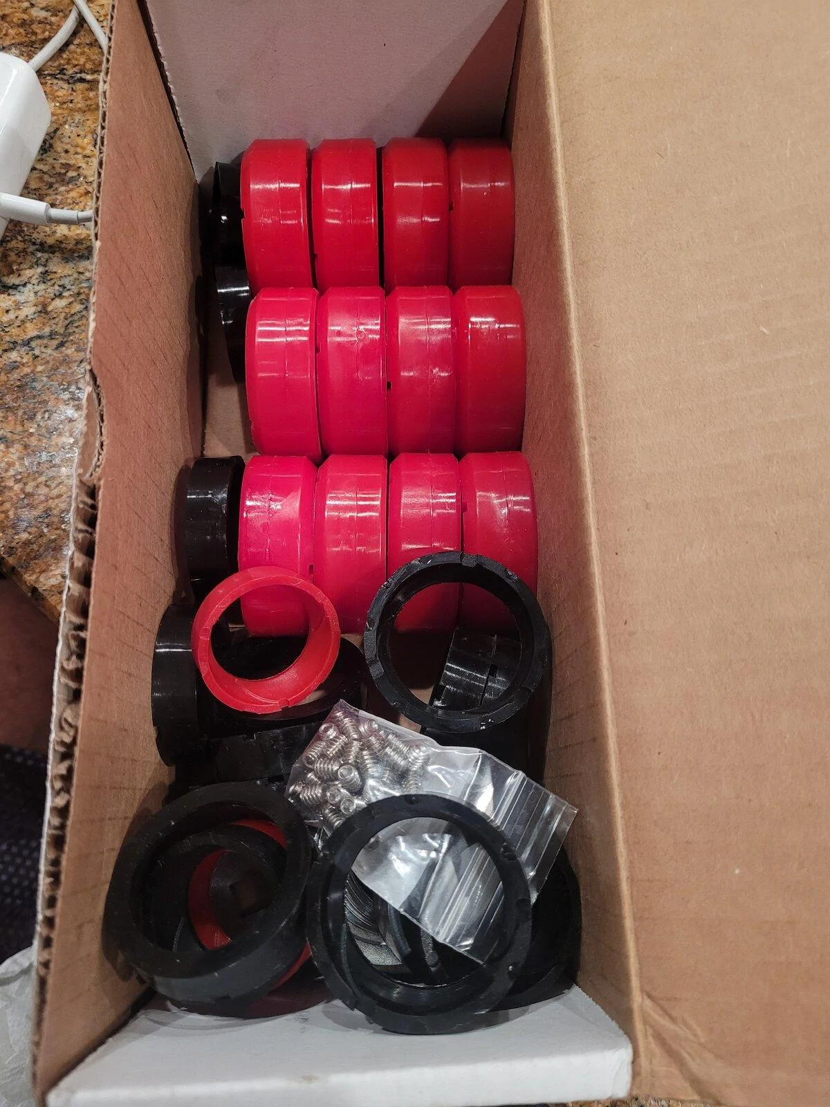

Received the replacement bushings yesterday, just opened the box this morning. It appears there are only 6 bushings in the box. I did not do the installation so maybe I'm missing something. !!!!
I will be calling Rock Krawler later today for clarification.
The 6 red bushings are frame end for the front lower, and rear frame end upper and lowers. The black bushing halves are everything else.
