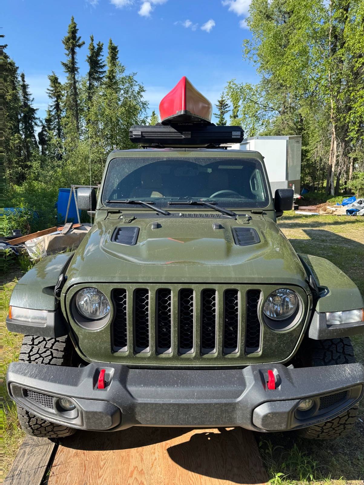

Canoe mounted on RTT load bars…
Jeep Gladiator "Roof load capacity" 421B3C97-7506-416D-AFD8-851823E2BC5F

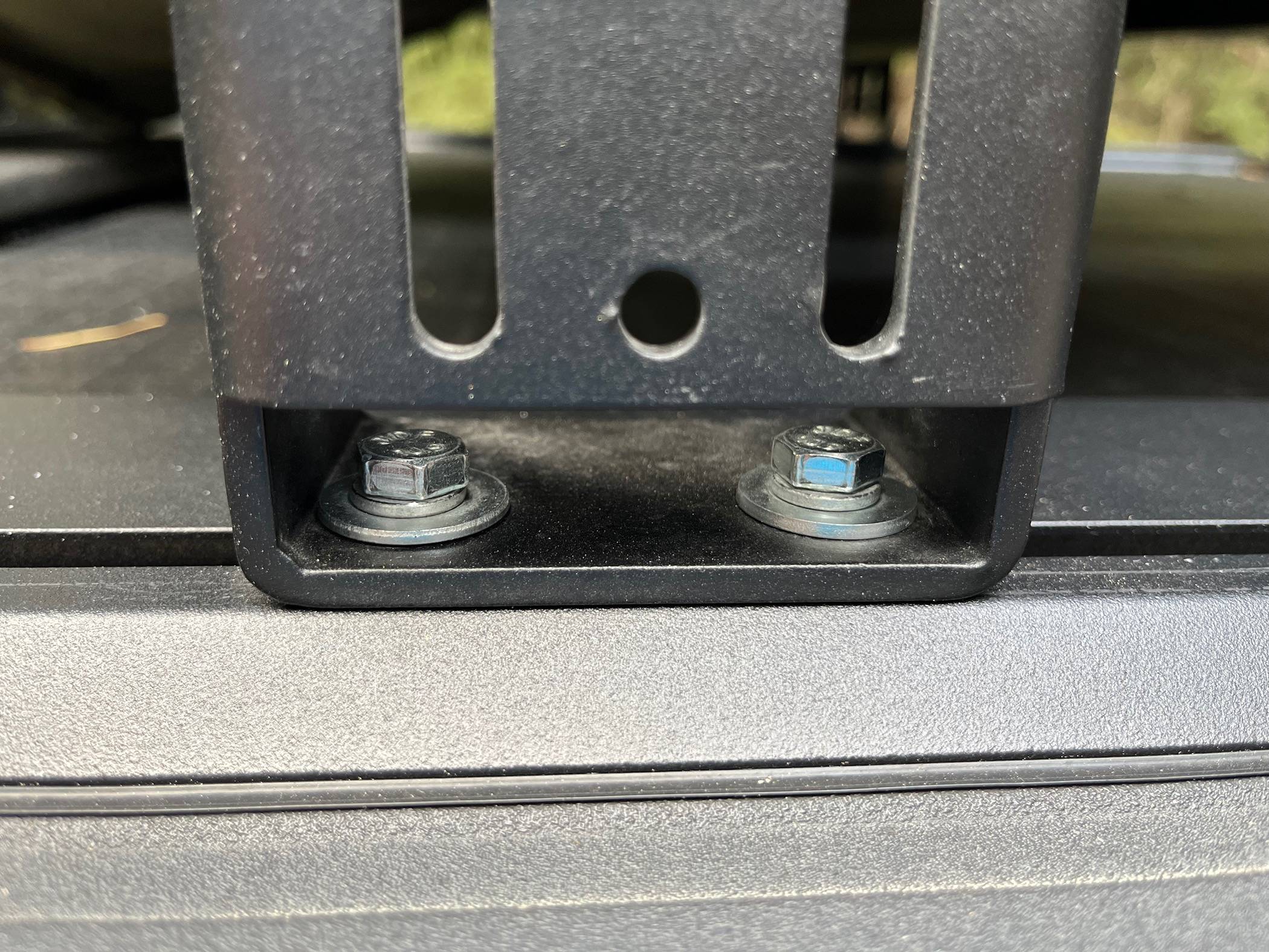

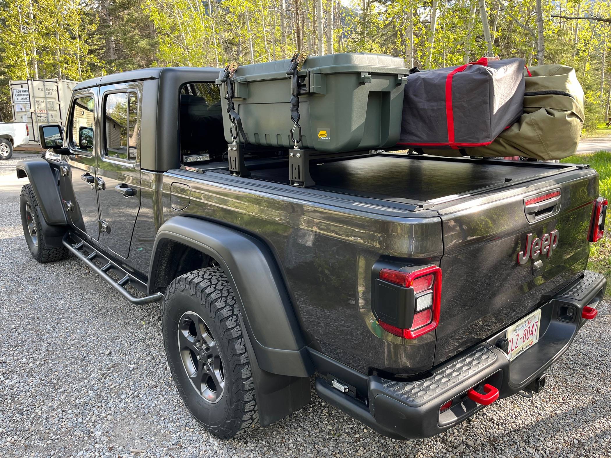

Does this company give you the option of swapping out the flat caps for T-groove caps? I have the Roll-N-Lock slide tonneau cover and changed out the flat caps for T-groove and then went with Billie Bars system.
Great stuff! Do you know what the weight capacity is of the t-slot rails? I'm sure the Billie Bars can handle the weight of a tent, but concerned about the weight capacity of the tonneau cover rails.
Thanks!
Thanks!
You’d have to contact Roll-N-Lock for a factory weight capacity for their T-slot caps but they tie into the trail rails inside the bed. I have not been concerned at all if they would handle the weight I’ve put on the Billie Bars and there’s been no distortion to the bed cap T-slot or to the trail rails. At the very most, I’ve had 200lbs T-slotted attached with no issues.
