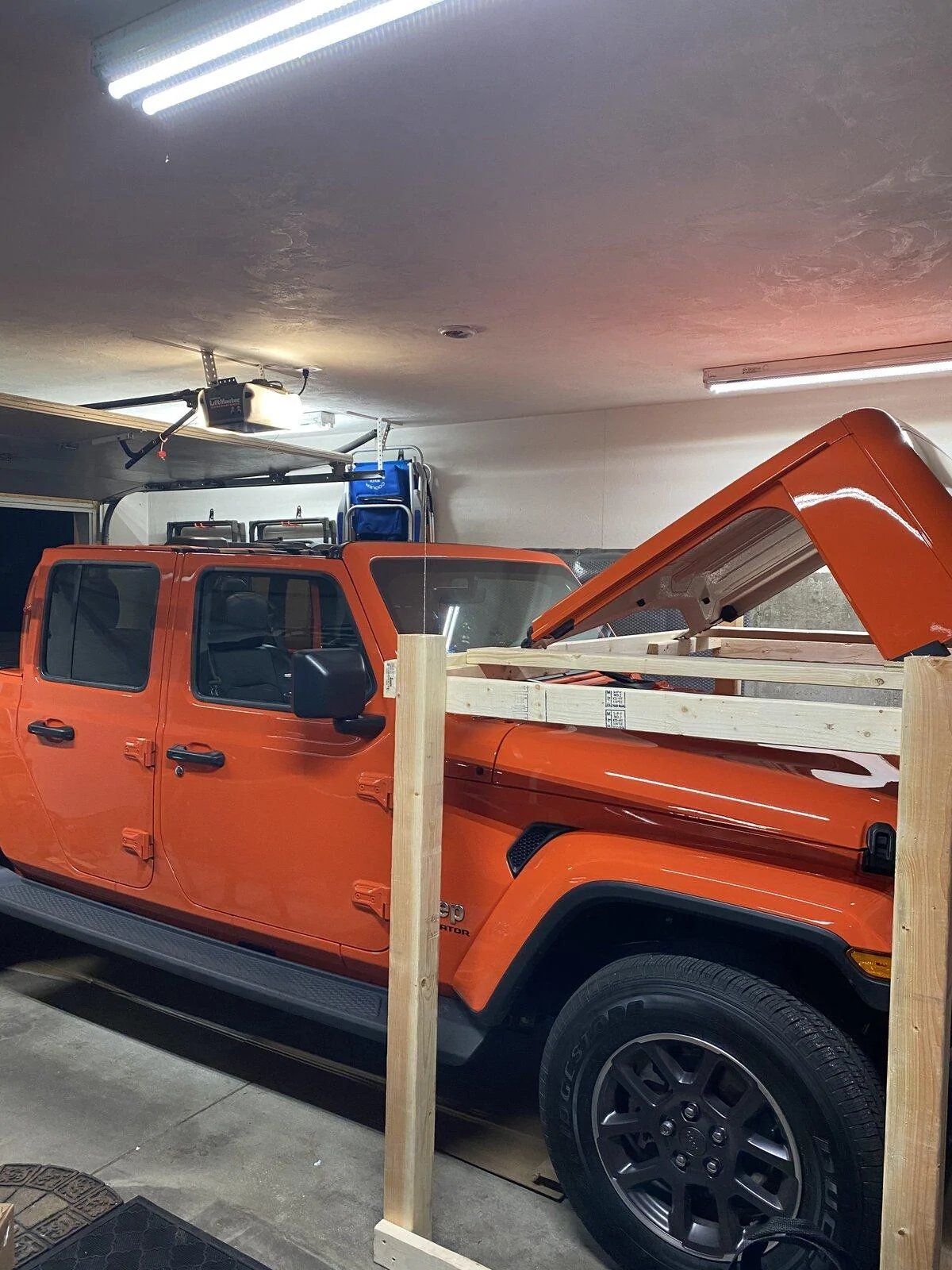

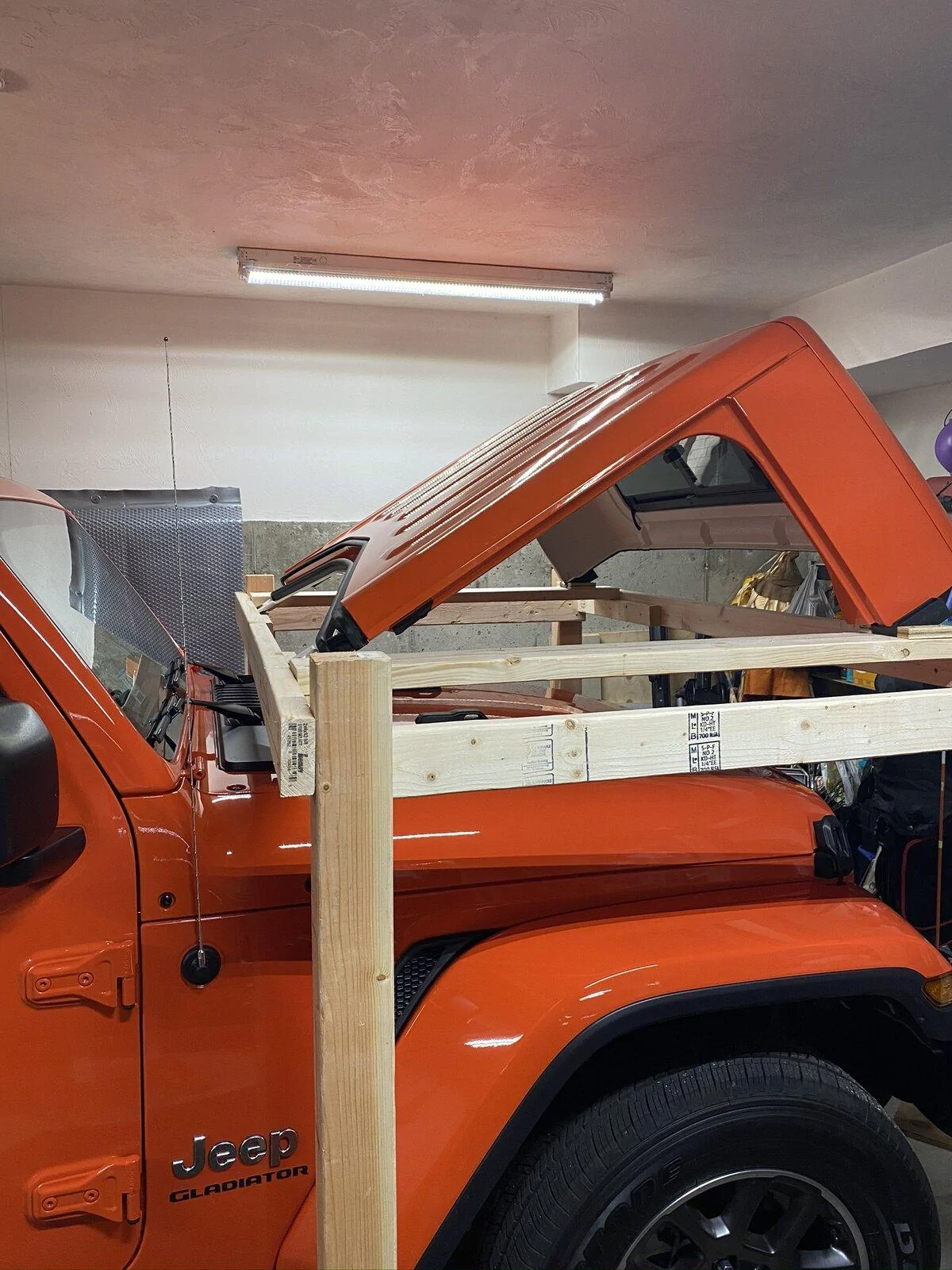

I’ve removed mine a number of times (26k miles) and no leaking issues. When reinstalling, you do have to make sure it is aligned and sits square. Tighten the bolts out of sequence (two center bolts, two top front bolts, far right, far left, etc. Also important to store it fully supported. I built a rack to store it on.
